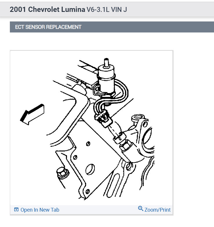

This is my daughter's car, and I am helping her change her ECT Sensor. That was the code it threw when she had it checked. Where exactly is it located at? And how do I get to it?

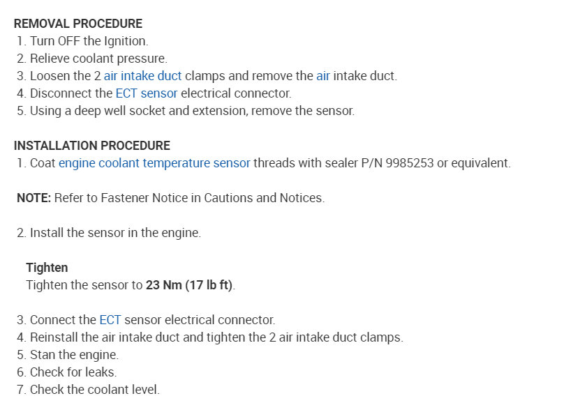

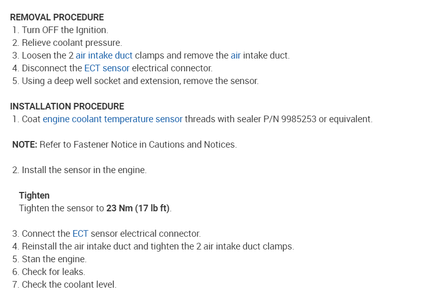

It looks like the coolant temperature sensor is near the front of the engine by the thermostat housing. here is a generic guide to help you change it out by showing you the steps and I have included the location and replacement instructions in the images below as well for your car.
https://www.2carpros.com/articles/coolant-temperature-sensor-cts-replacement
Start by draining the coolant. Check out the images (below). Please let us know if you need anything else to get the problem fixed.
