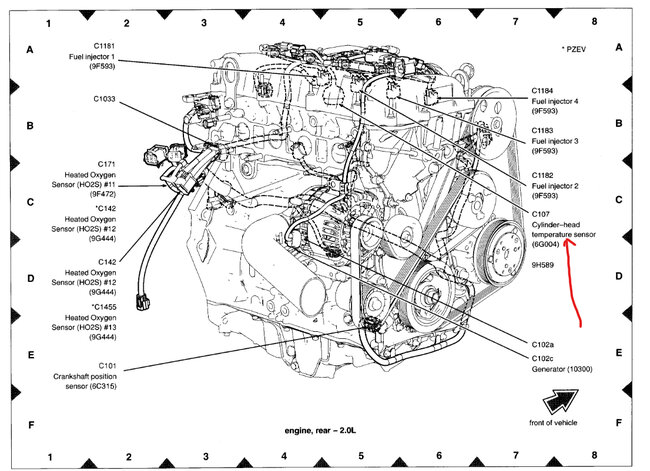

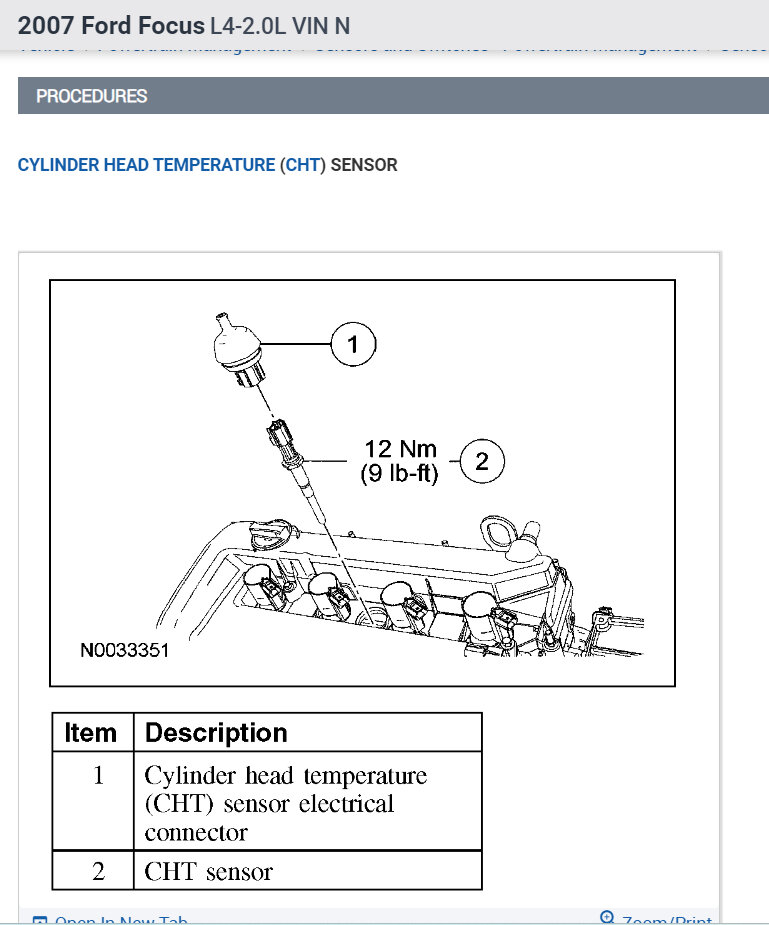

Sure, it looks like the coolant temperature sensor location is in the cylinder head near the spark plugs. Check out the images (below). Please let us know if you need anything else to get the problem fixed.
Aug 28, 2023 at 4:38 AM
ZENJOJO373
Thanks for the answer, but I'm looking for the ECT sensor engine cooling temperature, not at the CHT sensor cylinder head temperature.
My engine is a 1.8 tdci 115hp.
Thanks.

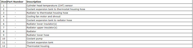

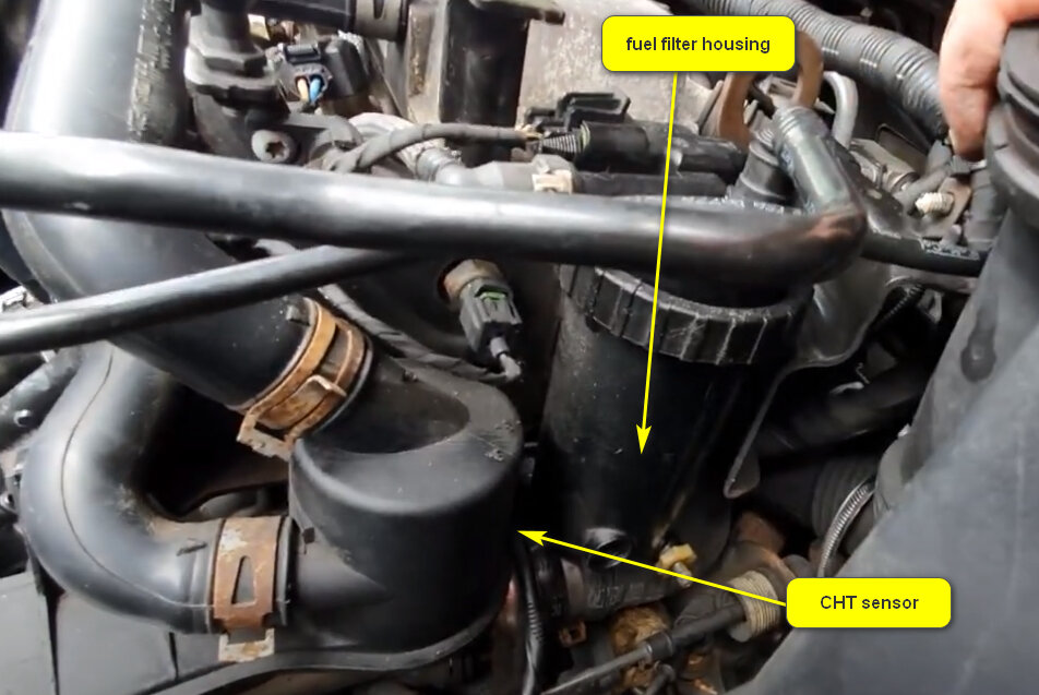

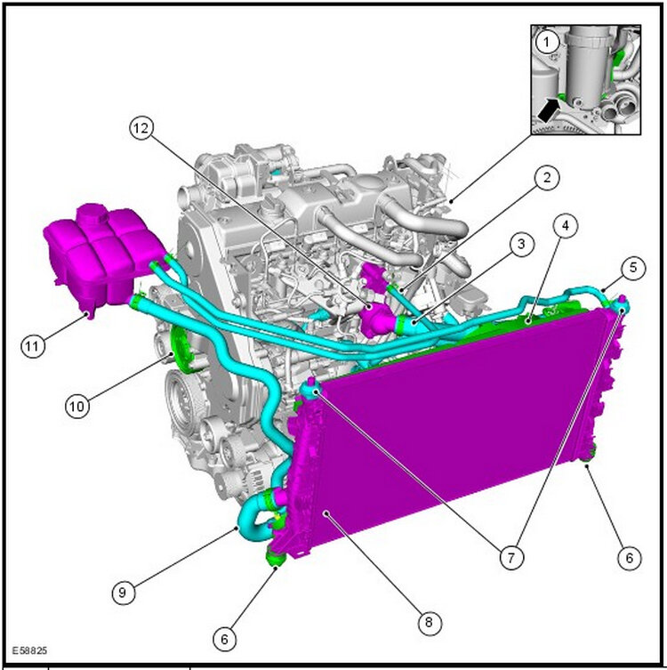

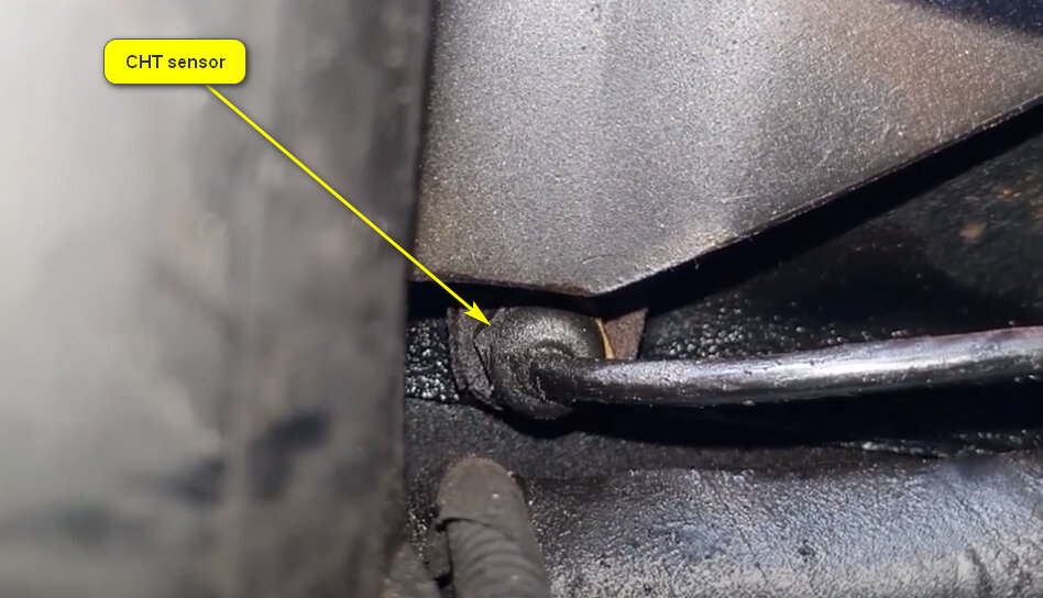

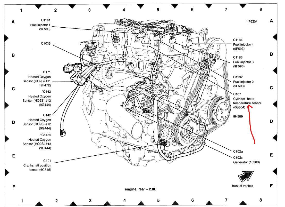

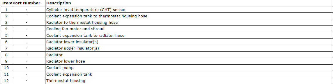

Hello, the engine fitted is the 1.8TDCi (Lynx) engine.
The coolant temperature sensor is located on the driver's side cylinder head, near the battery just below the fuel filter housing, see image 3+4.
This sensor is also called the CHT (cylinder head temperature) sensor.
CHT sensor is item 1 on first image.
See image 1+2 below.

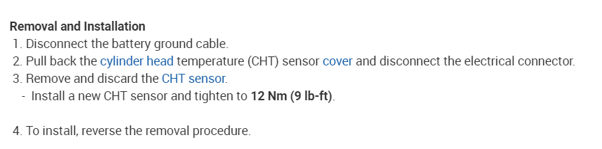

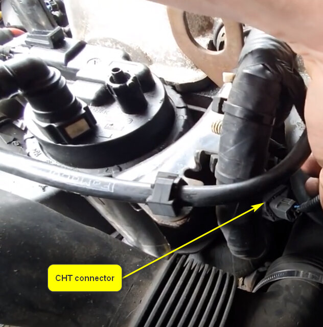

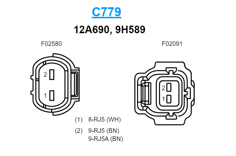

The sensor connector is to the right of the fuel filter housing.
See image 5+6.
