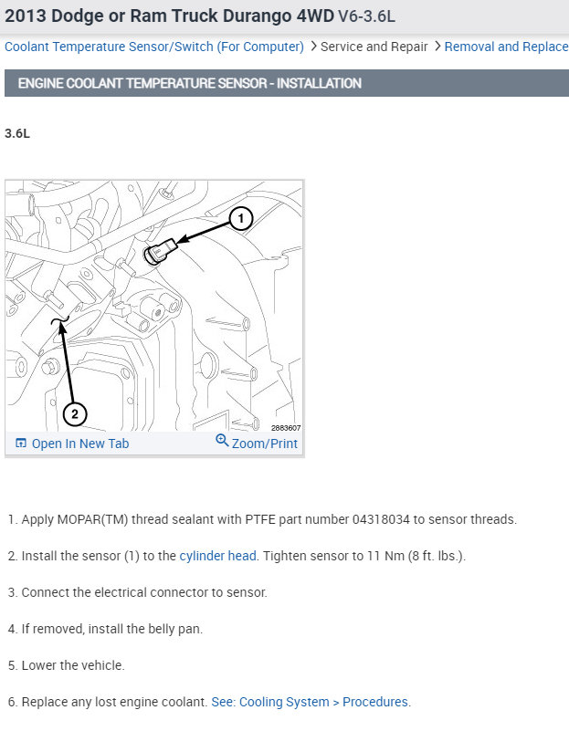

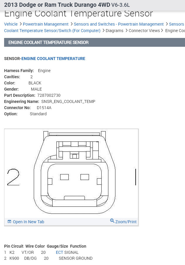

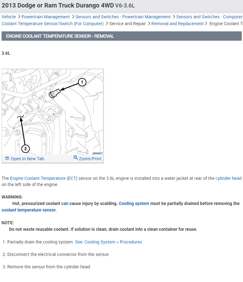

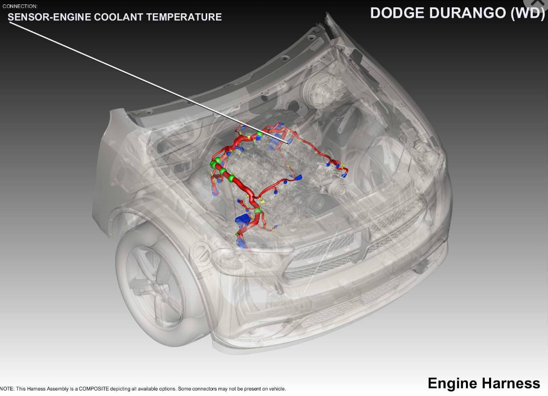

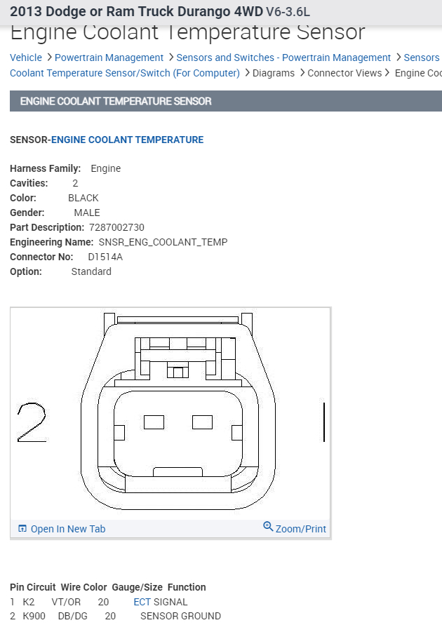

Trying to locate the coolant temperature sensor (ECT sensor).
Oct 19, 2021 at 6:45 AM
SQM
  • 6,383 POSTS
The coolant temperature sensor is located on the upper part of the engine. If you are facing the engine, it will on the right side. Towards the rear of the cylinder head.
https://www.2carpros.com/articles/coolant-temperature-sensor-cts-replacement
