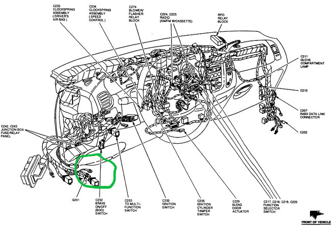

ECT reference voltage too high
224,786 MILES • 4.6L • V8 • 2WD • AUTOMATIC
JOHN RUCKER
The truck runs fine. my temperature gauge work until it reaches operation temperature then all gauges peck out.

The oil pressure sending unit, coolant temperature sensor, and gauges ground through ground G201 at the driver side lower dash behind the cowl panel. I would strongly suggest you check this first because I have had issues with rust forming behind this ground. It will be held on with an 8mm bolt. I've attached a picture of the location.
