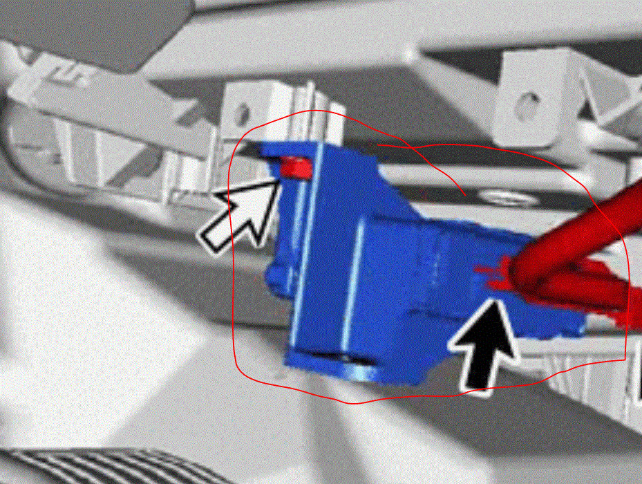

The eco mode quit working on my Corolla S Plus. I had to get a new battery, and as soon as I connected the new battery the Eco mode began working again. However, after about 2 days of driving it the Eco mode turned off again. I tried cleaning the battery terminals, I checked to make sure the Eco feature was on, on the dash. I unhooked the battery and then hooked it back up and the eco light is still off. Not sure what to do or where to go from here, I have found no help online.

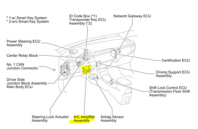

The eco mode is controlled by an AC amplifier. It is located under the dash on the driver's side. I attached pics below. Make sure the connection to it is in good condition. Also, let me know if the AC is working. If it isn't, check the heater IG fuse in the fuse box under the dash. It is a 10 amp fuse.
If the fuse is good, confirm there is power to and from it.
