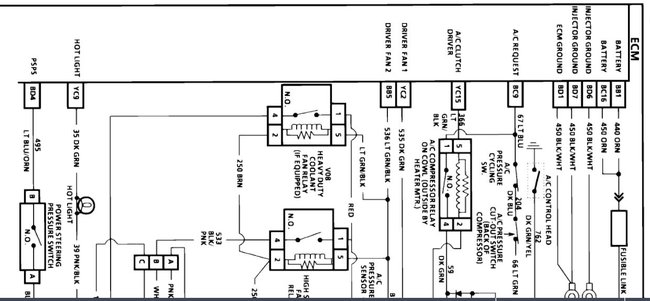

I'm looking for a wiring diagram of the three connectors related to the ECM. The former owner of my car has made some modifications on the pink and black lead and I would like to know what he has done?

Good morning,
I attached the wiring diagram of the ECM as you requested.
Let me know if you need any other help.

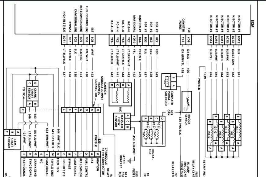

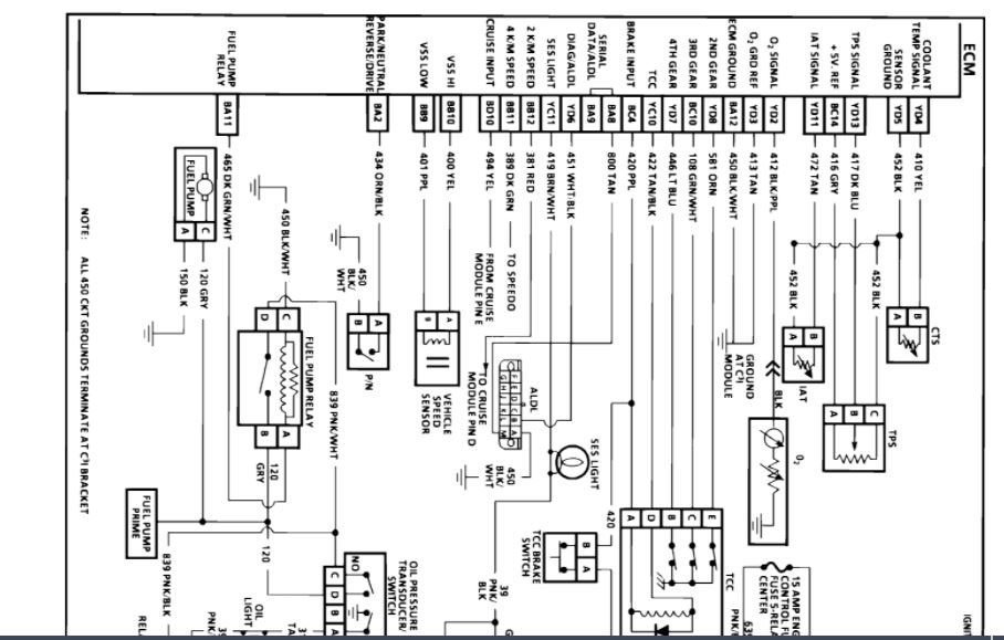

Yes, I did but same problem again with the message system.. So I did investigations but the wiring diagram does not match with my ECM... The faulty pink and black is number a2 on the black 24 pins connector... What did you think about that?

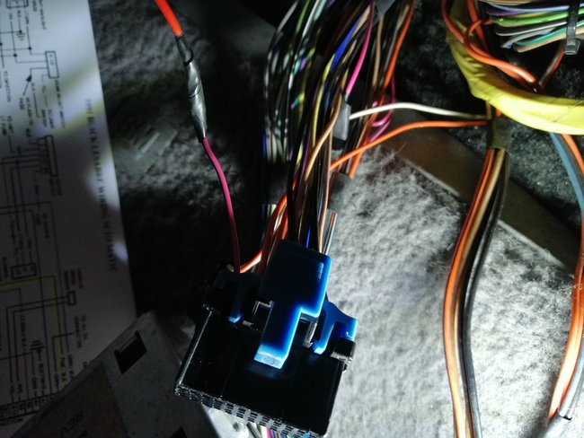

See the attachment....

Okay, in the diagrams I sent the pink/black is a power feed to the ECM.
Is that what this wires does?

I assume that what is important is the pin number and not the color, right? The diagram leads color does not match with my connector... On my ECM, the connectors are black and green not orange...
I have to do more investigations to really conclude about the function of this pink and black lead....

I did more investigations and found out that the wiring of my car corresponds to a model 1993!
Maybe because it was sold in Europe (I'm French).
In this case the pink and black lead must be from/to the MAF?

The strangest thing is that the red replacement lead goes to a harness like if it was from the manufacture.
Is it a spare lead in case of...?

I bought this car that has not run for a while. I had to remove the dashboard to fix the HVAC and I discovered that tricky modified pink and black lead... Somebody has cut and strapped it with a red lead that goes I don't know where yet... Before putting back the dashboard, I just wanted to be sure about the purpose of this red lead...
I think that I have everything to finish this investigation... I will give you feedback if you want.
