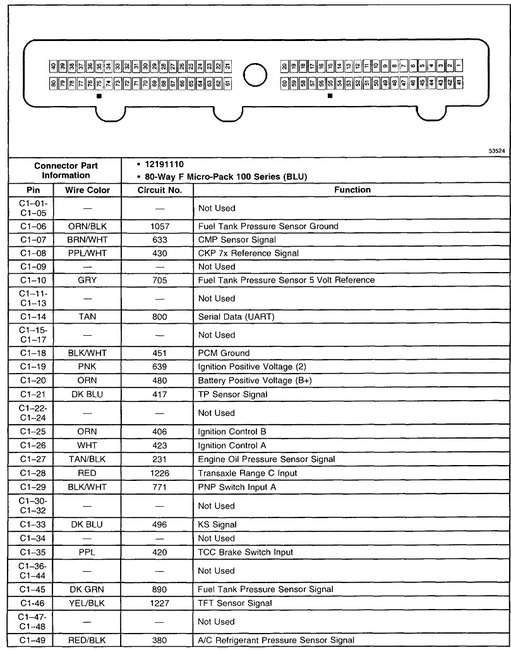

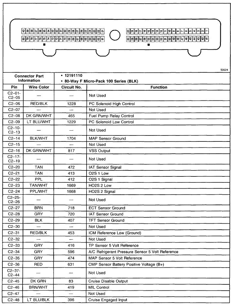

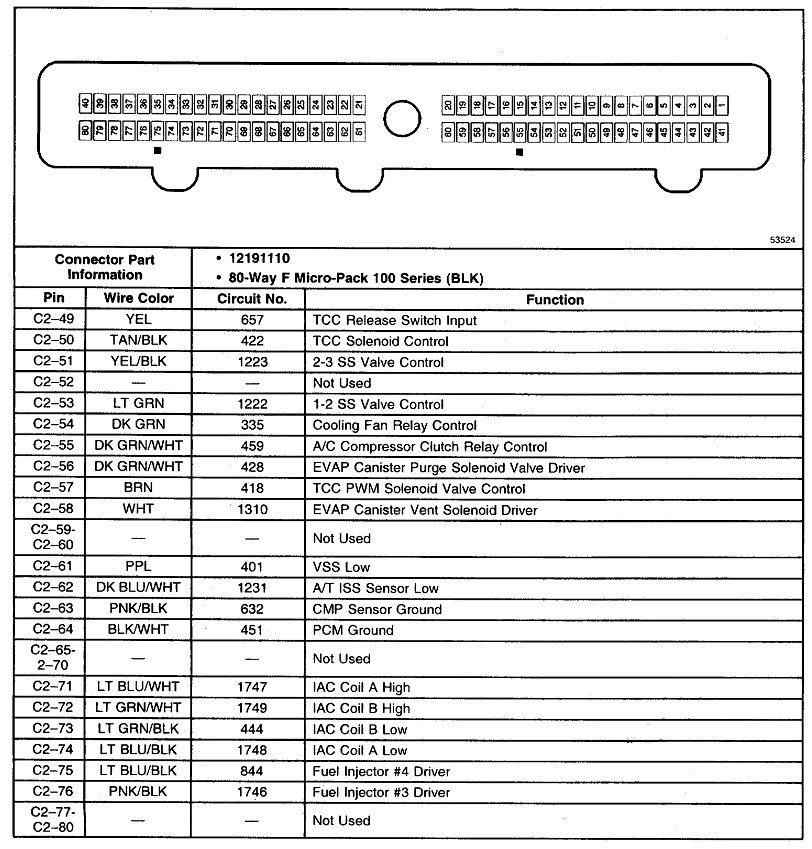

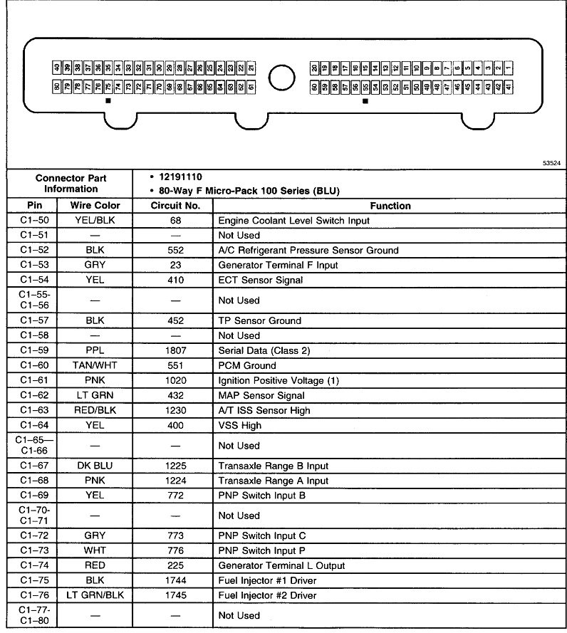

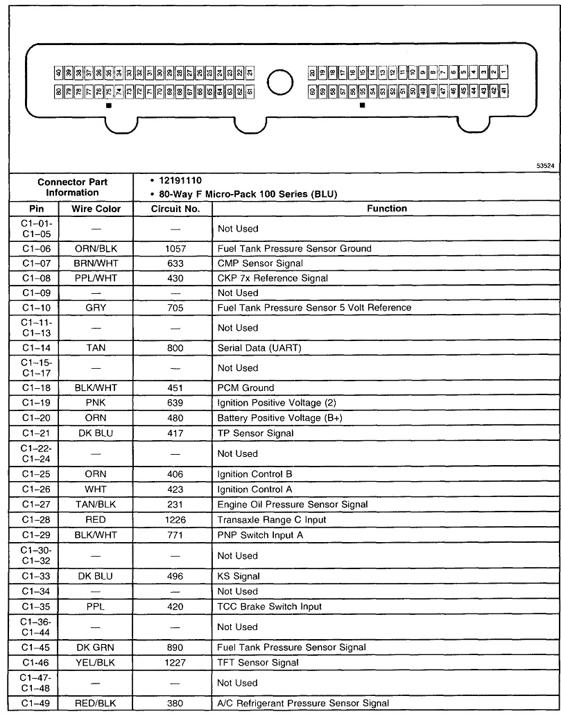

Someone cut the wires to ECM and stole the ECM. now i have to wire the new ECM.
