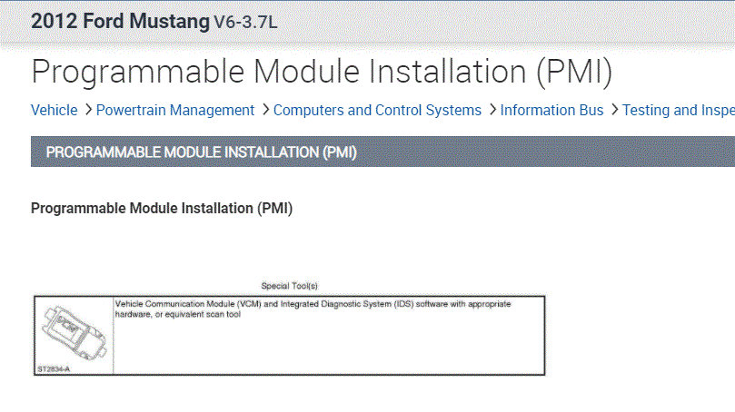

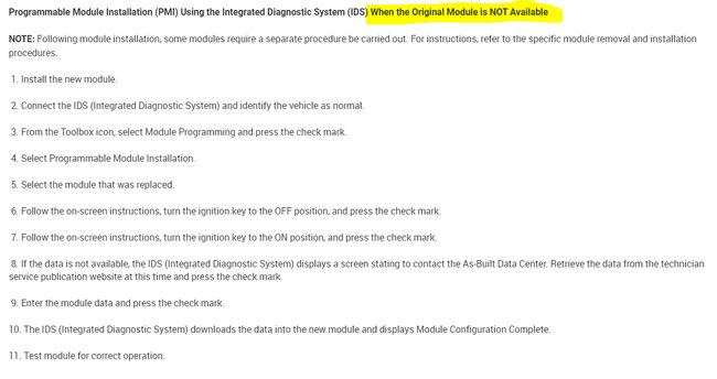

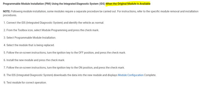

It sounds like either you have another bad module, or they didn't finish the job. When you replace this module, a new one needs to be reconfigured to match the vehicle's requirements.
The best and easiest thing to do is to download/copy information from the old module and then upload it to the new one.
In some cases, the old module is so far gone that it can't be done.
I've attached the directions for both procedures below (with the old module and without the old module) for your review. Note that both do require a scanner that is capable of communicating with the module.
