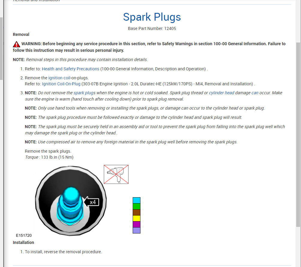

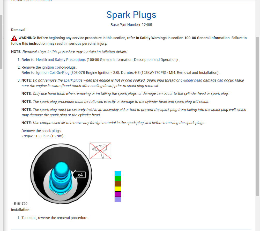

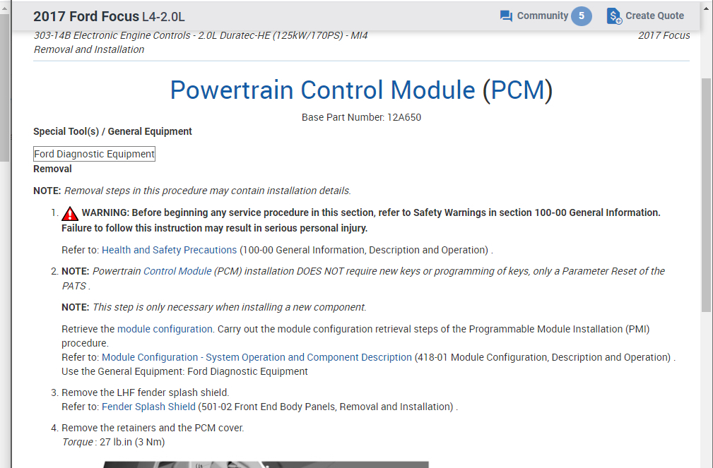

I am attaching the info below on the PCM and spark plugs. I assume by plugs; you mean spark plugs.
https://www.2carpros.com/articles/how-to-tune-up-a-car-engine

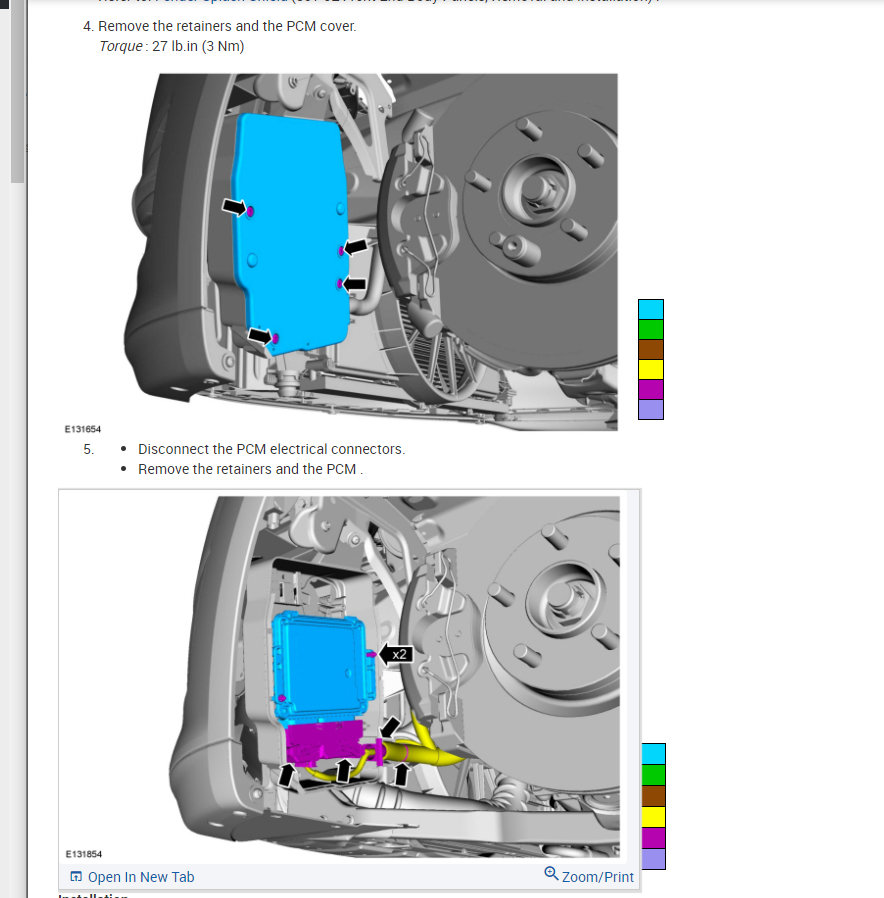

If you mean the connectors that are on the PCM then they just lift the lock and will come off pretty easily.
Please see all the info below on this and let us know if you have other questions. Thanks

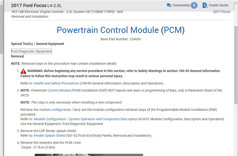

I was mistaken my daughter's car is a 2012 Focus. I found ECM and the plugs were impossible to remove
.I finally remove to old ECM and a dealer installed the new one. When i turn the nothing happens. Can i program the key to the computer myself or can i take the key to a dealer with the ECM number?
Oct 1, 2021 at 3:12 PM

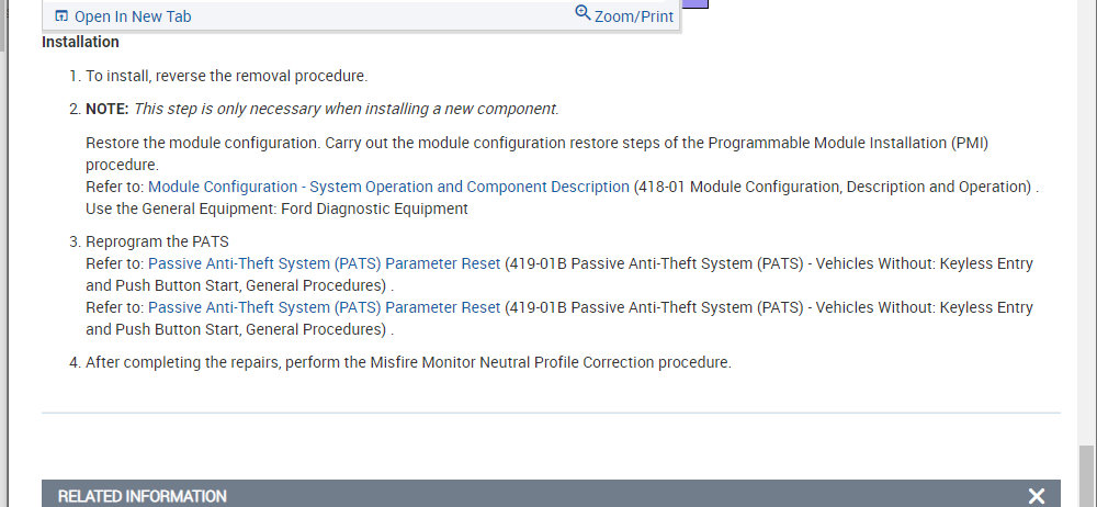

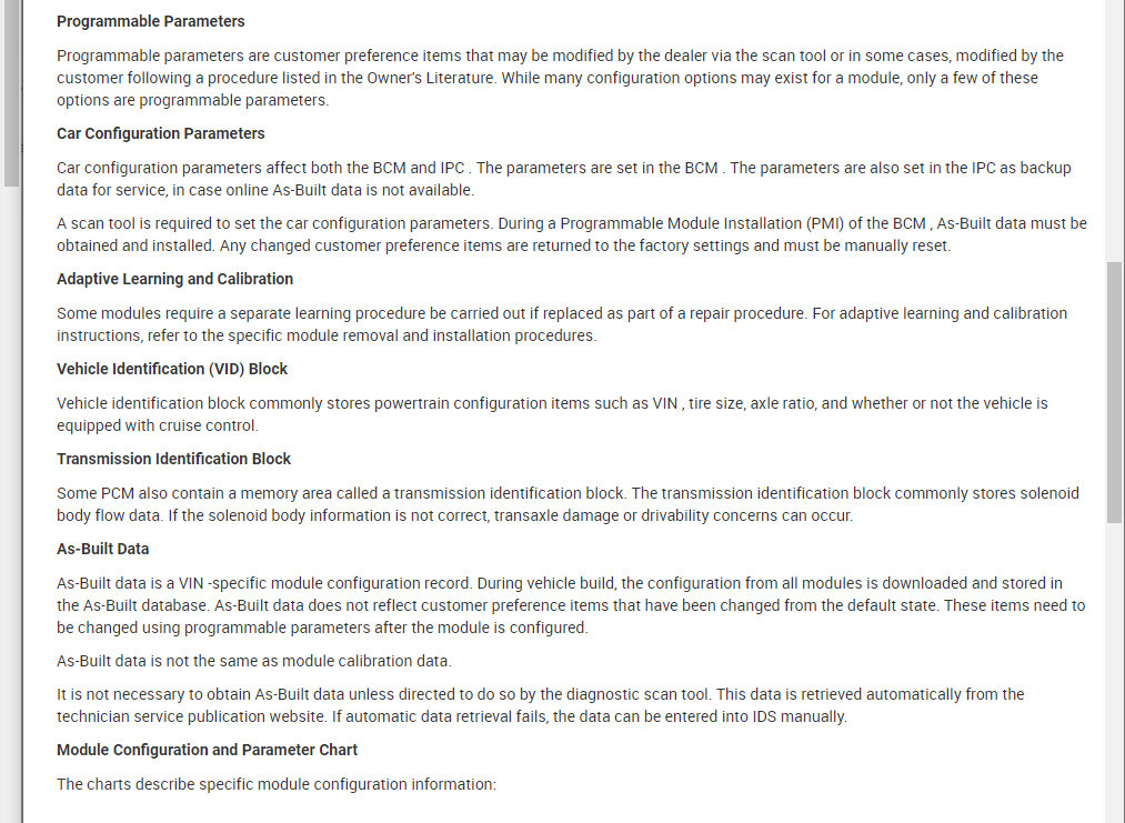

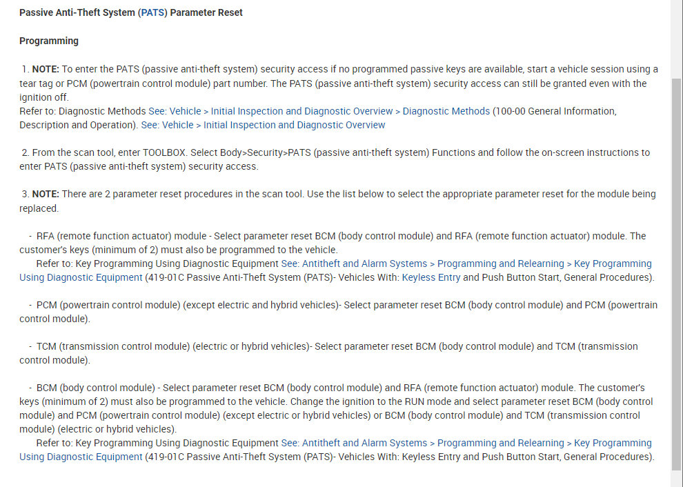

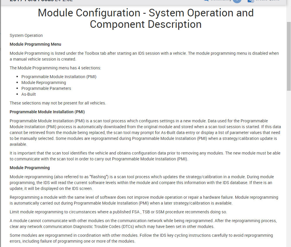

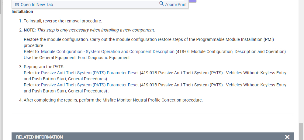

Okay. On this vehicle that is not going to make a difference as it was pretty much unchanged in this respect from 2012 to 2017.
So, to program the keys you will need to have this done using a scan tool that is capable of doing it. It does not have to be a dealer but clearly, they can perform it easily.
They will not need the PCM number to do this. They will be able to just hook their tool up and run through the process and have them programmed. See below for the details.

I would go with something from Autel. They are the most common brand and most all shops use them. They are cheaper than Snap on tools which are in the thousands of dollars.
I know for a fact that this one specifically will program most any key out there. However, it is not that cheap either as I think they are over $1,000.00.
Autel MaxiSys MS906BT
Again, you can buy one of those key programmers for around $200.00 but they only do key programming, and I am sure you can have the vehicle towed to a local shop and 2 keys programmed cheaper then that. You have to pay for the keys no matter what so having a tow for $50.00 and they charge $100.00 to $150.00 to program keys, you are in it about the same amount.
As for performing the programming, it is not hard. You just have to follow the steps on the scan tool. The tool will tell you the steps as you use it.
