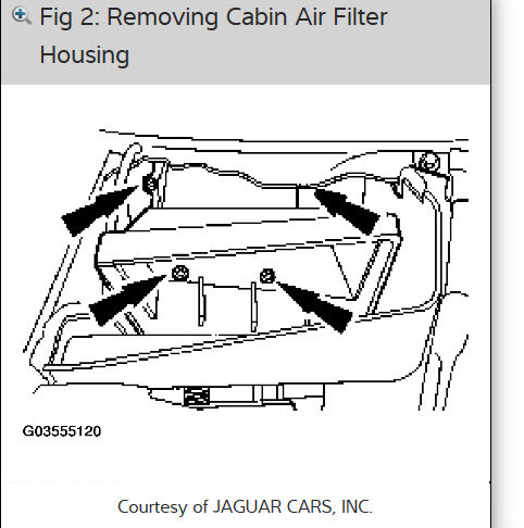

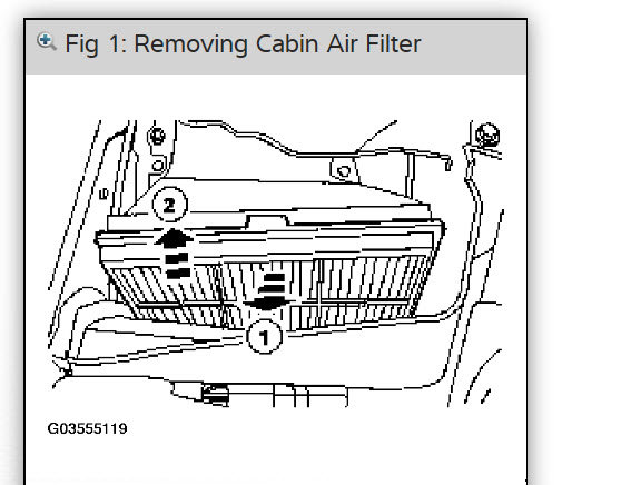

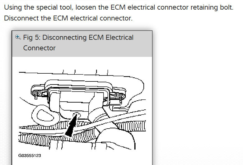

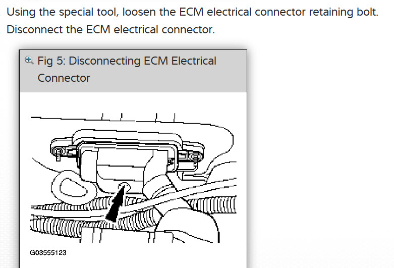

how do I remove my ECM? I have removed the glove compartment and have access to it. Do I need to remove the air filter/holder on the left side of the engine compartment (looking rearward) to get to any plug bracket etc?
Apr 27, 2017 at 3:03 AM
HMAC300
  • 48,601 POSTS

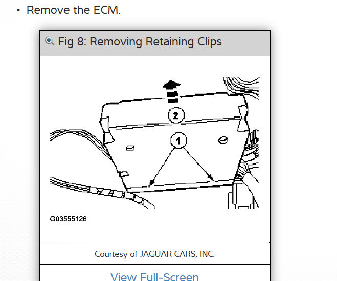

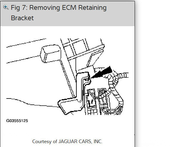

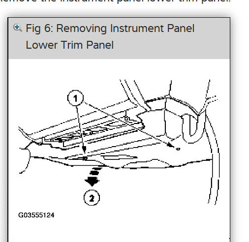

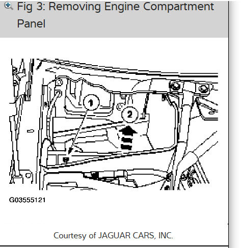

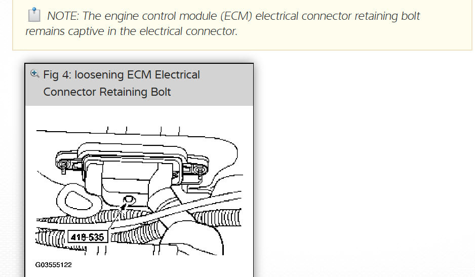

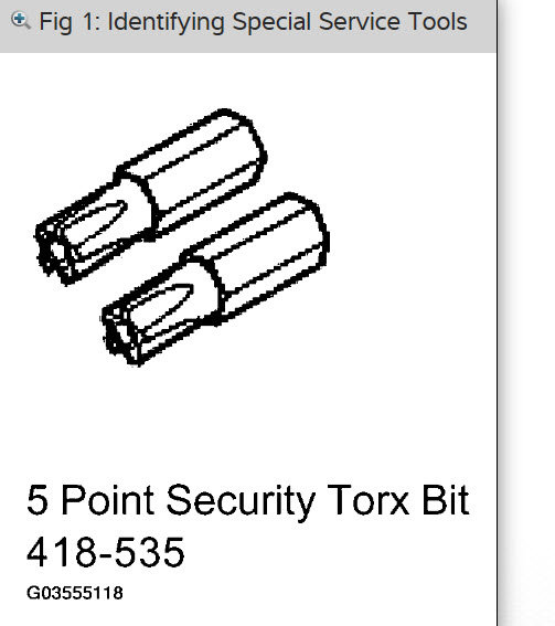

ECM will need to be programmed to your car for security system by a mechanic no matter what an auto parts store tells you. disconnect battery and follow pictures there is a special tool required. See pictures. you also need to remove cowl screen in front of windshield.
