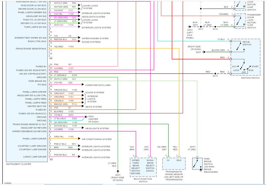

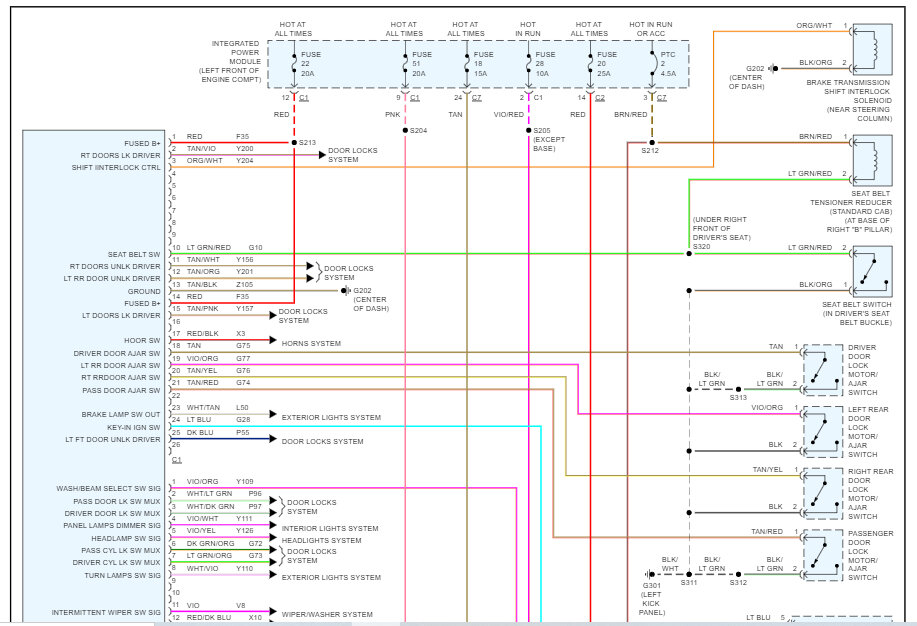

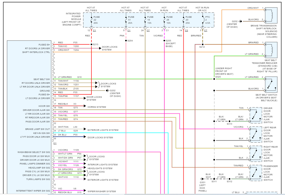

No, I don't feel that would happen. I attached the wiring schematic below for the entire instrument cluster. Power is provided to the cluster and then primarily, switches control how it functions.
What is happening? Let me know in detail what you have experienced.
Also, I need to know if this is a Dakota or full-size truck. Both had the 4.7L as an option. The wiring schematic I attached is for a full size 1500 2wd.
See pics. I had to cut one page in two to make it readable. I did overlap them so you can follow from one to the next.

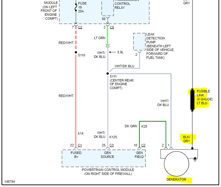

Hi, pulled fuse and gauges came back but now I have another problem. It is a full-size truck, and the check engine light is on now but not charging. changed the ECM as I thought it was there but check engine light is on. checked for codes but nothing shows. truck will run until it kills battery. Now I do not know what is wrong.
Nov 18, 2022 at 2:53 PM
  • 110,194 POSTS

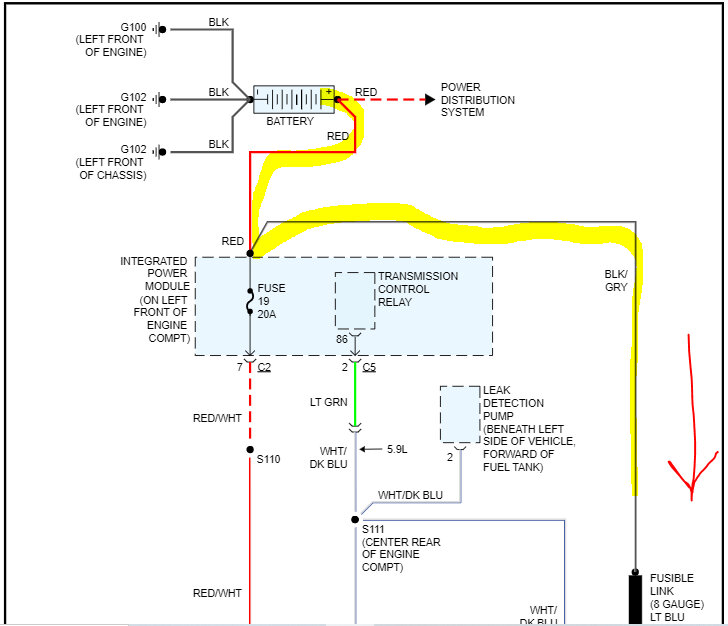

If it isn't charging, in most cases it is either the alternator or the ECM. Is the ECM new that you installed? Have you had the alternator bench tested?
Let me know. Also, if the ECM was used, it may be the issue. Also, there is a fusible link between the alternator and battery that may have failed. It will be a black wire with a gray tracer. Locate it at the alternator and confirm it has B+ voltage. If it doesn't, the alternator will not work.
If the fusible link is good and you are certain the ECM is good, then I would recommend removing the alternator and having it bench-tested at a parts store. They will do it free of charge.
I attached the wiring schematic below for the charging system, so you have it as a reference. It was one page long, but I had to cut it in half to make it readable.
Let me know what you find.

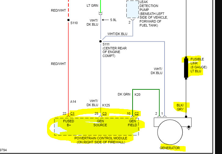

The PCM/ECM is on the right side of the firewall, and it will have at least 3 connectors. Looking at the schematic I attached above, pic 2 shows the PCM. Notice the pins are numbered starting with the letter C. The C identifies the connector number the wire goes to.
Let me know if that helps.

I hope that takes care of things. Let me know. Also, the schematic is above in an earlier post, but I reattached it below.
Let me know how things turn out for you.
See pic below.

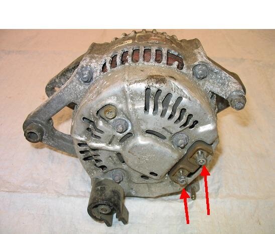

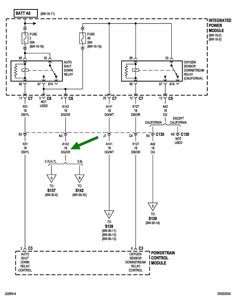

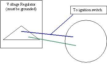

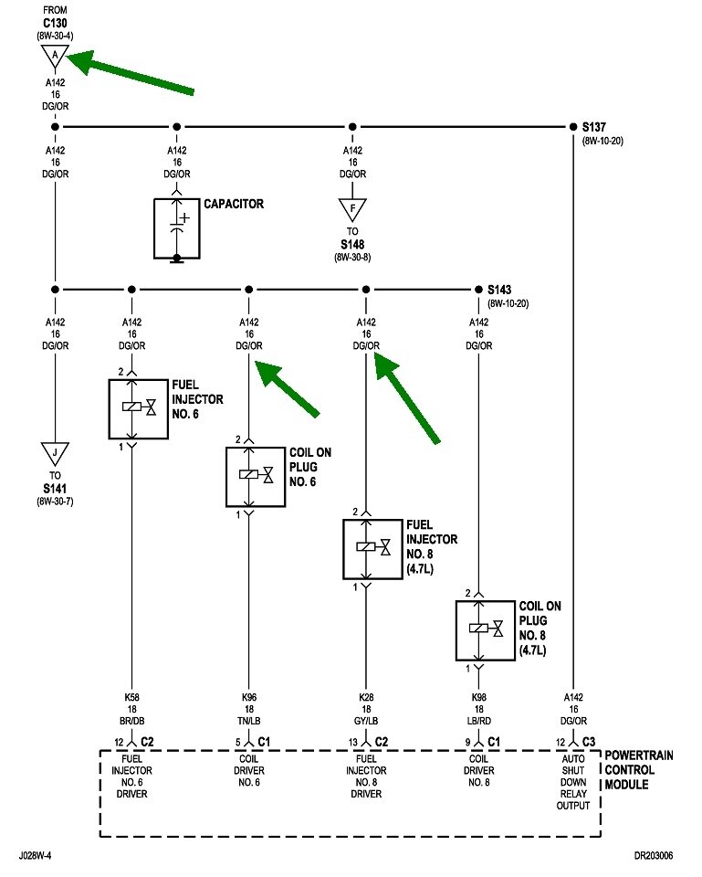

If you want to pursue this for a temporary fix, use the simple diagram below. You will likely have a little silver Nippendenso alternator as shown in the first photo. There's two small terminals on the rear. They're interchangeable. My sad drawing shows the three-terminal plug that has just two wires in it, a dark blue one and a dark green one, for the regulator. Those two wires go to the two terminals on the back of the alternator. Then, the dark blue wire gets tied to anything under the hood that gets 12 volts switched on. On the older models, everything dark blue under the hood got 12 volts switched onto it through the ignition switch when it was turned to "run". On newer models like your truck, the field current is switched on through the automatic shutdown, (ASD) relay. You can get that 12 volts from the positive terminal on one of the ignition coil, or the 12-volt feed wire at any of the injectors. The third diagram shows the ASD relay switching 12 volts onto the dark green / orange wire at all of those places. That's the most often used color now instead of dark blue. The fourth diagram shows the same wire / circuit at two of the ignition coils and two of the injectors. All six of the others are exactly the same, so you can use that wire at any of them.
I don't consider this a proper repair or anything other than a temporary fix, but it can get you back on the road again. These regulators were very inexpensive, as in usually under $20.00. They also have a third terminal that must be used. That is the metal housing bolted to the body sheet metal for the ground. Be sure paint and rust don't interfere with that connection.
(In the second drawing, top right, where it says, "to ignition switch", for your truck it should say, "to ASD relay circuit", or "to dark green / orange wire).
