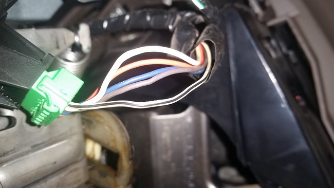

EDGAR ARMENTA
  • 27 POSTS
Already checked that.
When the computer is damaged, should the car still try starting?
And in the ignition switch, there is 5 cables, an orange (always has power) a blue cable and a grey one (get power when the key is open) a white one and a white/black cable (don't have any power, or ground to them, at any key position they don't get power, off, acc, I, or in the ignition. Could this be a problem to the car not starting?

EDGAR ARMENTA
  • 27 POSTS
Here's a picture of the cables.

SATURNTECH9
  • 30,869 POSTS
Here's the problem the starting system goes thru computer's even to operate the starter.Do you have a scan tool that can read like the engine and body control module codes?I know you can't talk to the ecm and we don't know about if you can talk to the bcm?if the ecm isn't getting power it won't start regardless.If your getting power into the underhood fuse box itself and your not getting power to some of the fuses.Then your gonna have to starting looking at the wires going into the underhood fuse box.

LEWISFERGUSON1
  • 0 POST
My dad did the same thing to my Ion.. it wound up being a bad wire to the ignition switch..
