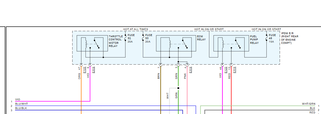

My truck has lost ability to rush. Have no communication to ALDL connector, no check engine light. Will crank over, no security light. Drive select indicator comes on for about 1 second showing 4 wheel drive, then goes off. When moving 4 wheel drive switch can hear transfer case motor running. Testing has determined most or all 5 volt supply voltages gone. I'm at the point I need to check power and ground inputs to ECM. Difficult process. Is there a trick to removing plastic cover from ECM connectors so I can check for power and grounds at ECM?

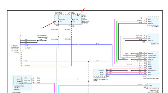

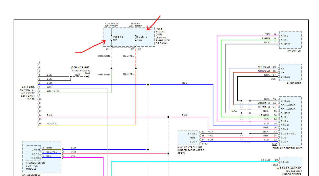

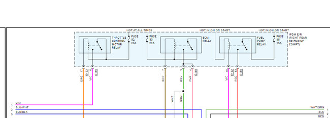

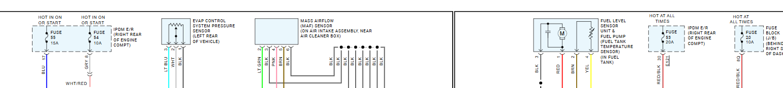

Here are the fuses I would check and there locations. Also, check the main engine wiring harness grounds to the engine. Also, try swapping out he main PCM power relay. Let me know how it goes.
