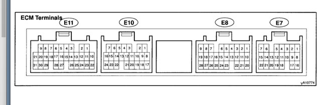

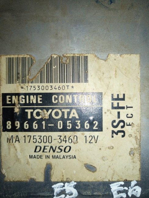

I know that there are lots of 3S-FE ECT engine control units but need the pinout for this particular one: 89661-05362 with 3S-FE ECT.
Thanks in advance.
Feb 12, 2022 at 3:51 AM

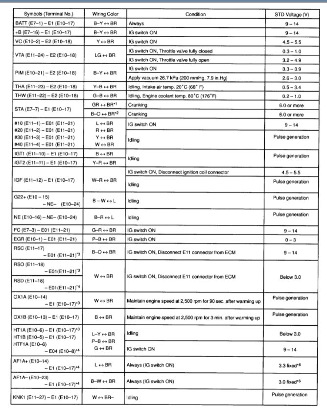

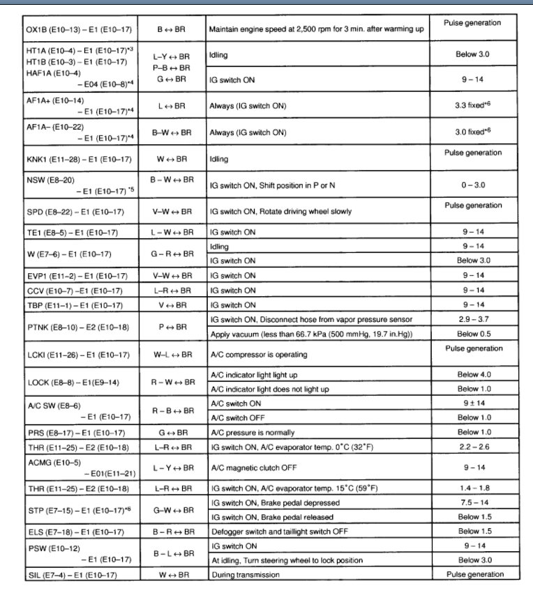

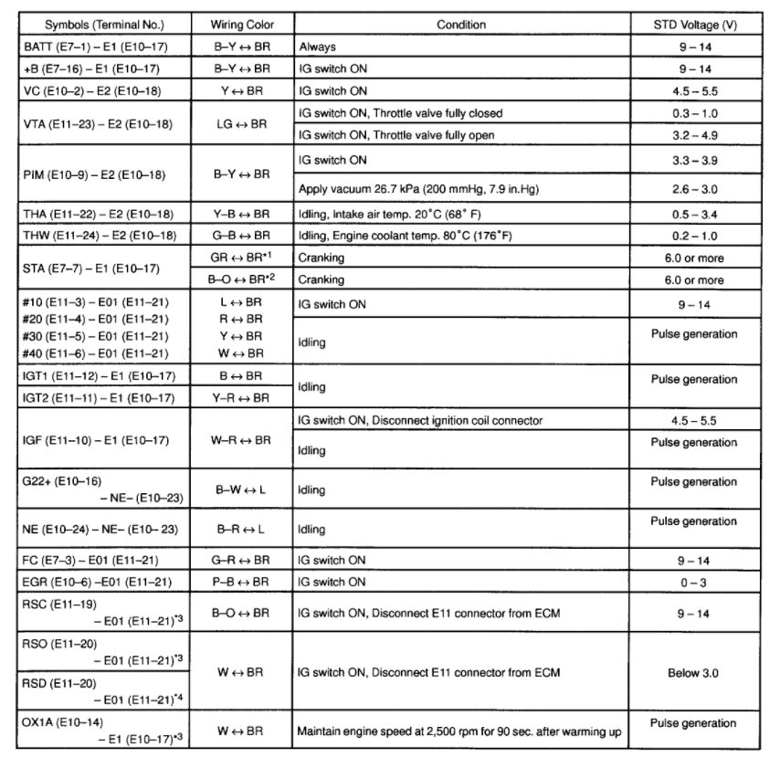

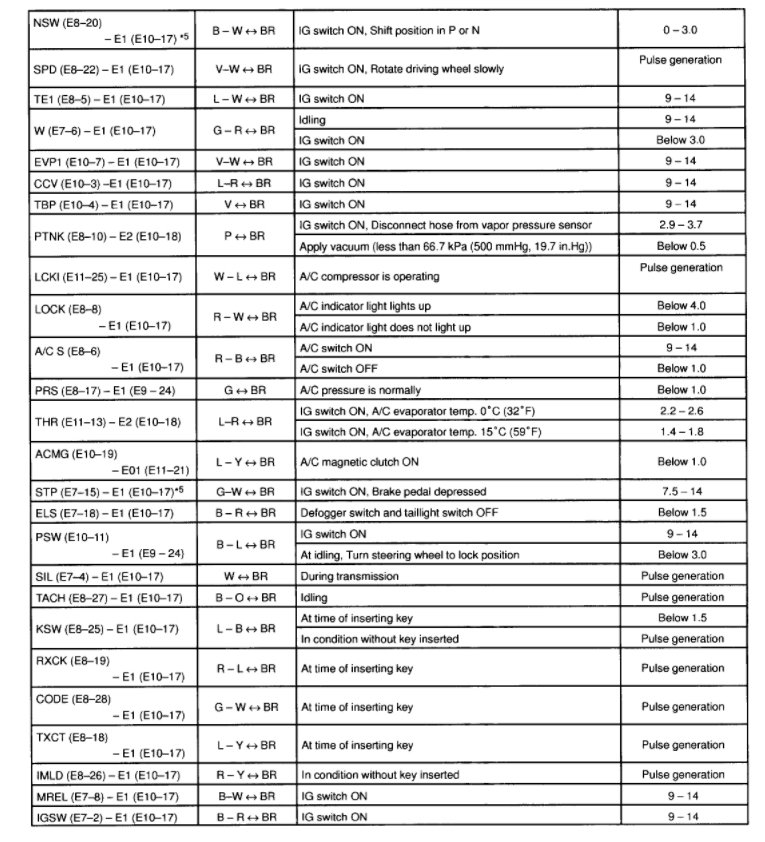

Unfortunately, we don't have a manual on this ECM. Basically, it was not offered here in the USA so the closest we have is the 5S-FE which is going to be slightly different.
However, if you need it this info will help with testing the wiring:
https://www.2carpros.com/articles/how-a-car-computer-works-pcm-ecm-bcm
I attached the info below so I understand this is not exactly what you are looking for so I am sorry if it doesn't help but it may be useful to others in the future that have this engine.
