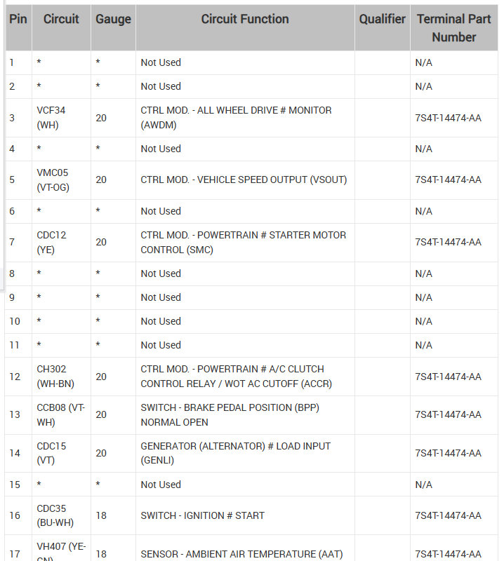

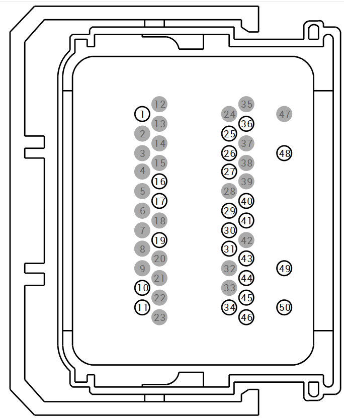

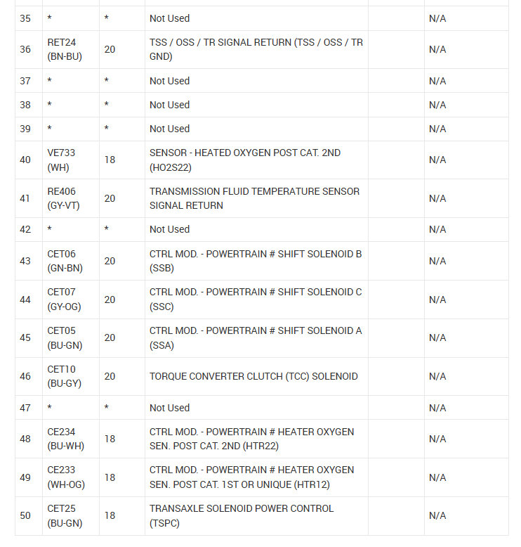

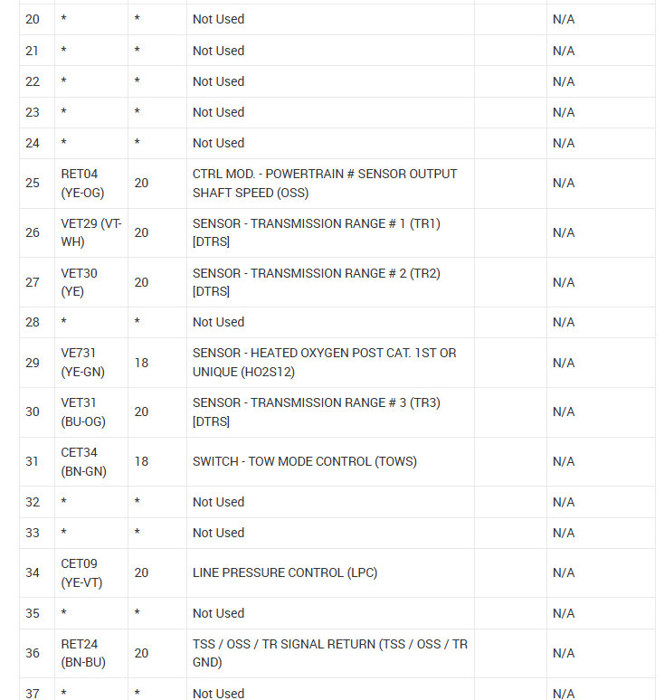

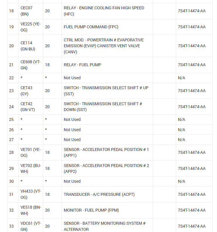

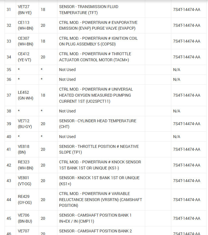

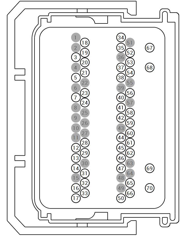

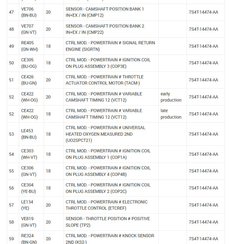

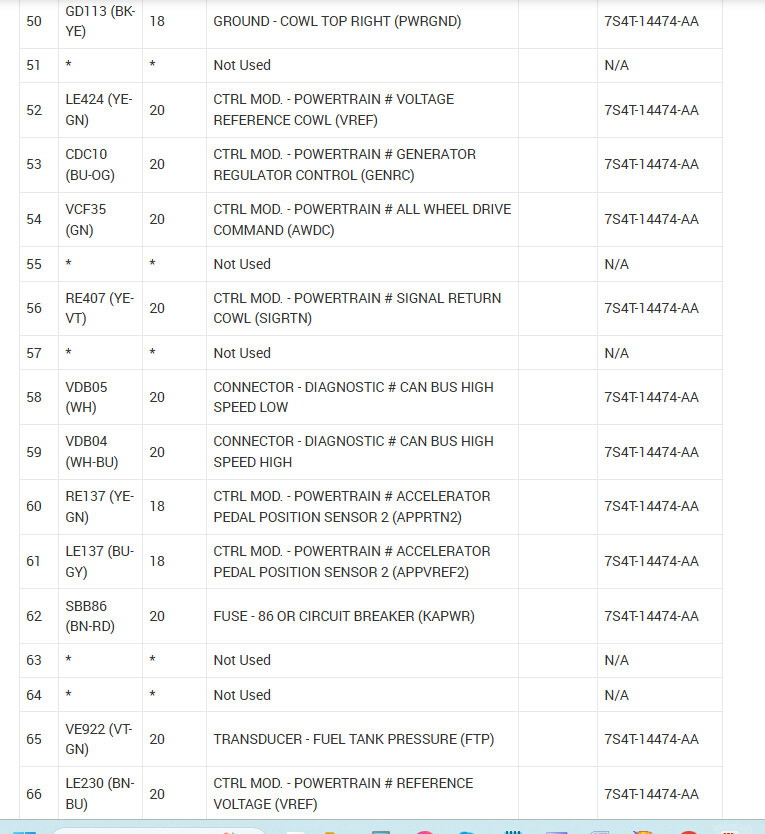

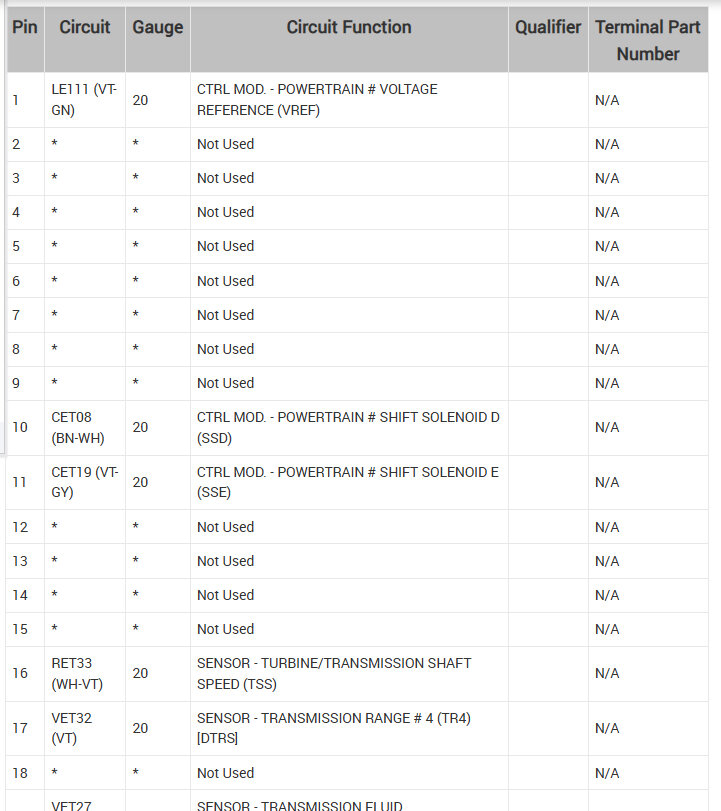

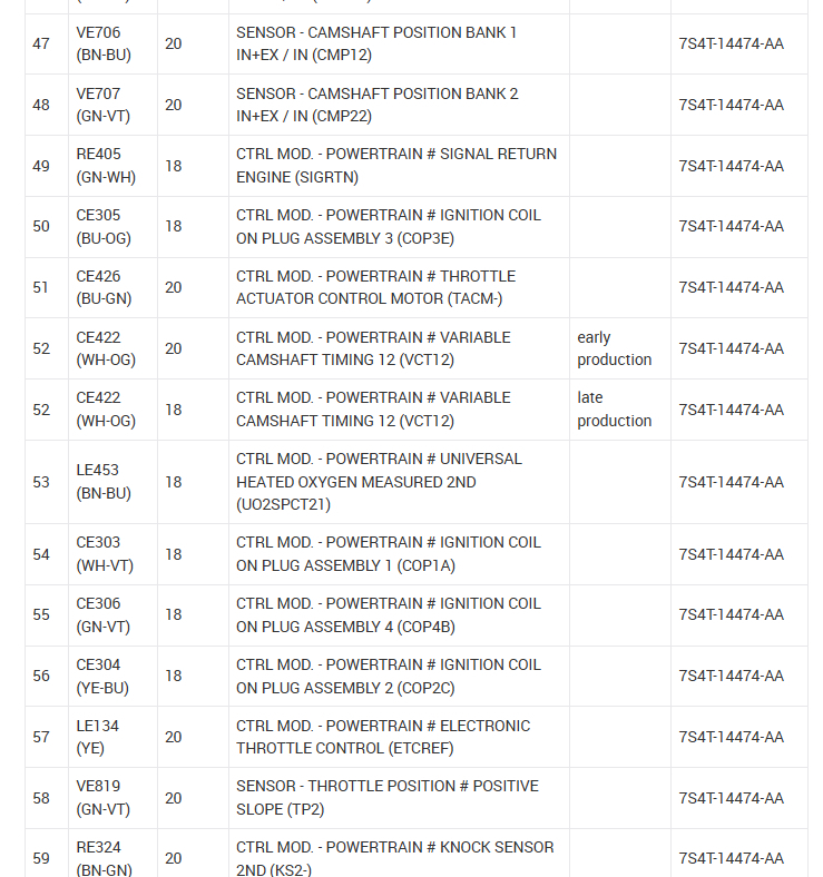

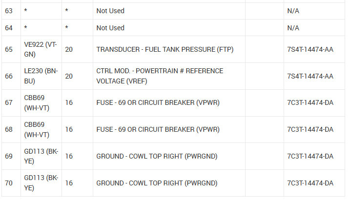

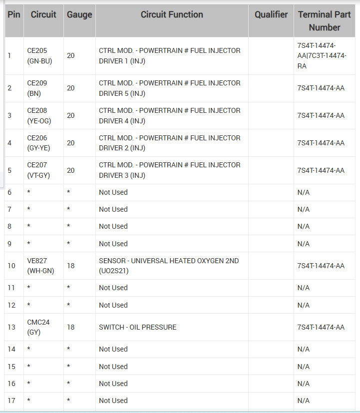

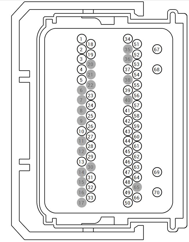

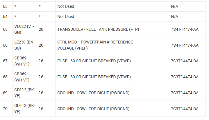

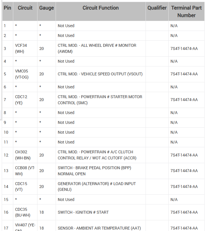

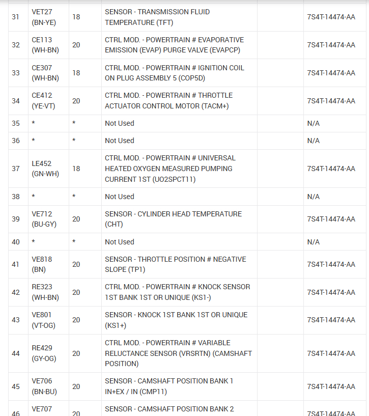

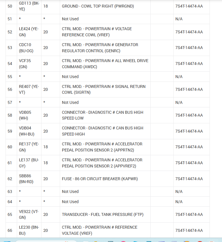

I’m having some issues with a cylinder misfire, all components have been replaced, spark plugs and coil pack and injector. I’m still having issues, and I need to know the pinout of the ECM wiring harness plug to test for any broken wires or bad connections.
Jan 24, 2025 at 11:12 PM
  • 55,224 POSTS

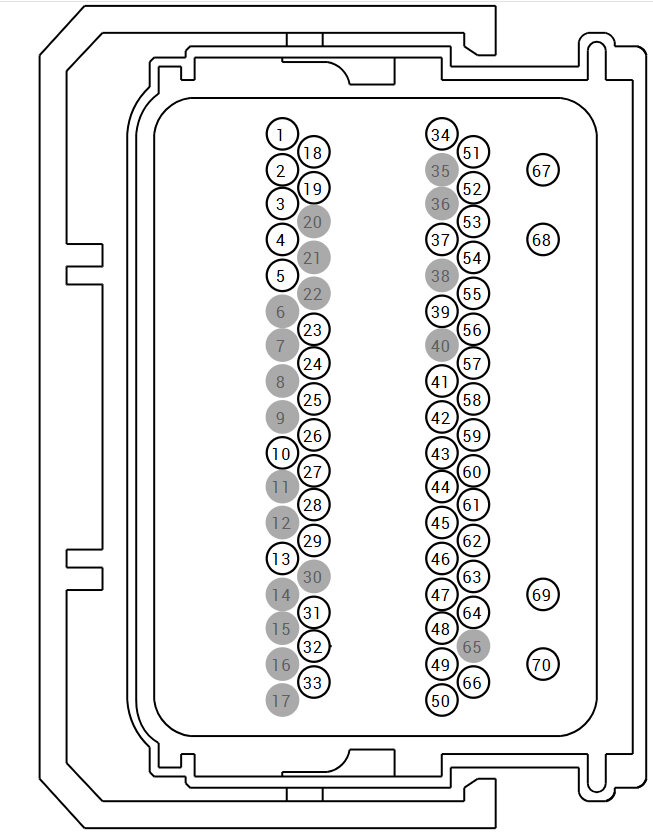

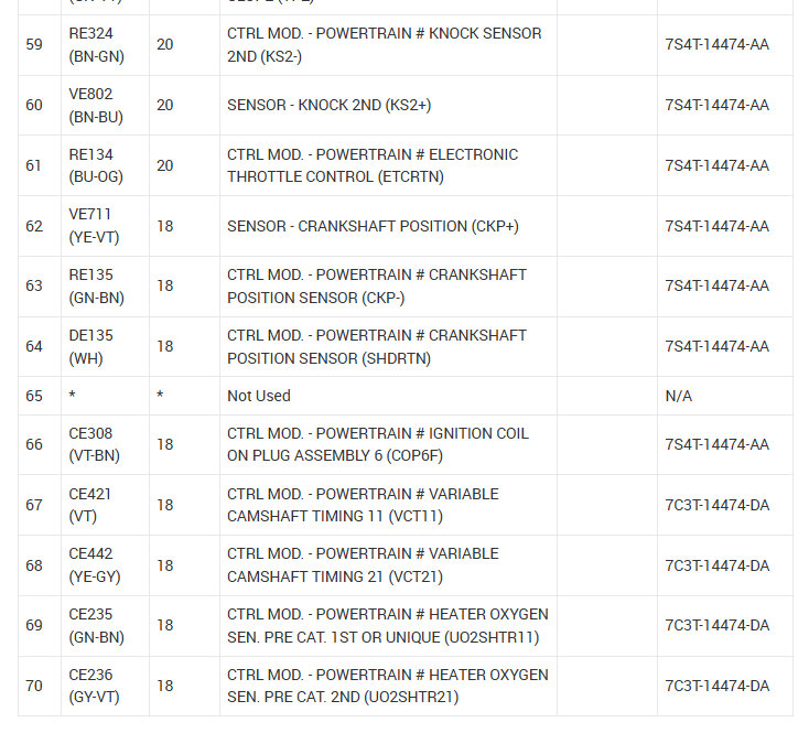

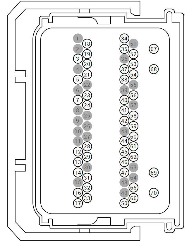

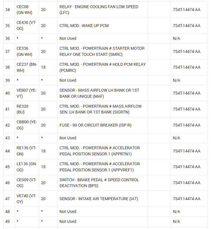

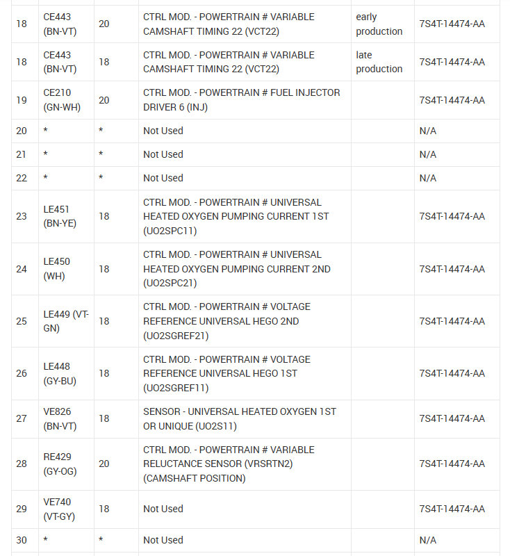

Sure here are the ECM pinouts so you can run some tests. Here is a guide to help you as well:
Check out the images (below). Please upload pictures or videos in your response of any problems so we can see what to help you with.
