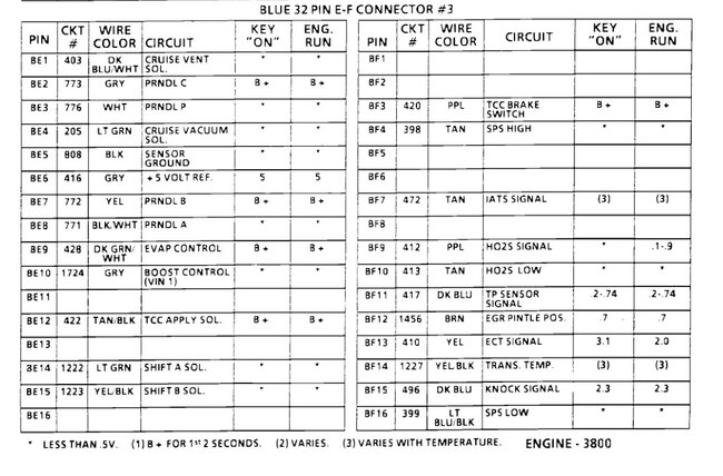

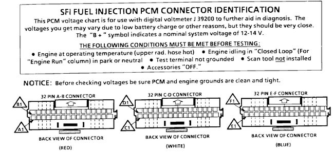

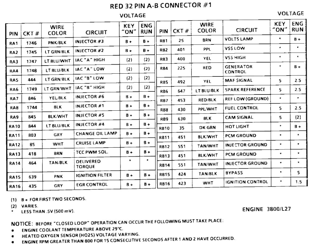

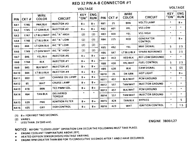

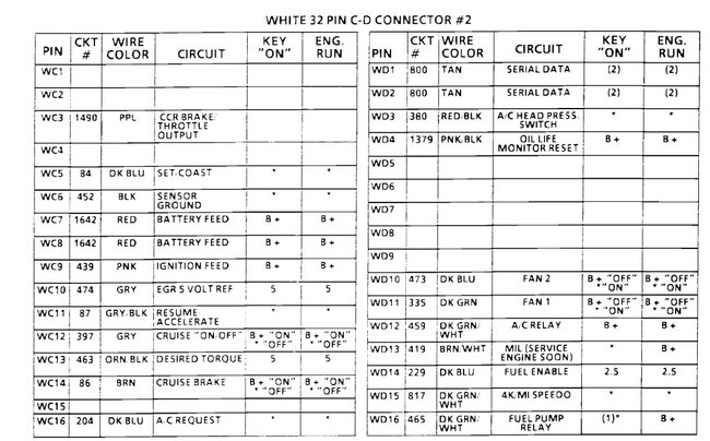

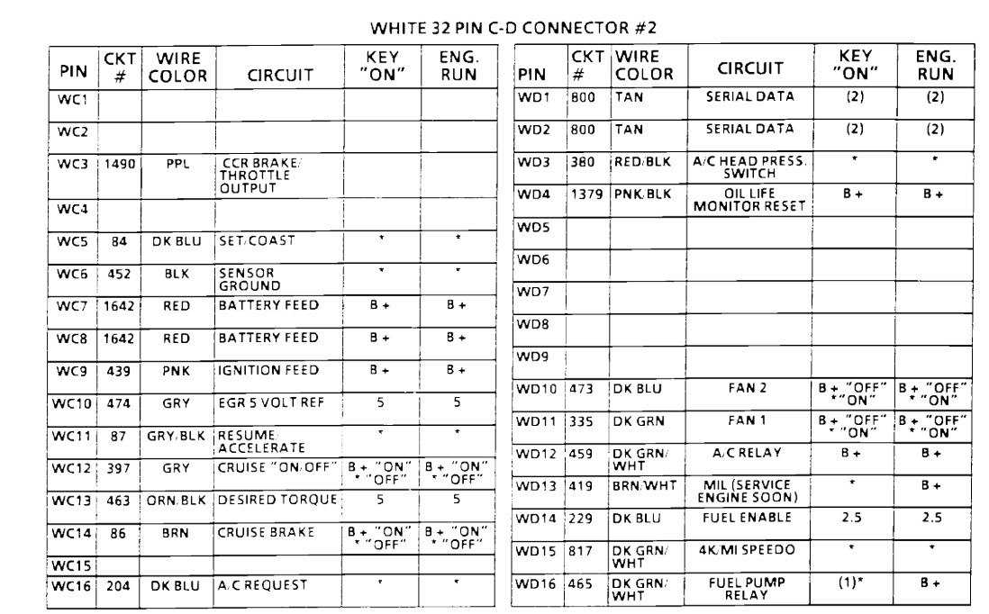

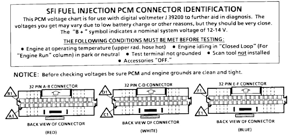

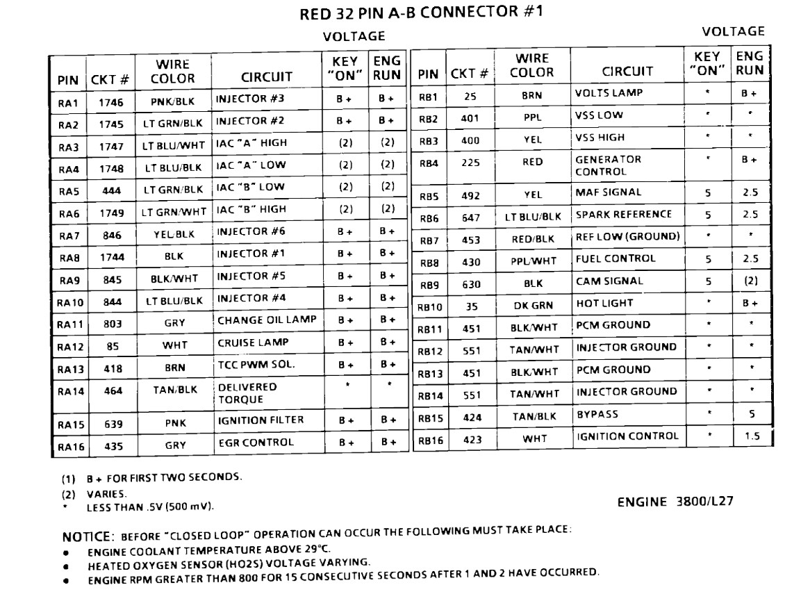

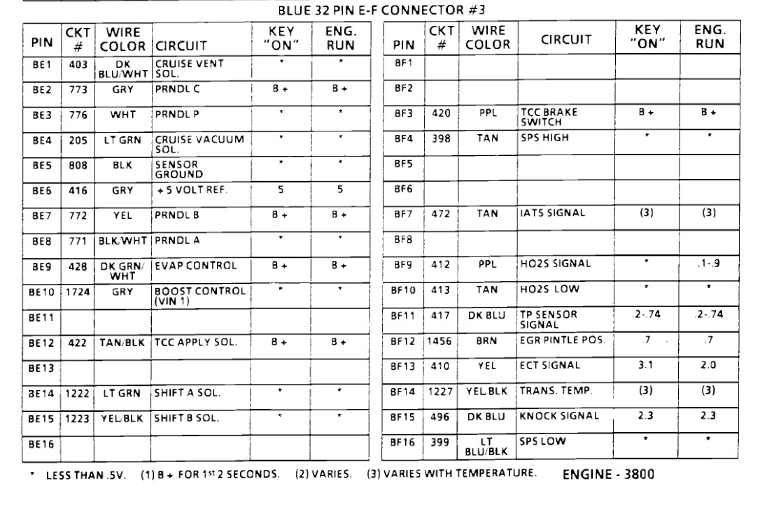

Trying to find the pin and diagram for the ECM.
Nov 9, 2024 at 4:20 AM
Experienced Mechanic
55,746 POSTS
Sure, here is the pinout for the engine ECM. Check out the images (below). Let us know if you need anything else.
Images (Click to enlarge)
Nov 9, 2024 at 4:23 AM
STEVE W.
15,418 POSTS

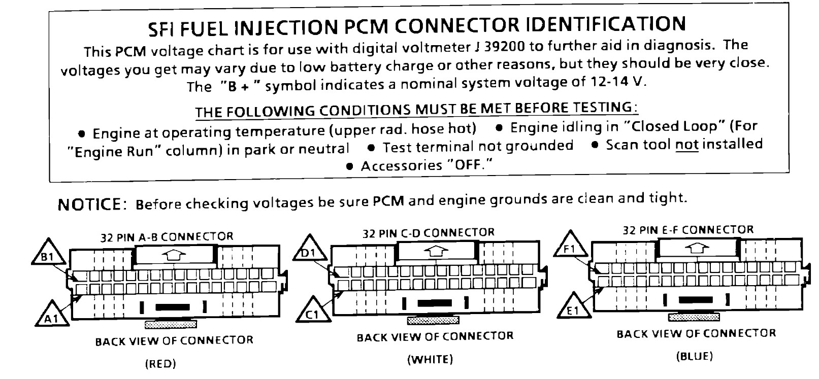

These should be the ones for the 3.8 PCM in the original post.
