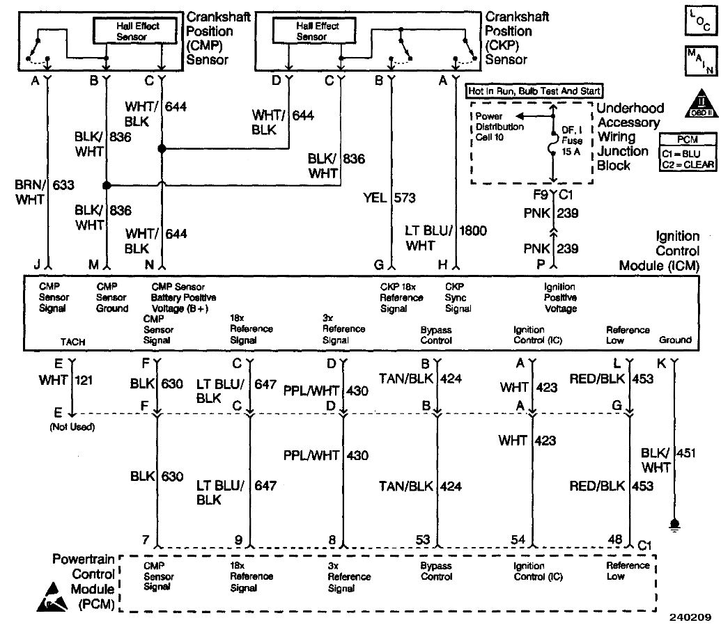

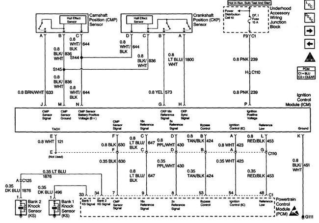

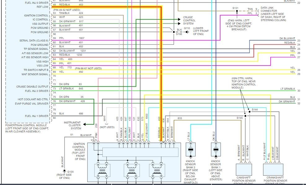

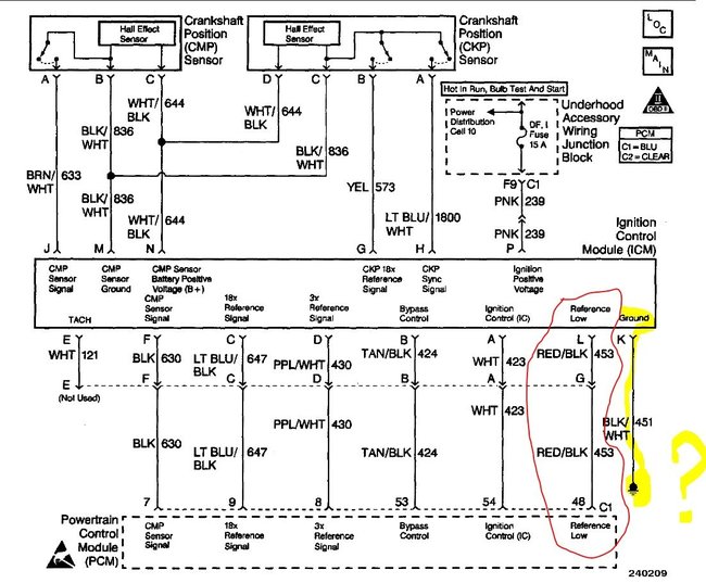

I just rebuilt my 3800 v-6 bottom up new everything i/e bearings, rings ,heads, performance cam, double roller chain, new lifters, pushrods new performance fuel injectors and coil packs, plus lots more. I had also purchased a tuned ECM/PCM from the same company so they had all of my info. I had everything wired except the ECM/PCM cranking engine with remote starter switch to build oil pressure everything good so far disconnected the battery to install and hook up ECM/PCM went to hook up the battery and immediately saw smoke by the ECM/PCM removed battery, cable checked all wiring for pinch or shorted wires none found. I went to hook up battery again same thing, looked closer at the ECM/PCM and noticed that the insulation on the red with black stripe wire going to pin #48 on the ECM/PCM was melted any clues?

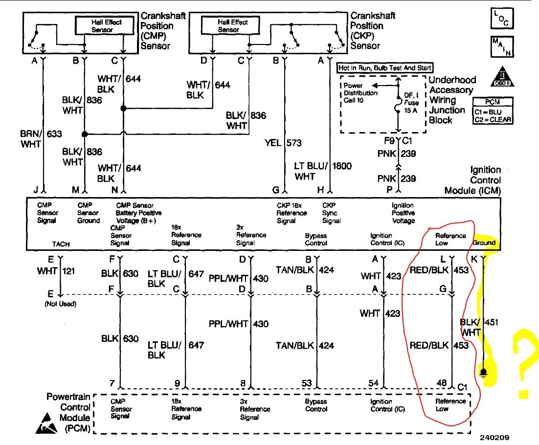

Pin 48 is a reference from the ignition module.

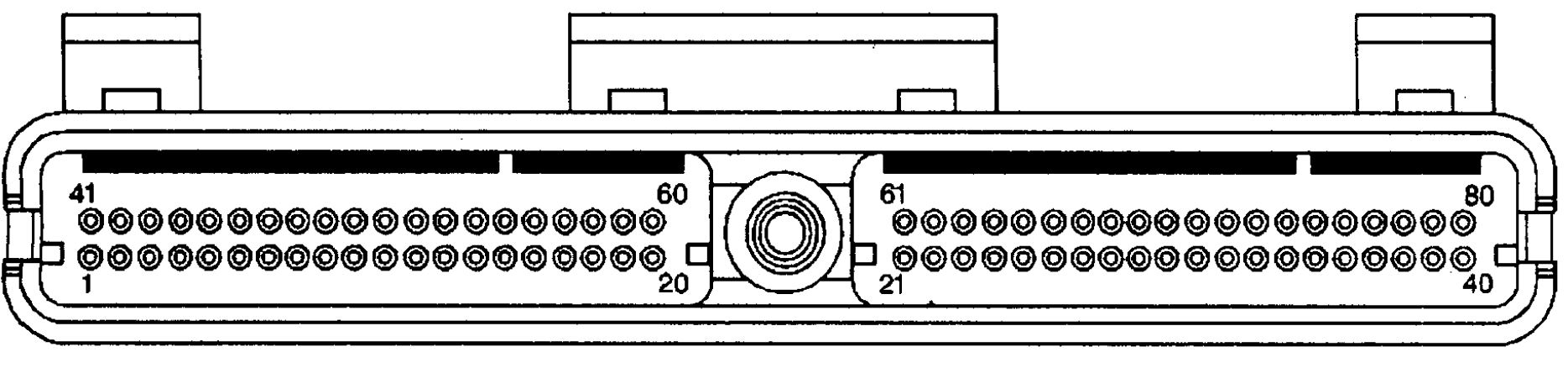

I attached a picture for you. It sounds like your new ECM is no good.

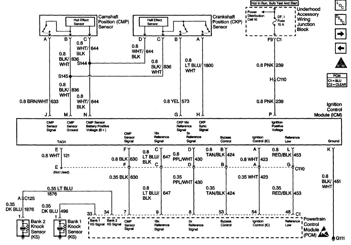

Pin 48 is the low reference (module to module ground) to the ignition module. I would grab a VOM and measure the pin on the ECM and then check the same wire at the ignition module. I suspect you will find there is voltage on the coil side. Check the ground for the coil packs and if you have the old one connect it up and check it for the same issue. Could be that the coil pack itself is defective. If pin 48 still shows a ground when you test it compared to other grounds the ECM should still be okay.

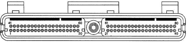

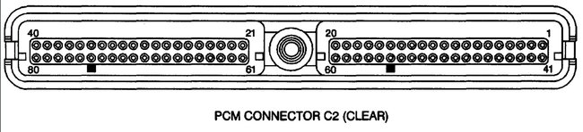

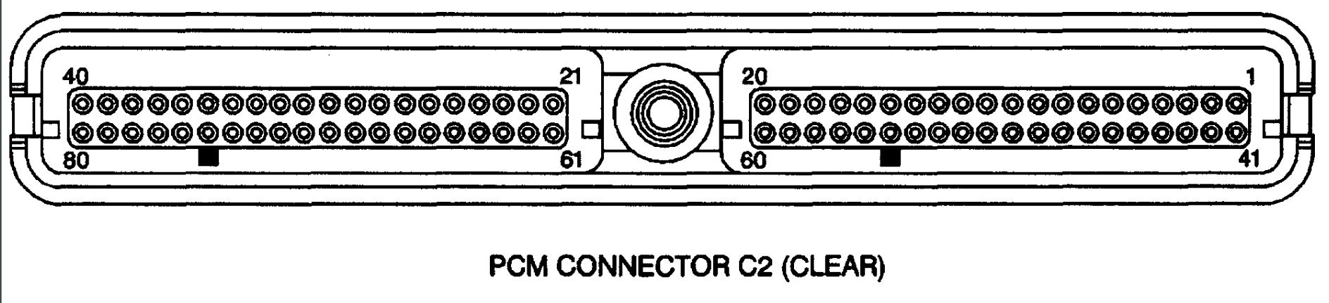

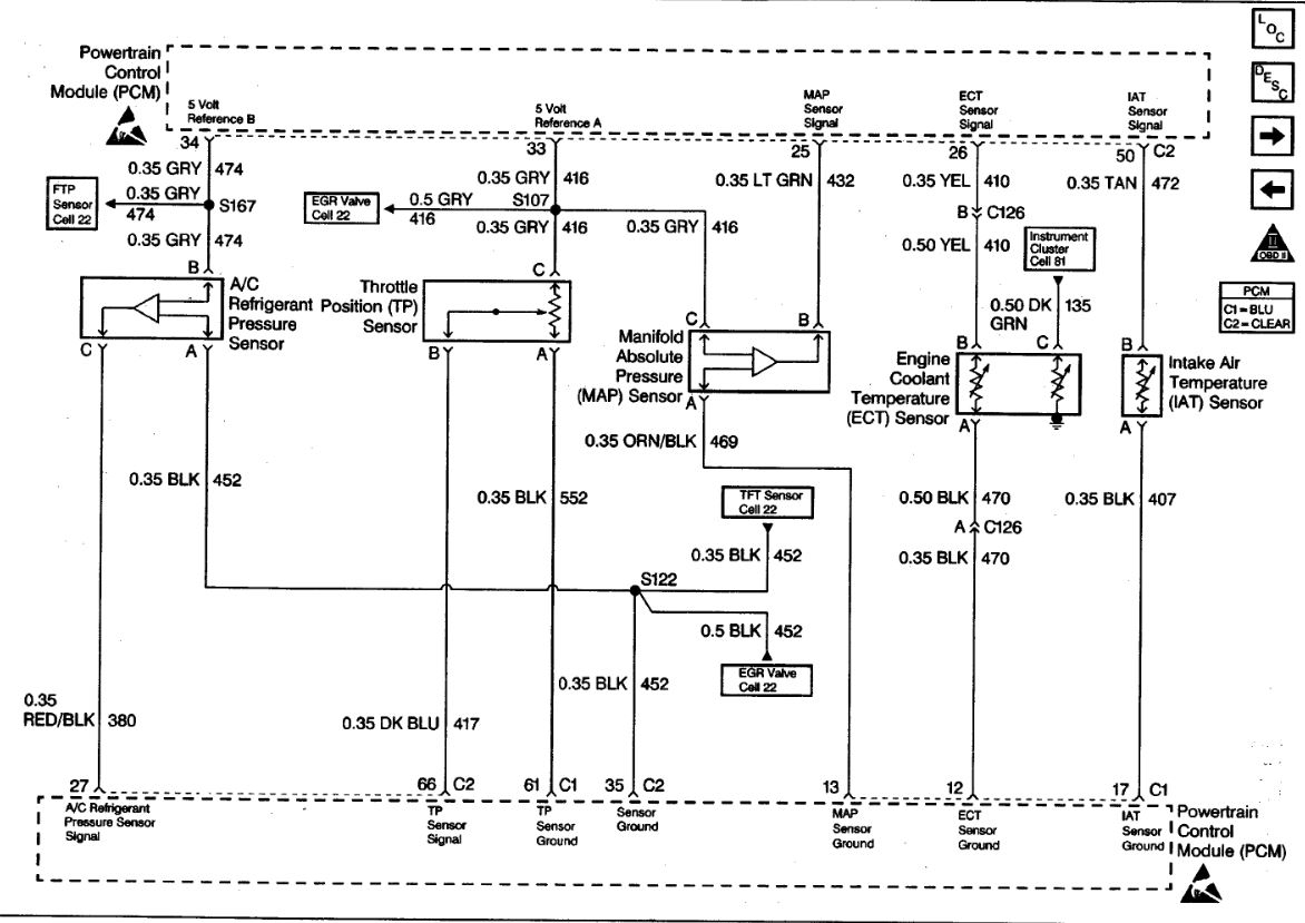

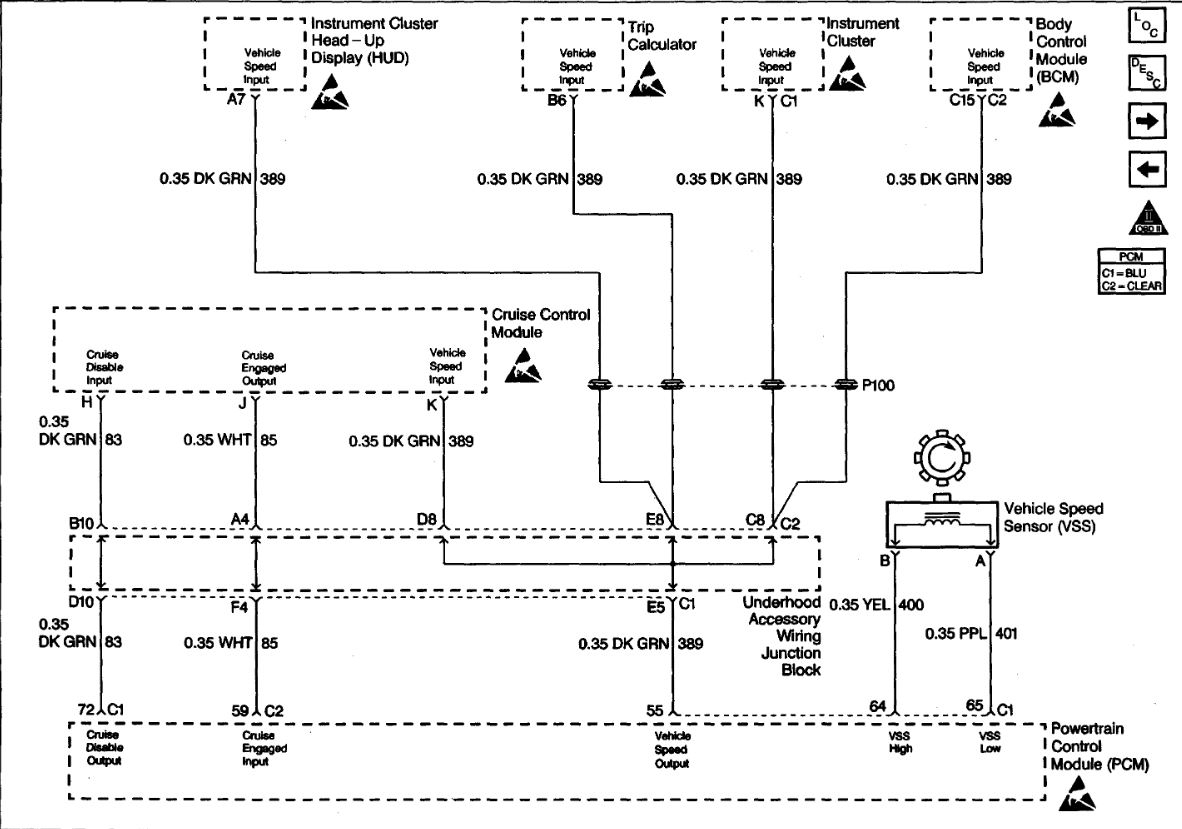

I found a pinout for a ECU but it is not clear if you are showing the ECU or the harness and which side of the harness that I am looking at. can you clear that up? thanks
Mar 11, 2021 at 7:36 AM (Merged)
STEVE W.
  • 15,344 POSTS

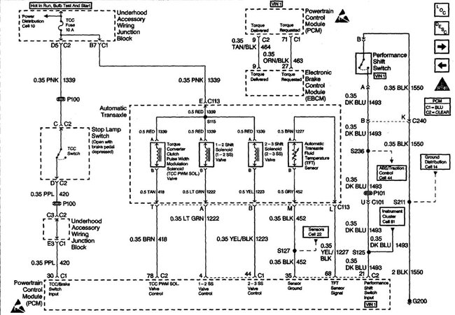

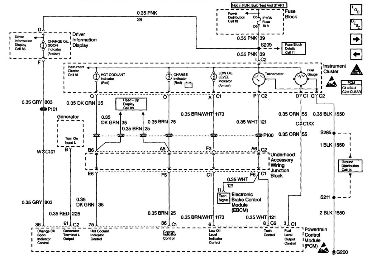

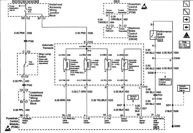

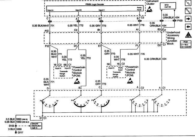

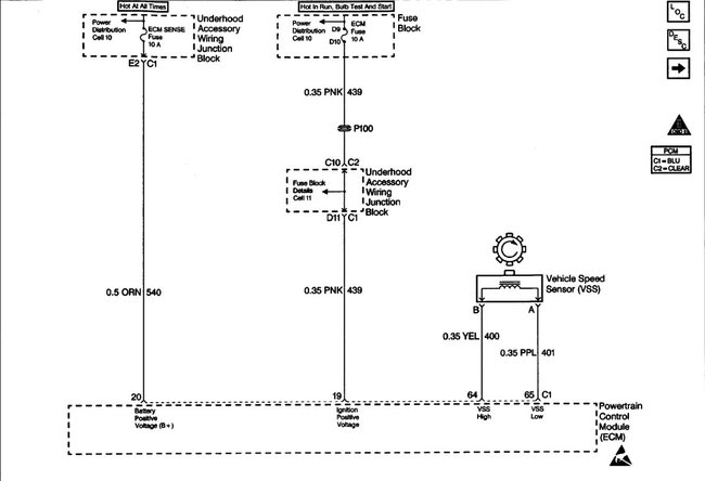

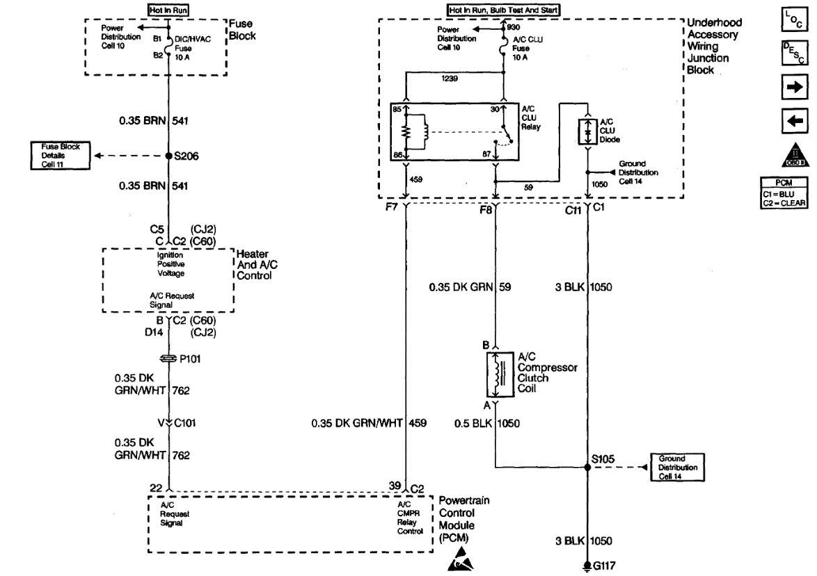

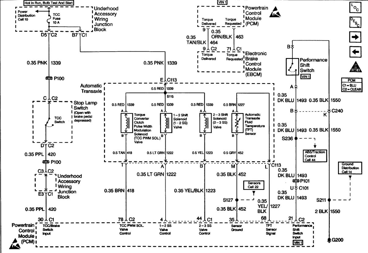

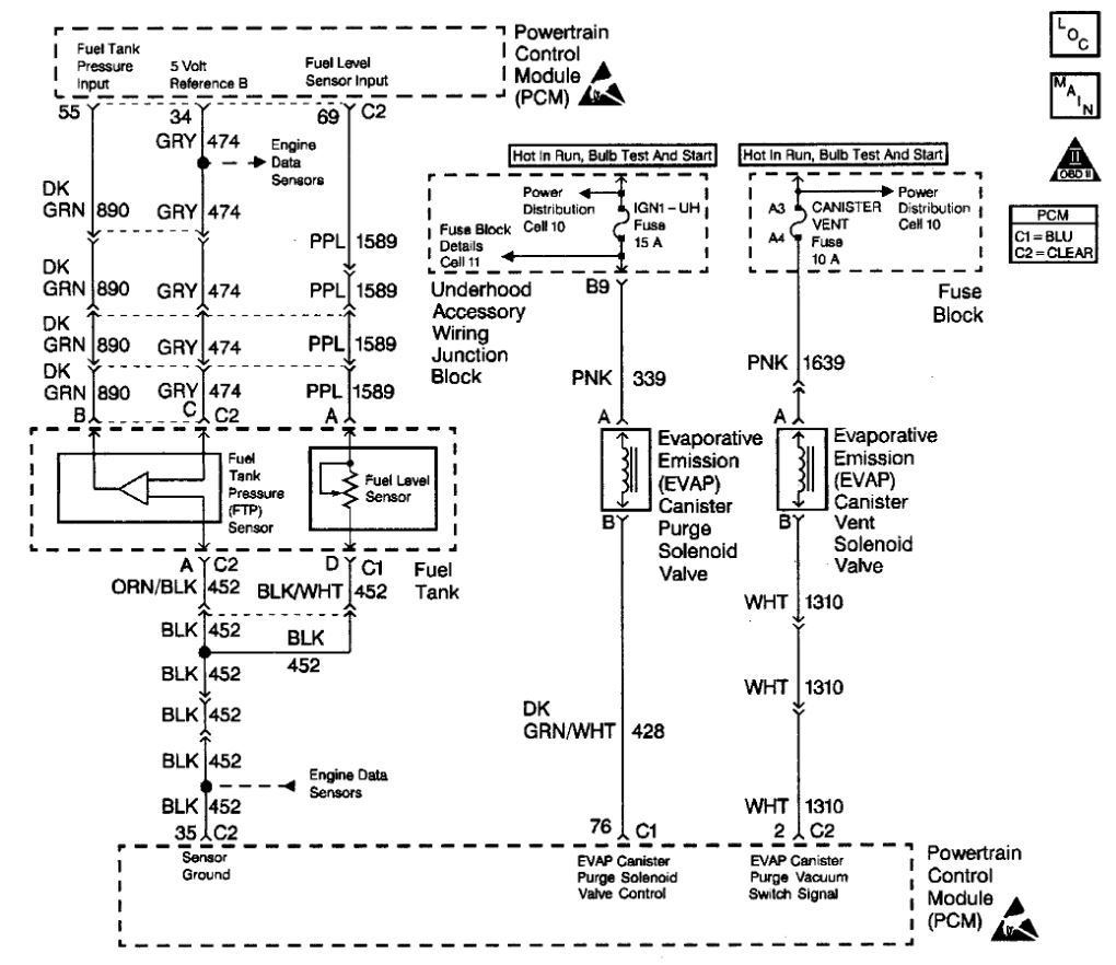

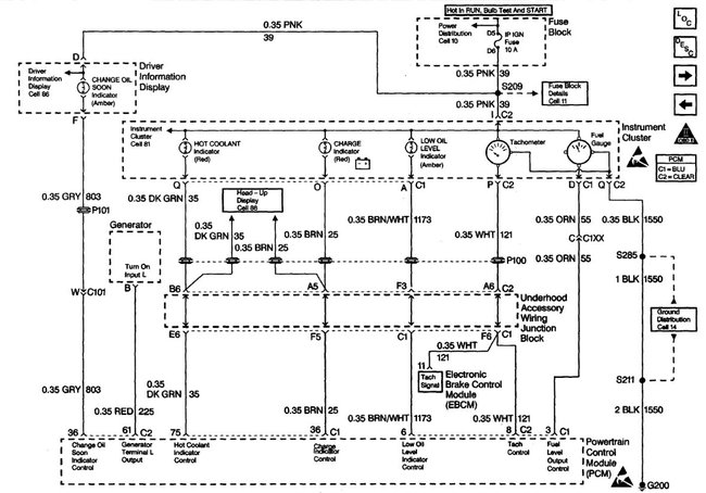

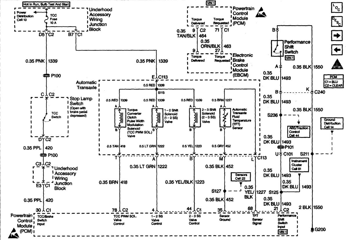

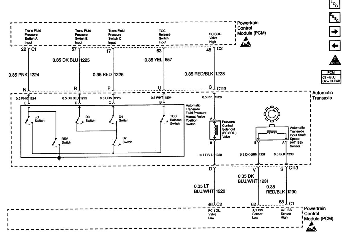

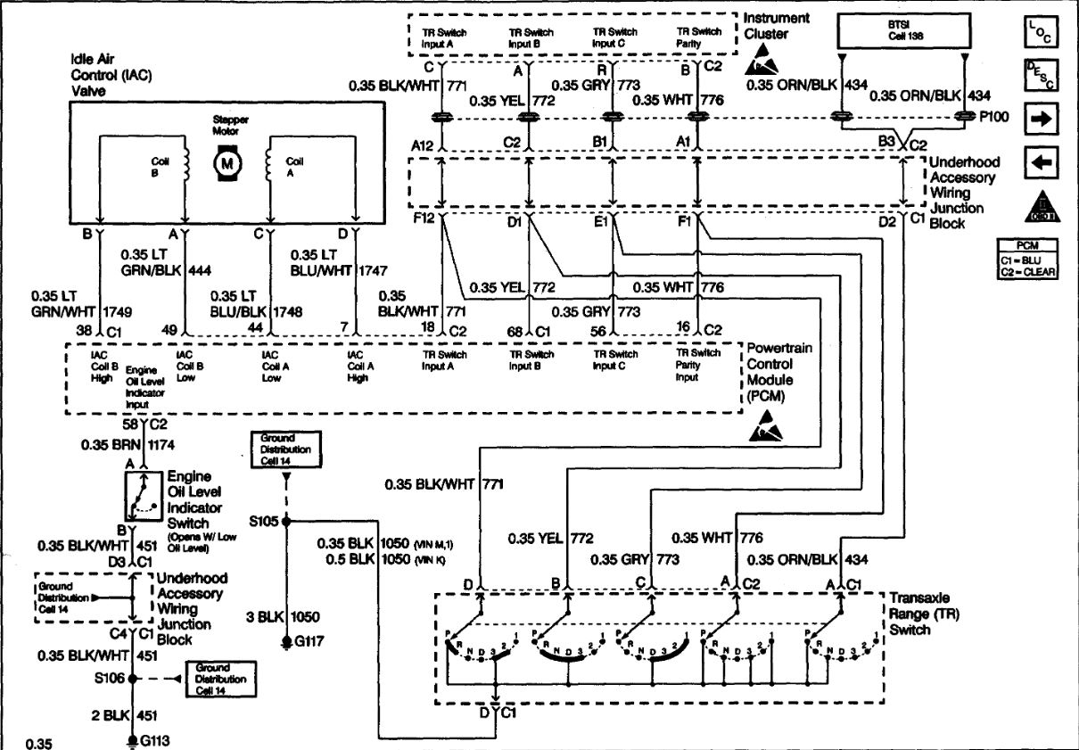

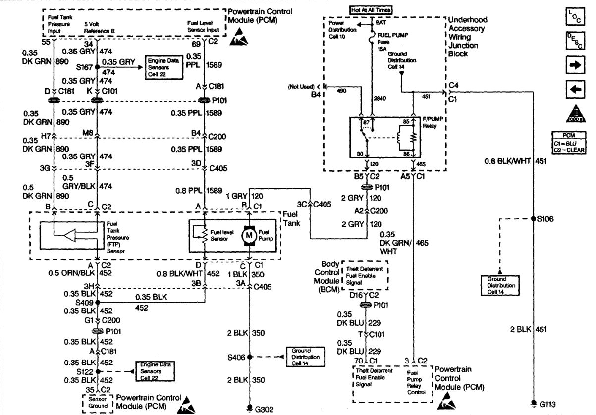

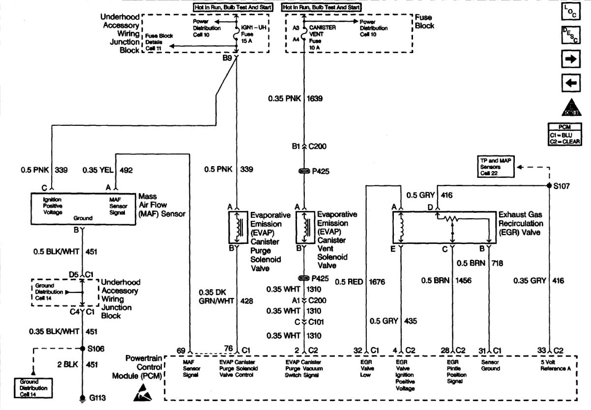

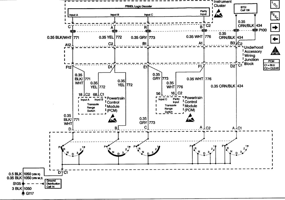

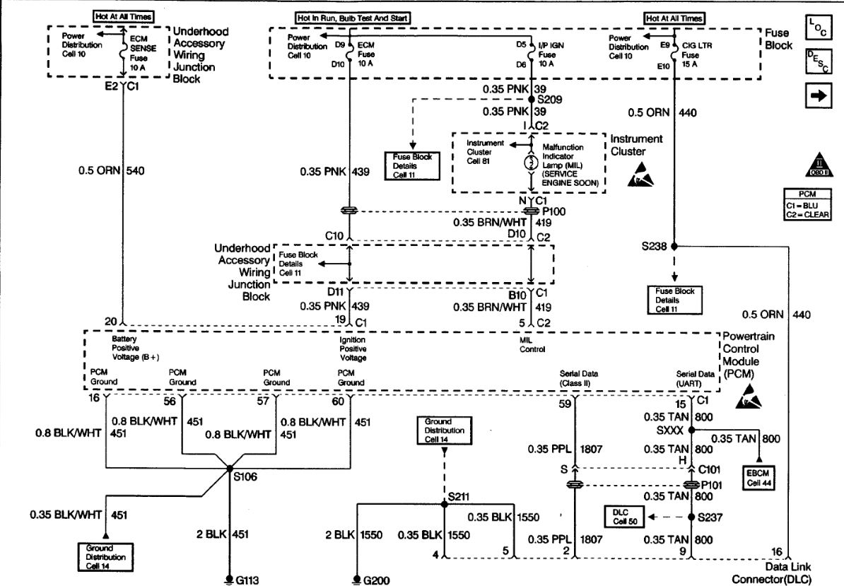

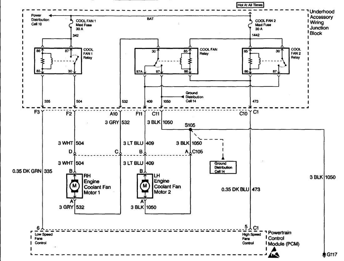

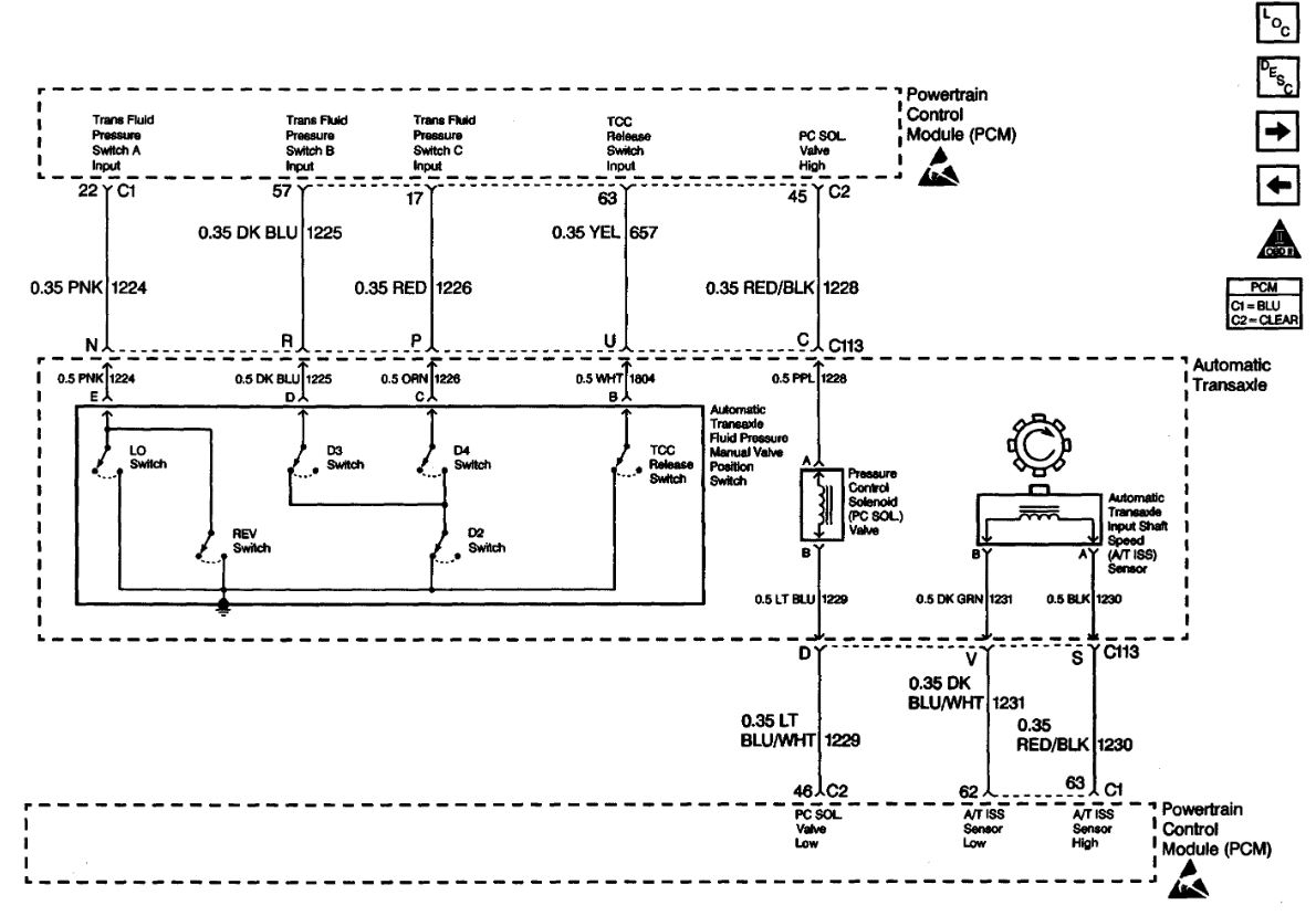

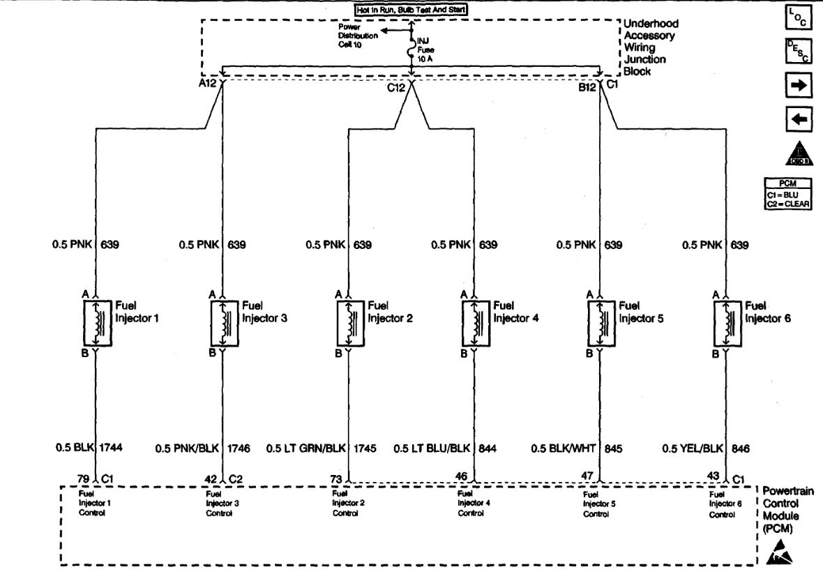

Perhaps these will help. They are the various wiring diagrams that connect to the PCM. The C1 connector is Blue while C2 is "Clear" aka dirty white normally. These are both looking at the face of the connector on the harness.
The others are the wires and what they control from the PCM.
