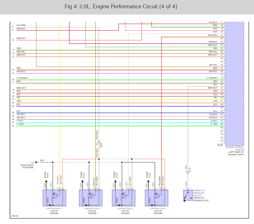

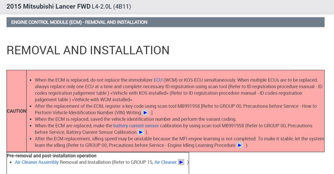

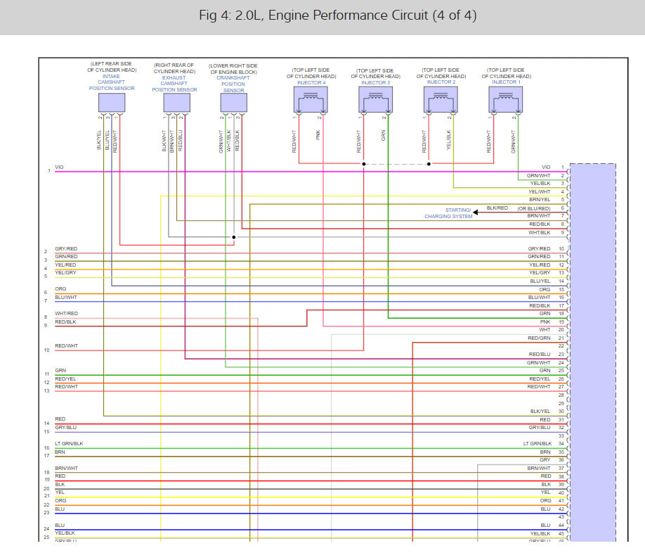

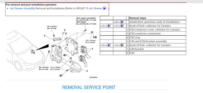

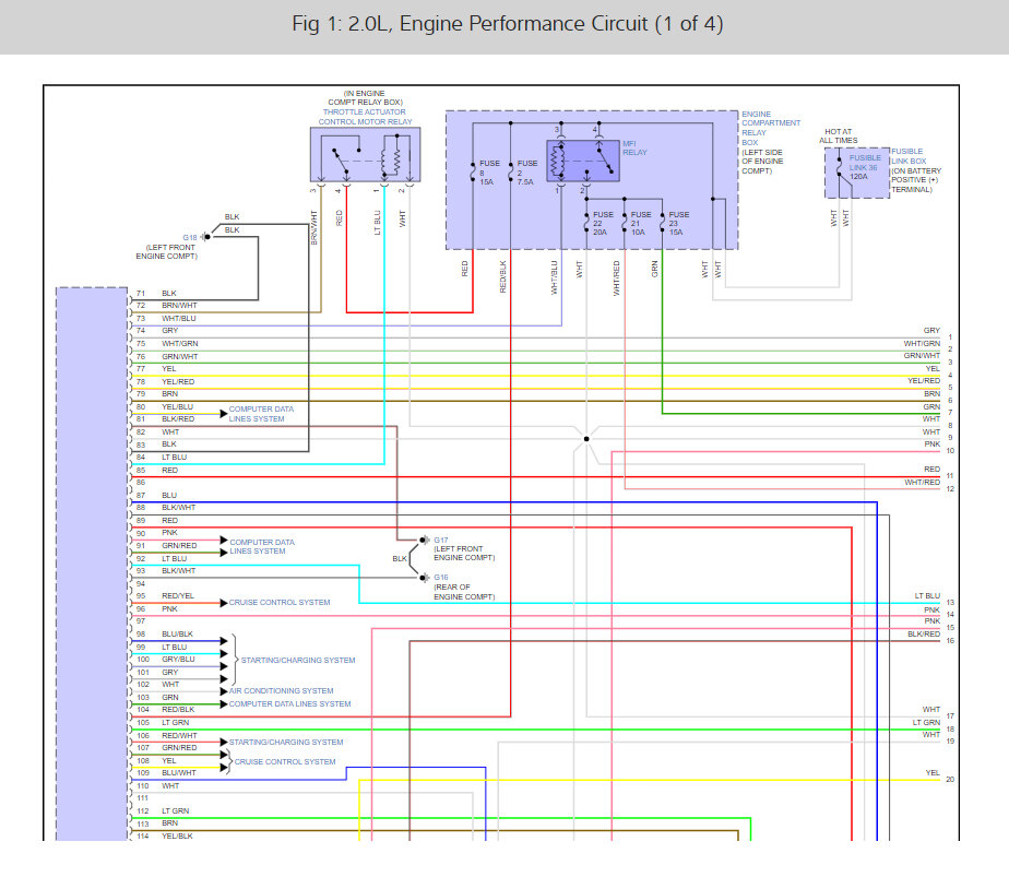

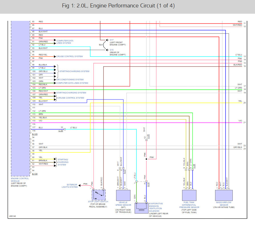

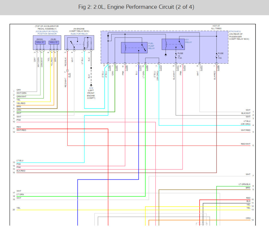

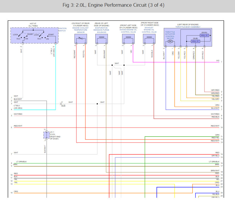

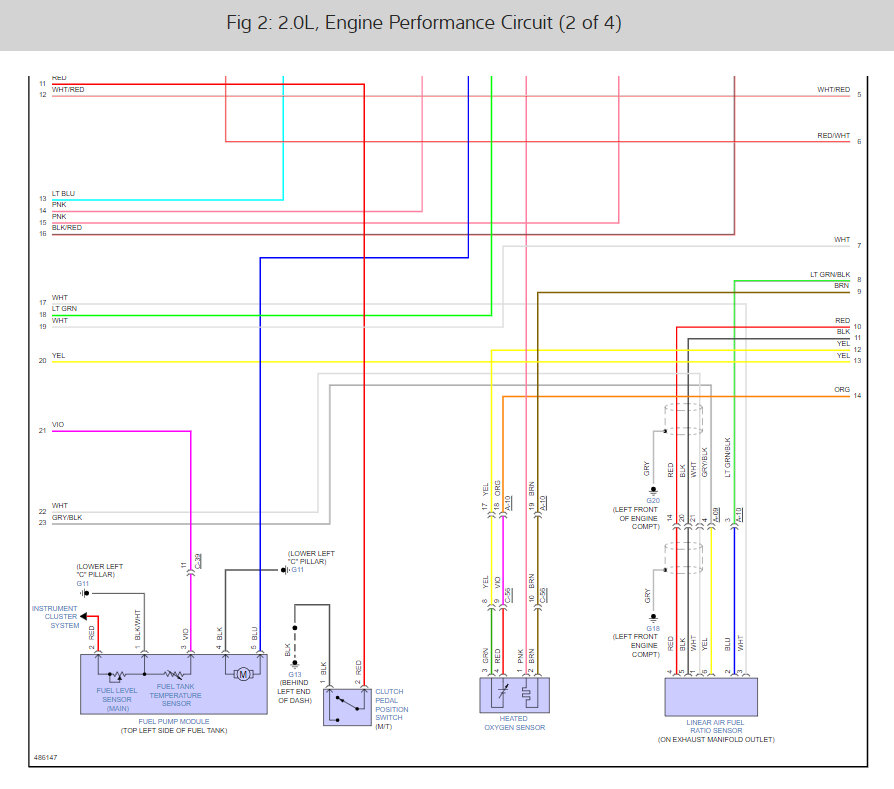

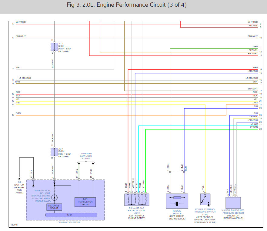

Attempting to check voltage on the ECM/PCM for the car listed above ES model. The vehicle does not start and has some codes relating to communications such as the U0100. I wanted to check voltage to make sure it does not have a bad ground, while I can locate the ECM I can’t find details on the PCM and did not know where it was located or if it was part of the ECM.
Oct 13, 2022 at 1:16 PM
  • 55,694 POSTS

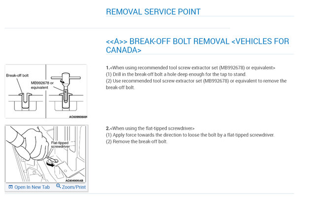

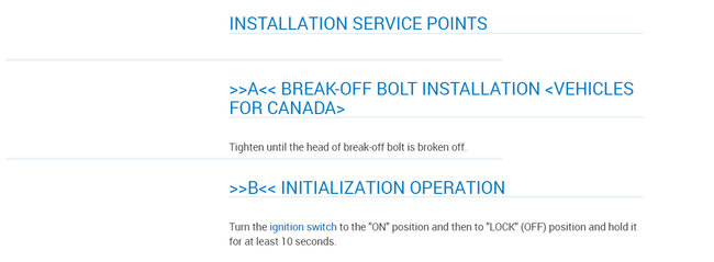

Here is the PCM location and how to replace it if needed and I have included the PCM and engine wiring diagrams so you can see how the system works and which wires to test.
This guide can help as well:
Check out the images (below). Please let us know what you find. We are interested to see what it is.
