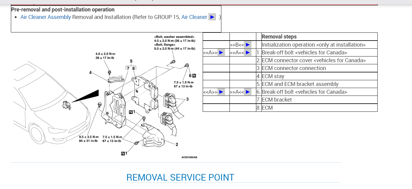

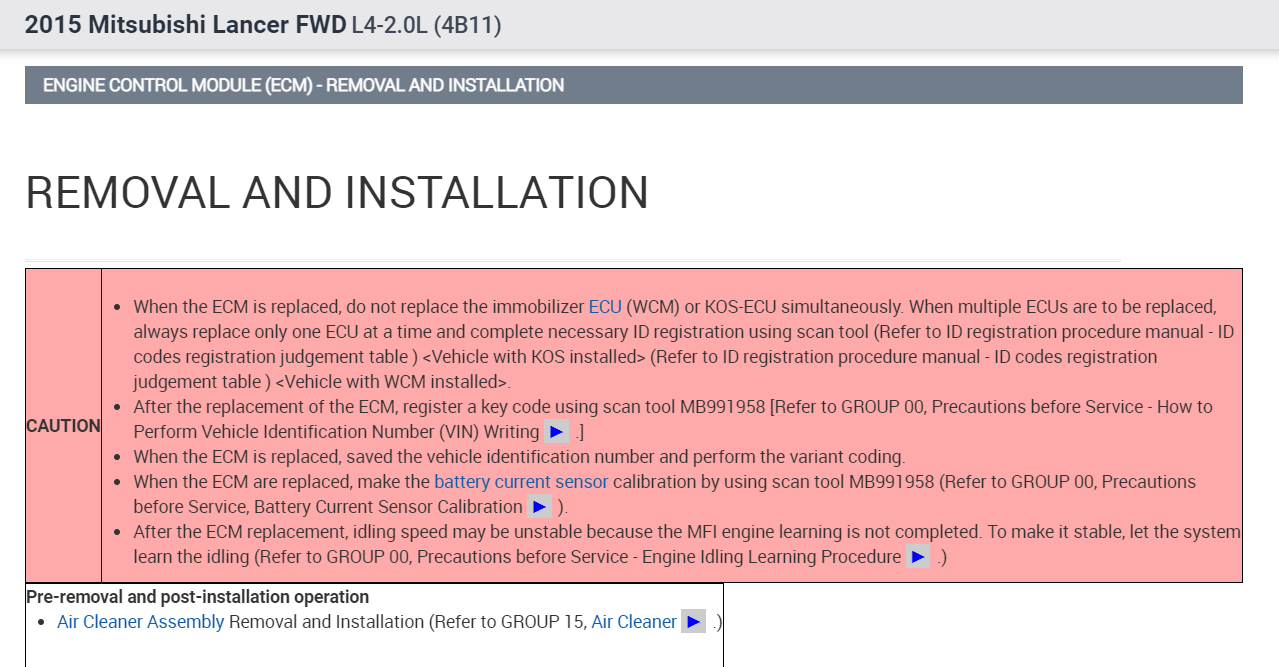

Where is the ECM/PCM located?
2015 MITSUBISHI LANCER
75,000 MILES • 2.0L • 4 CYL • 2WD • AUTOMATIC
RHEDD0913

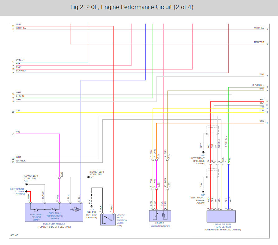

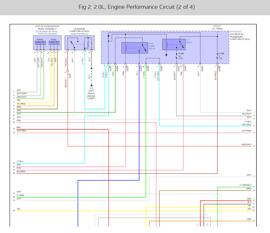

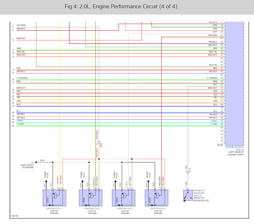

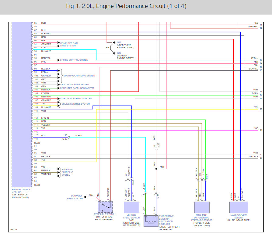

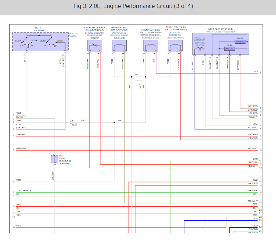

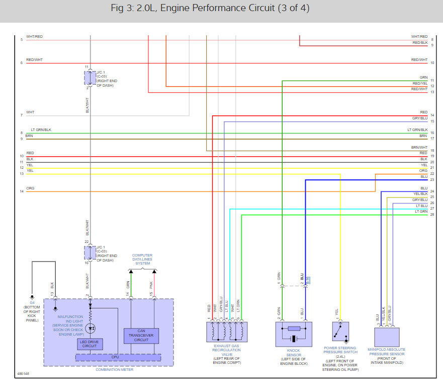

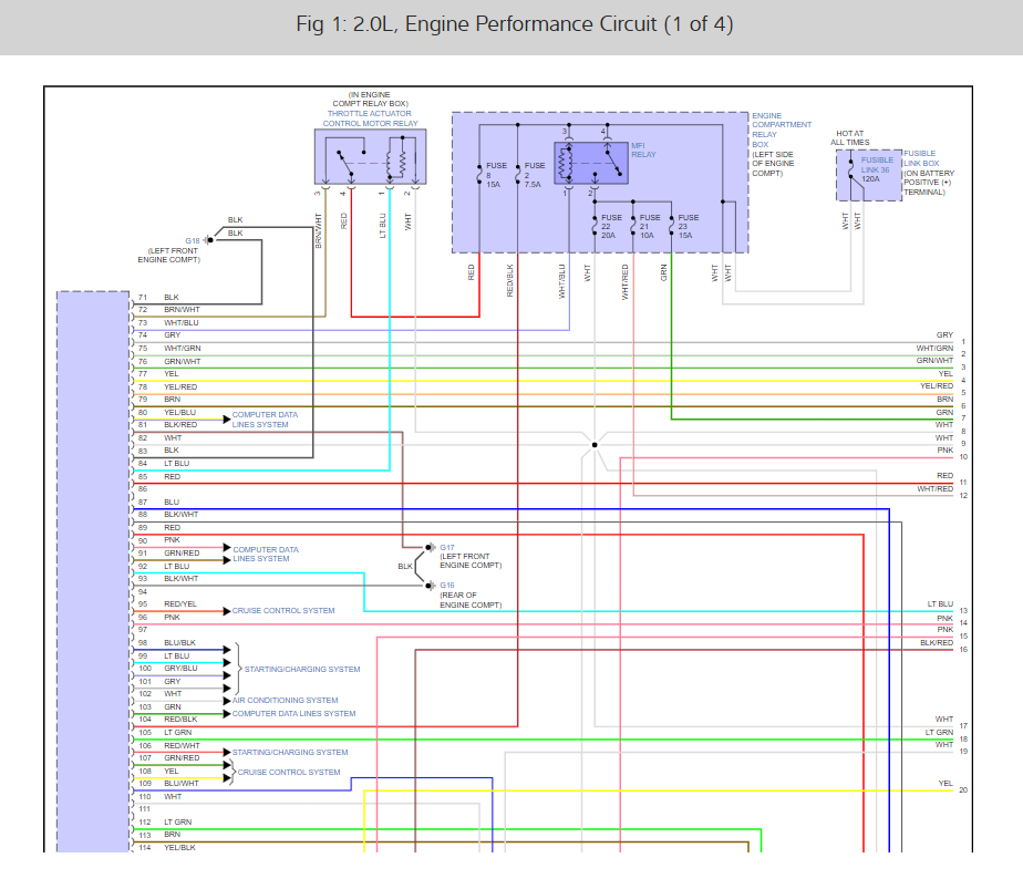

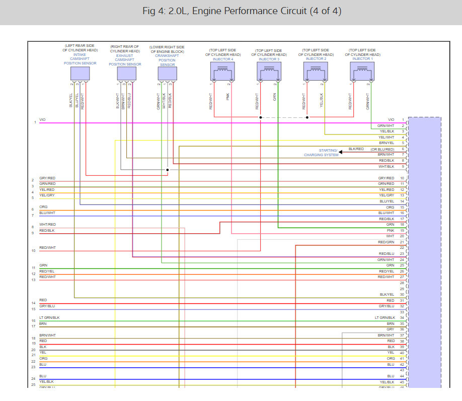

Attempting to check voltage on the ECM/PCM for the car listed above ES model. The vehicle does not start and has some codes relating to communications such as the U0100. I wanted to check voltage to make sure it does not have a bad ground, while I can locate the ECM I can’t find details on the PCM and did not know where it was located or if it was part of the ECM.

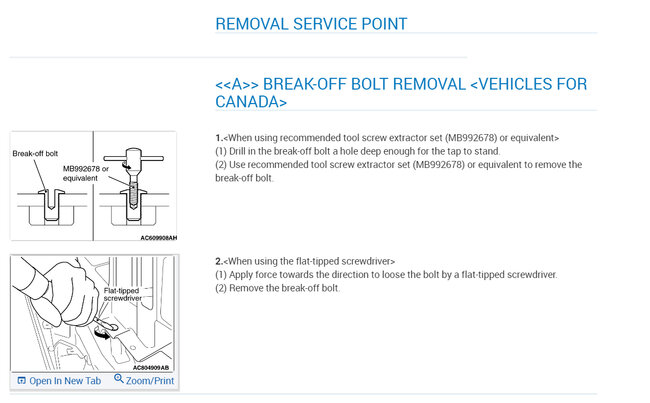

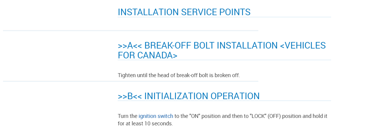

Here is the PCM location and how to replace it if needed and I have included the PCM and engine wiring diagrams so you can see how the system works and which wires to test.
This guide can help as well:
Check out the images (below). Please let us know what you find. We are interested to see what it is.
