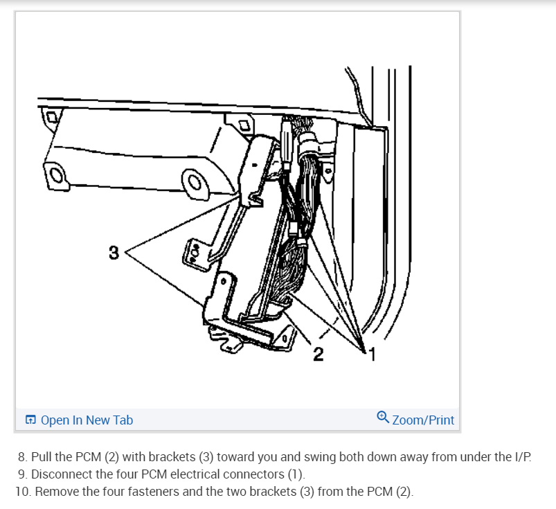

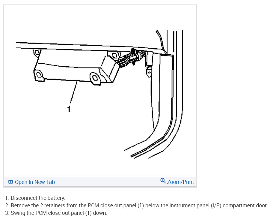

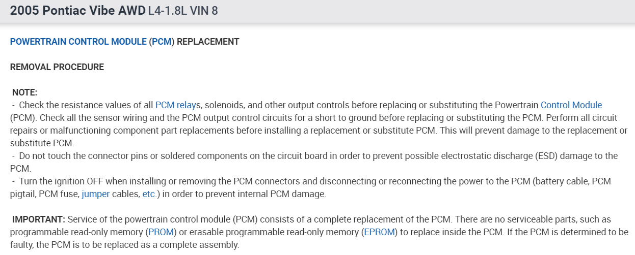

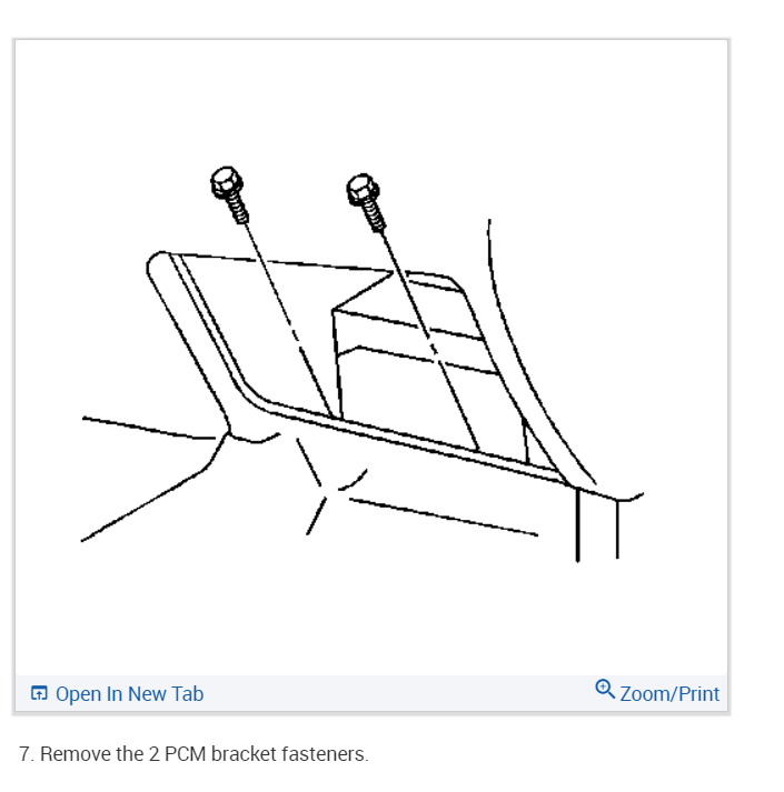

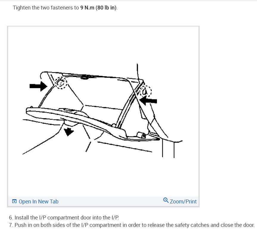

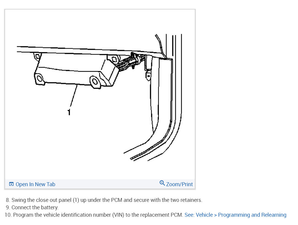

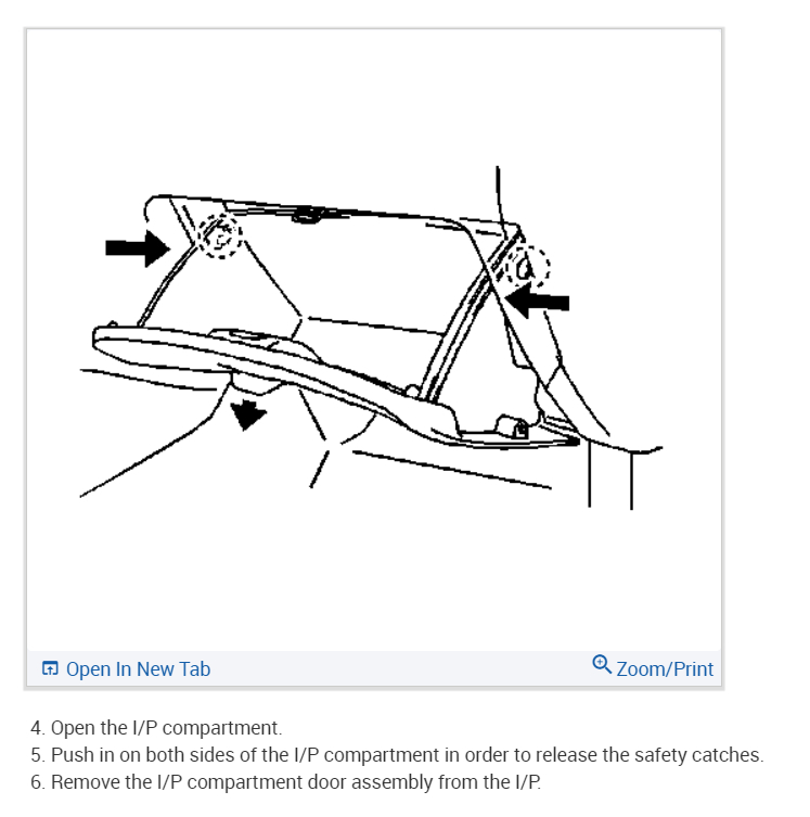

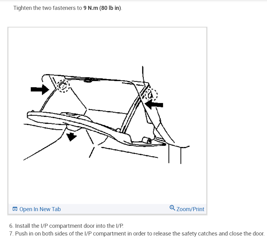

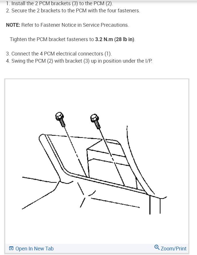

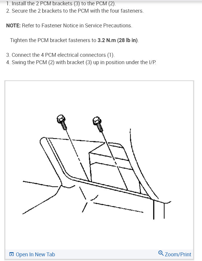

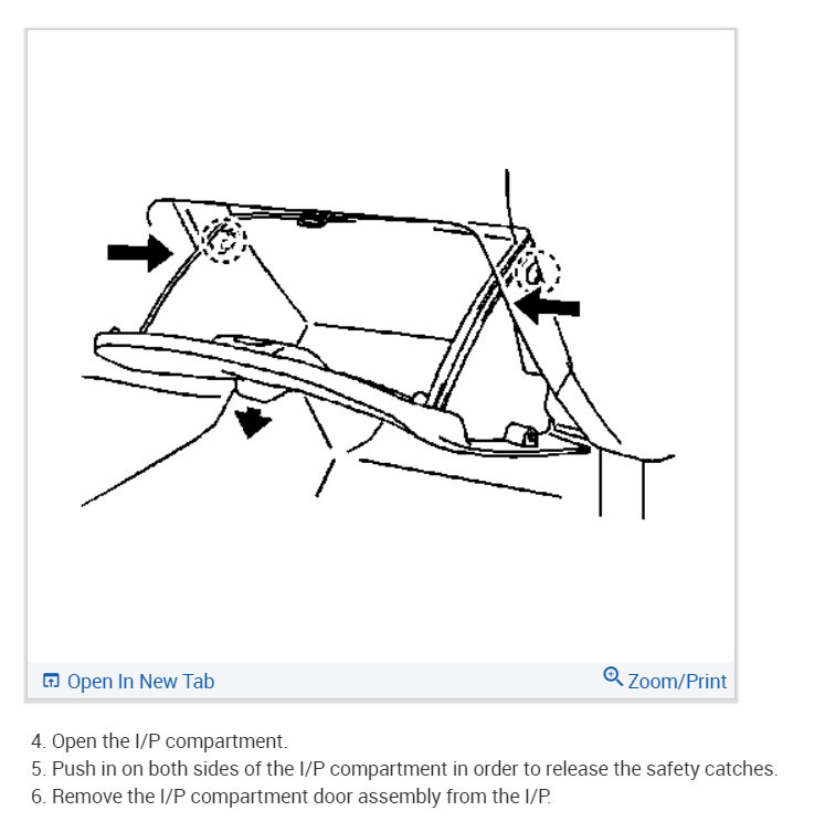

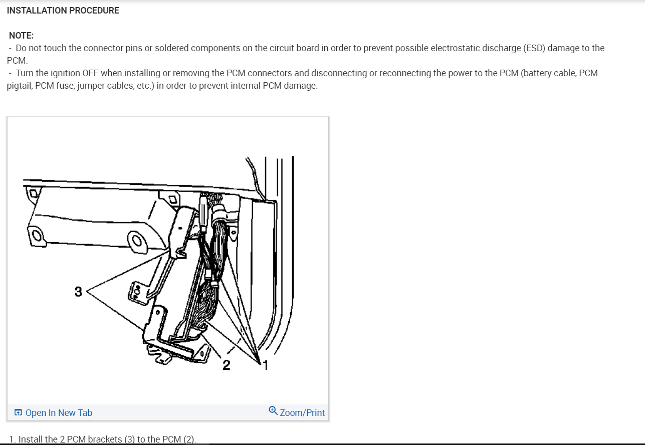

If I can give some info. Yes computers do go bad like that and they will not give a code telling you they are bad in most cases but lets run the codes anyway. Here is how you can replace the PCM:
POWER-TRAIN CONTROL MODULE PROGRAMMING AND SETUP
The following service procedures require either a programming or a setup event performed for a complete repair.
The power-train control module (PCM) cannot be programmed with updated software. The correct replacement PCM is already programmed. The only required setup procedure to perform after PCM replacement is to program the current vehicle identification number (VIN).
PCM Replacement
If the PCM requires replacement, refer to the following:
1. The VIN must be programmed-Refer to Service Programming System (SPS).
2. 1.8L (LV6)-Refer to Power-train Control Module (PCM) Replacement.
3. 1.8L (LNK)-Refer to Power-train Control Module (PCM) Replacement.
Check out the diagrams (below). Please let us know what you find.
