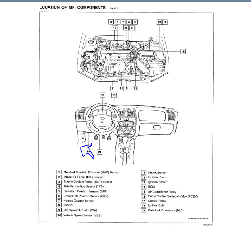

If the check engine light comes on with the key on and the fuel pump runs for 2 seconds, then the ECM is working and may not be the issue.
Does the engine run? If it does and cannot communicate, it may be the scan tool you are using. Try it on another car to see if it works.
As far as testing, special equipment is required for the actual testing to see if it is good. You could remove it and send it out and have it checked.
What is the exact issue with the car?

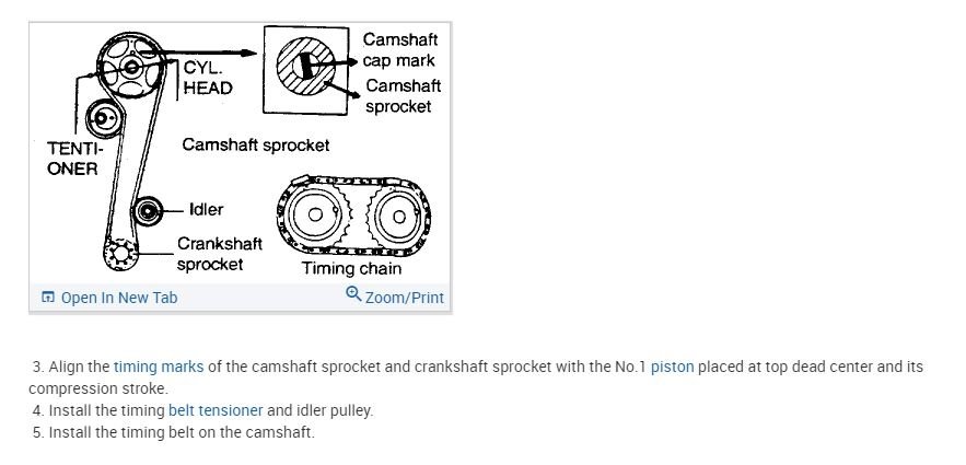

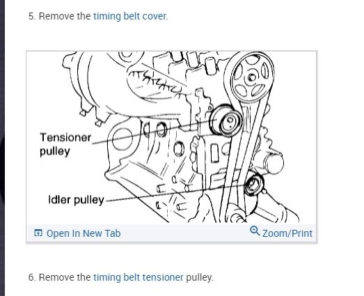

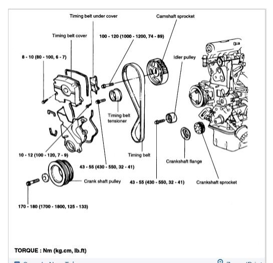

Oct 27, 2021 at 7:31 PM

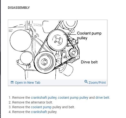

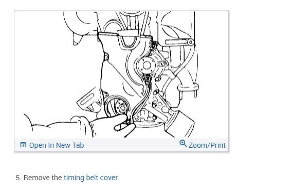

This sounds like the timing belt has failed and moved from its settings.
You need to remove the front cover and inspect it.
I attached the procedure for removing the belt and inspecting the timing marks. You most likely will find the belt teeth are missing.
https://www.2carpros.com/articles/how-a-timing-belt-works

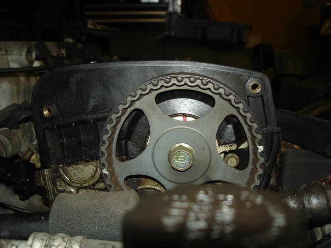

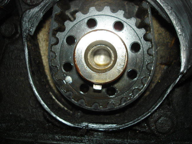

KDCHRIST
  • 39 POSTS

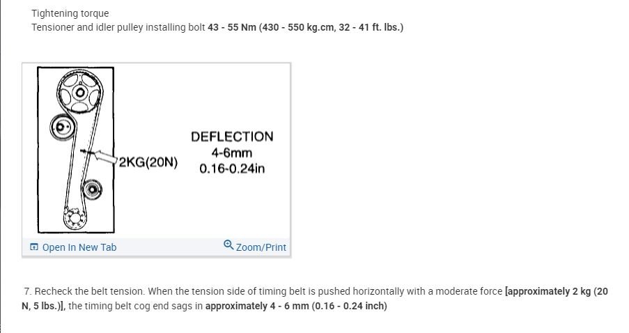

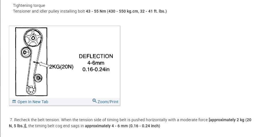

I finally had time to look at the timing belt. According to my manual it says that 06 and earlier to line the two white lines on the top sprocket up with the top of the head, when it is the bottom sprocket appears to be 6 teeth off. I do not see missing teeth on the belt but is not broken. Is this far enough off to have caused damage to pistons or valves by rotating engine with the starter. What are your thoughts? Keith
Dec 6, 2021 at 7:35 AM
Yes, the belt is off. Follow the instructions for replacing the belt and getting the correct marks lined up.

You will need to set the belt correctly and then do a compression test.
You need 140-160 pounds.
