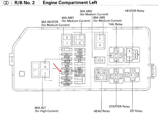

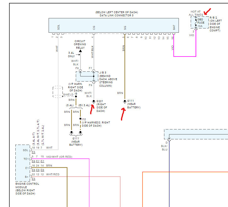

There are two grounds and one power which makes the data port work. I would check the OBD fuse in the fuse panel under the hood, and the grounds.
Here is a guide to help you check for power at the fuse:
Here is a video that can help fix it as well:
https://youtu.be/6Tlg3JmgNSQ?si=msZRjCkfj26L7lX-
I have included the ground and fuse location in the images below. Check out the images (below). Please let us know what happens.

Grounds at pins 4 & 5 tested good, no power at pin 16 in DLC.

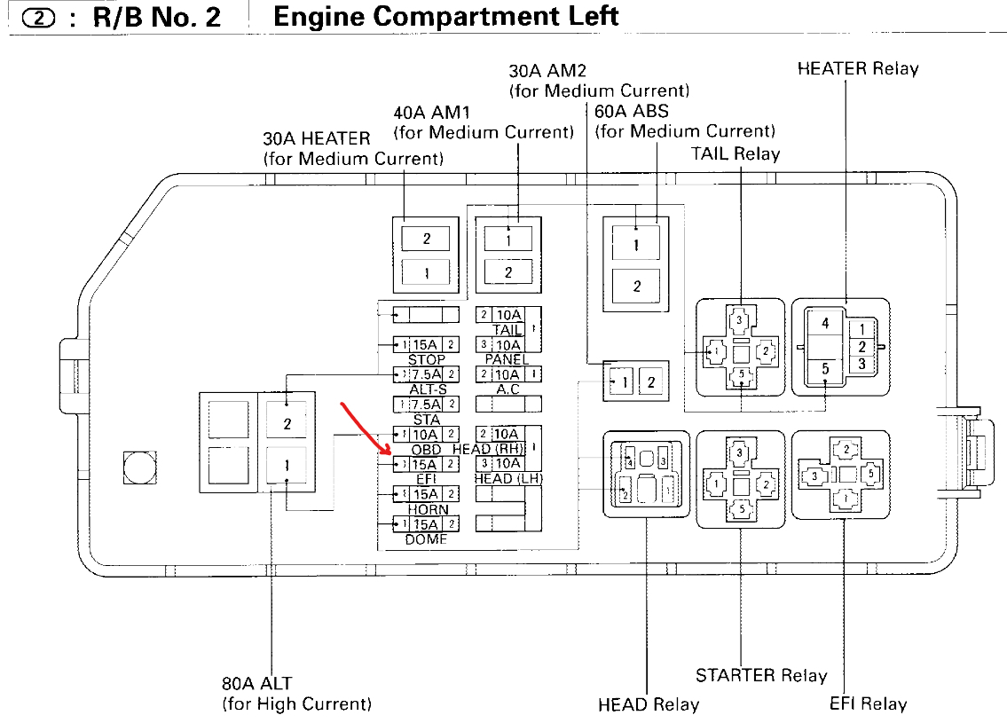

10amp (OBD) and 15amp (EFI) in engine compartment receiving 12.5 volts. 15amp (ECU-IG) under dash receiving 12.5 volts.
Also, there is no power to the 7.5amp (IGN) fuse under dash regardless of whether I am cranking engine or not which makes me think that it is playing a role in this, but schematic seems to show a direct connection to Pin 16.

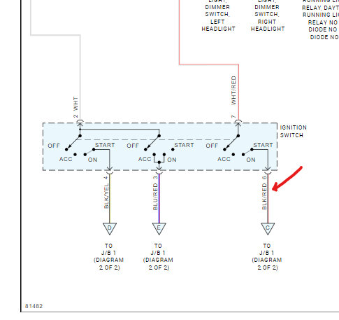

Yep, the fact that the IGN 7.5 fuse does not have power can be the problem. Here a the wiring diagram which shows that power to the fuse is directly from the ignition switch. So, to tell if the switch is the problem and not the wiring let check for power at the blk/red wire out of the switch with the key on.
Check out the images (below). Let us know what you find.

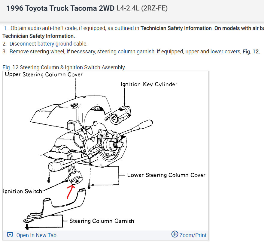

You will need to take the steering column cover off to access the switch, please check out the image below to see what i am talking about.

I have a 2.4 liter motor not a 2.7 as I originally told
you. I get them mixed up as I have both 4 cylinder motors. My ignition switch is in the dash not steering column. I am guessing what you sent me is in the 2.7 liter. I was able to access ignition switch fairly easily and after testing worked myself backwards toward battery and found the 30 amp, AM2 fuse was blown. (I did not realize this was in the circuit and the fuse had to be pulled to test so I missed it in my original fuse check). I replaced it and everything seems to be working for now. I want to thank you again for your help and time.
