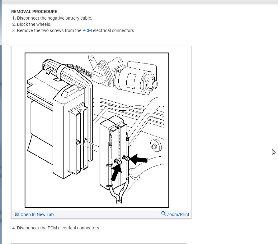

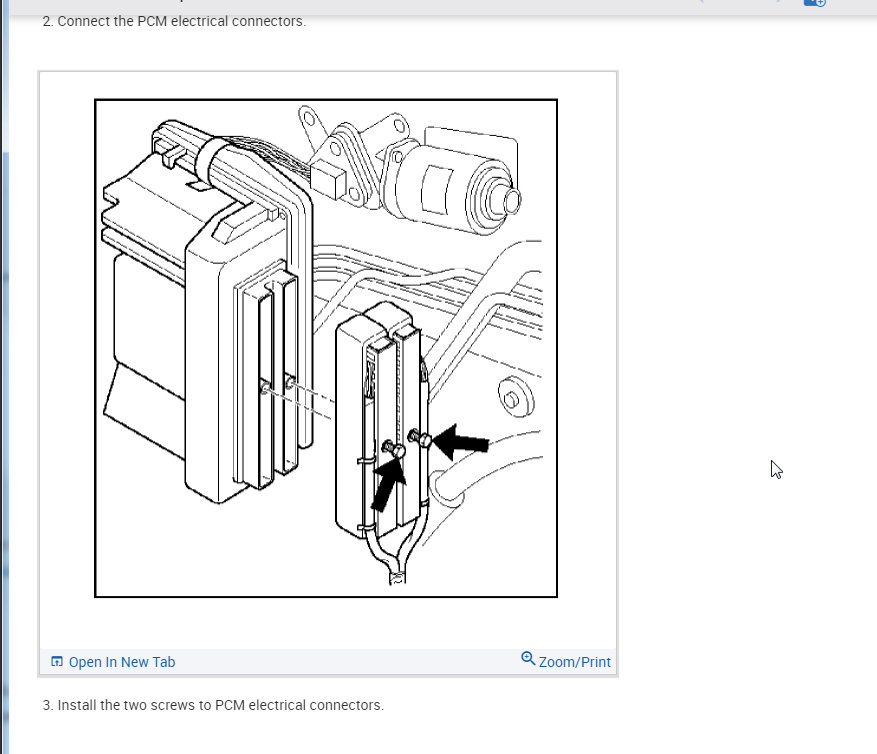

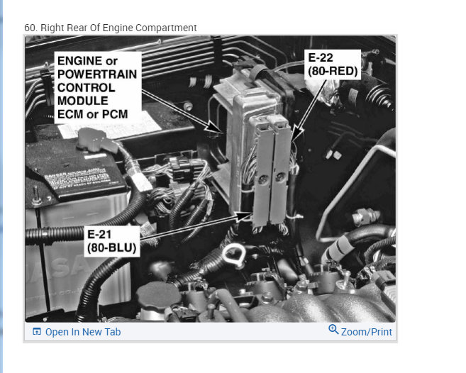

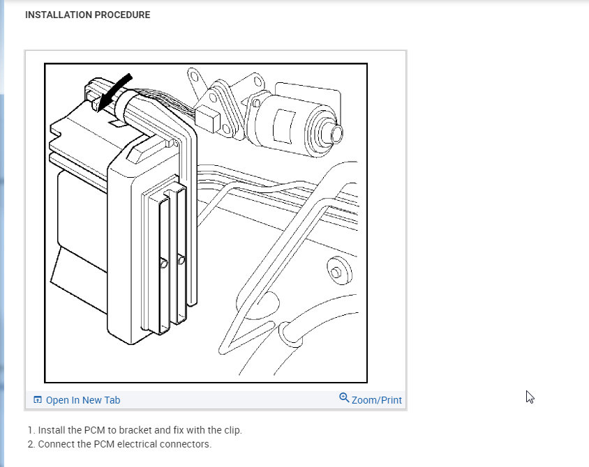

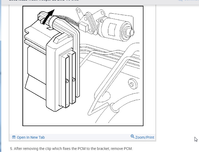

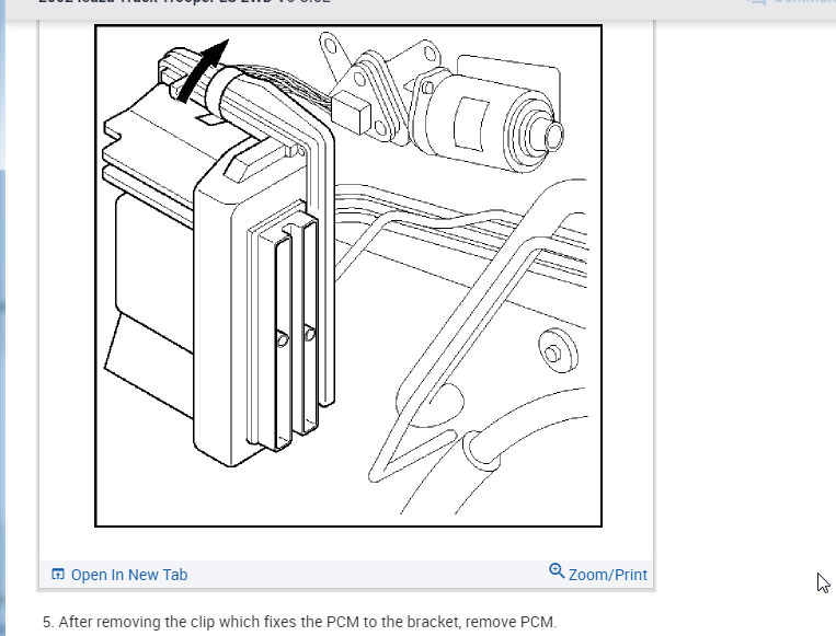

Where is the ECM located and how do I replace it?

I attached the location and process for your review. Let us know if you need more info. Check out the diagrams (Below). Please let us know if you need anything else to get the problem fixed. Thanks
