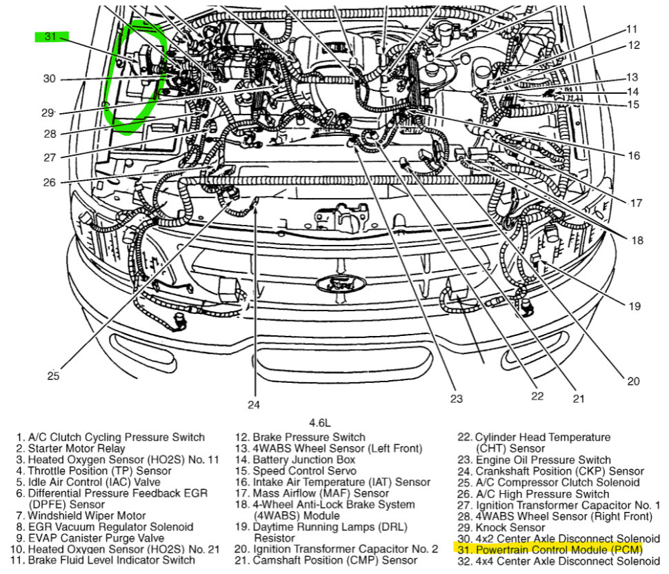

ECM location needed.
Mar 2, 2022 at 11:04 PM
AL514
Experienced Mechanic
5,696 POSTS
Hello, here's the ECM location. Do you need any specific diagrams for the ECM? If you need any other information, i.e., ECM pinout diagrams just let us know...

Thank you so much.!!!
