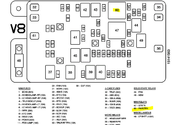

The check engine light came on so I put it on my own diagnostics tester, the code for the throttle body came up so I replaced it. I drove the vehicle for about 20 minutes and it shut off on me with no warning. I tried to start it back up and I got nothing. The next day it cranked right up and again ran for about 20 minutes and shut off. I brought it to a Chevrolet dealership for service, they put it in their diagnostic test and it came back the ECM and throttle body. They're telling me the new throttle body caused my ECM to fail. My son in law had the vehicle for about 2 years before I bought it from him, and he had no problems with it.

Hello, the TB is new and yes the starter will engage but the engine won't turn over. Yes after I installed the new TB I checked for codes and it was giving the code for the TB and ECM. That's when I took it to Chevrolet and they told me the new TB caused the ECM to fail.

These are the codes it is giving, p0443, p0689, p1682, p2101, and p1516. I know that one of these codes was for the ignition switch but I've already changed that. I included all the codes it is giving because I don't remember which one was the ignition switch.

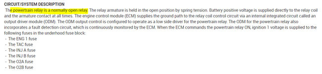

A few of the codes are related to the switch and basically, everything seems to be tied into the powertrain relay. Has it been checked? If not, let's start there.
The relay is in the fuse box under the hood. If you look at the attached pic below, I highlighted the relay. If there is a different relay with the same part number, switch them to see if it makes a difference. If there isn't, here is a link that explains how to test one.

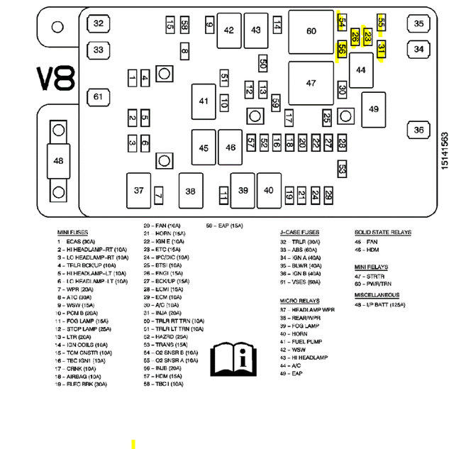

Additionally, I want you to check the fuses indicated in pics 2 and 3 for power when the vehicle stops running. The ECM powers these fuses (via the ignition 1 fuse) when the ignition key is turned on, so I want to know if we are losing a signal from the ECM or if the relay itself is bad.
