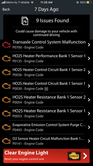

My car has been nothing but problems here and there. To make it short, I recently got the engine light on and I went to a mechanic to fix things. He changed a few sensors (image attached below) that were causing issues and still, the check engine light remained on. Then, he proceeded to saying that the computer or ECM was failing and needed replacement. He has a friend who has the ECM and the necessary equipment to fix the problem but he is not reliable, as we have tried many times but he never shows up. Anyway, before I go and spend thousands of dollars trying to fix issues here and there, I wanted to consult with another mechanic and get a second opinion on whether the ECM is at fault or might be something more severe. Also, from the attached image, the red code is new. I had not seen it before changing the other sensors. Thank you!

I would agree with this only if the testing below has been performed. If not then replacing the ECM sounds like a guess. Clearly we have a circuit issue as it is unlikely that all the sensors would fail at the same time plus if they have been replaced then we need to run through the rest of the testing.
Take a look at this and let's go from there.

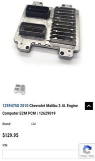

With that being said, I have been spending crazy money since I bought the car with 167,000 miles on it, and now it has 185,000. I have replaced a lot of things and still, I am having a lot of failures, back to back. I don’t know whether to take it to a shop and let me them run another diagnostic before purchasing the ECM, or just replace the ECM to see if that changes anything. $130.00 is to perform the diagnostic and I found the ECM online (refurbished) for about $130.00 and $260.00. What do you think I should I do?

I totally understand and there is no right answer. All I can do is tell you what I would do.
If it were me, I would take it to a shop that I trusted or can run through these tests just to confirm it is an ECM.
Clearly you are going to pay for them to do this but at that point you have confirmation that this is going to fix it. Think about if you just go ahead and get the ECM for $130.00 and it is not the issue then you are going to have to pay someone to look at it anyway.
The only way you come out ahead on this is if we are sure the ECM is the issue and you replace it with the cheaper one and it fixes it. However, there is risk to this just because we are not 100% sure. I am pretty sure that this is the issue but am not looking at it and only have the codes to go on. Again, this is what it appears to be since the sensors have bee replaced but it is a risk.
The only way to minimize your risk is if the ECM is able to be returned if you plug it in and it does not fix the vehicle.

The ECM I plan (maybe) to buy will be programmed using the VIN number and according to the website, it can be returned.
