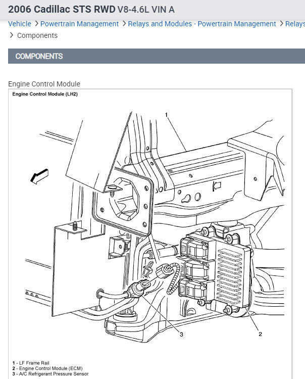

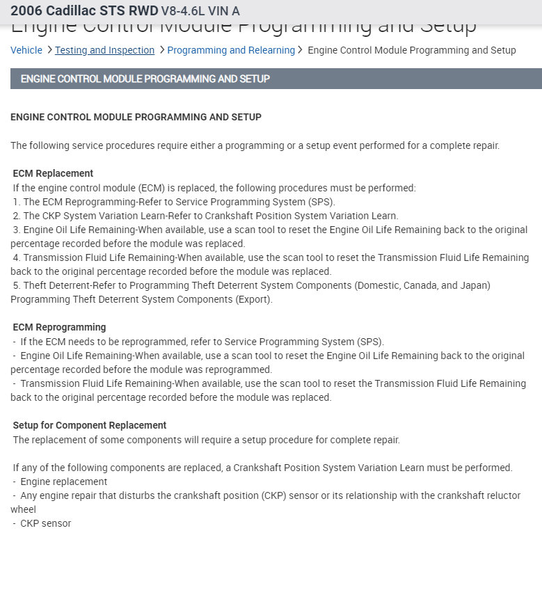

ECM diagram, i need to test.
Apr 26, 2022 at 11:23 PM
SQM
  • 6,383 POSTS

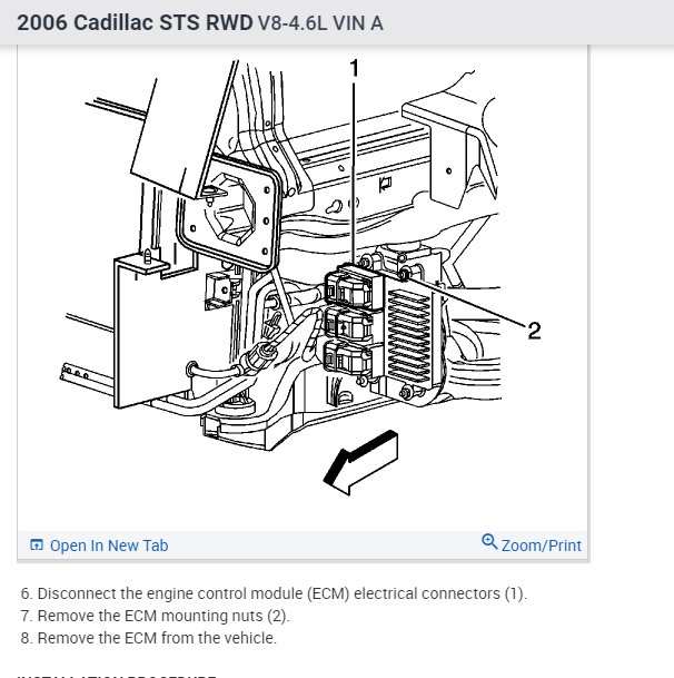

The ECM is located on the left front frame rail.

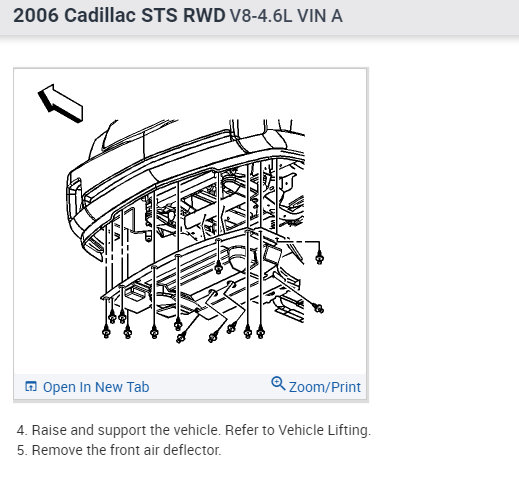

In order to access it you will have to remove the engine splash shield first.
https://www.2carpros.com/articles/how-a-car-computer-works-pcm-ecm-bcm

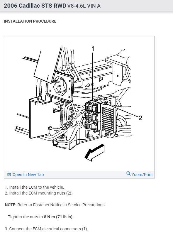

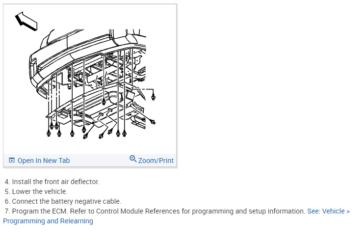

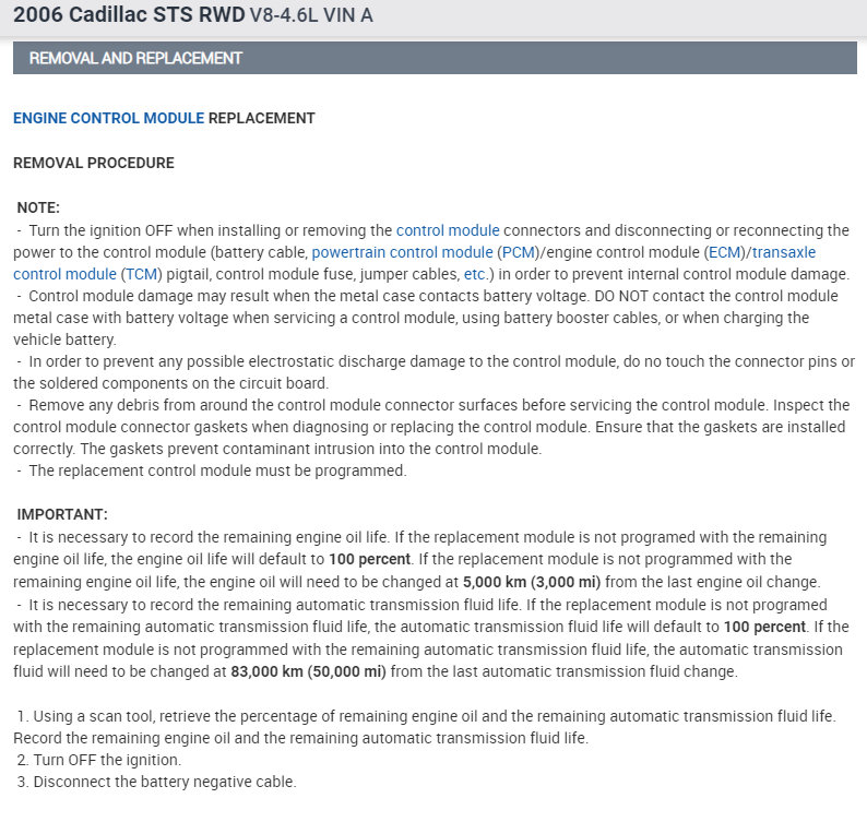

I have attached the location diagram as well as replacement and re-programming procedure in case you will have to replace it.
Let me know of any questions.
