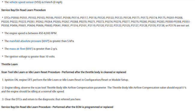

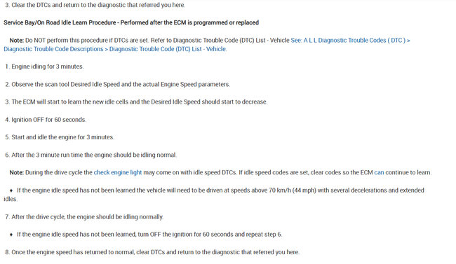

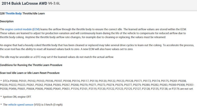

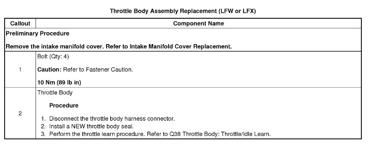

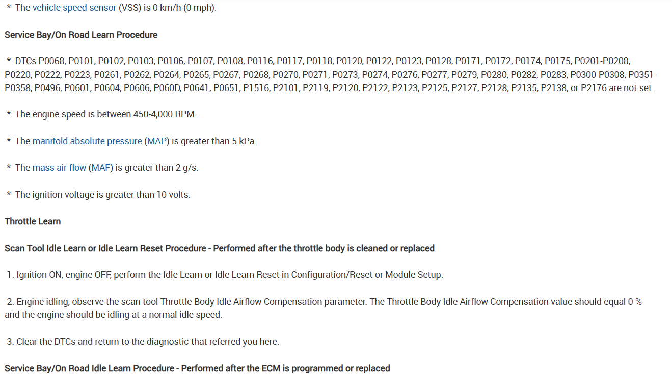

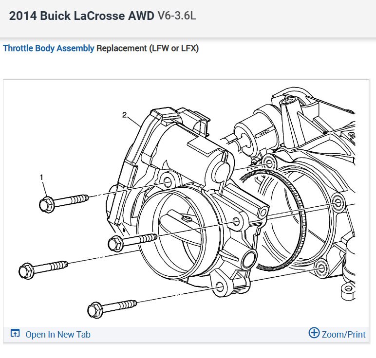

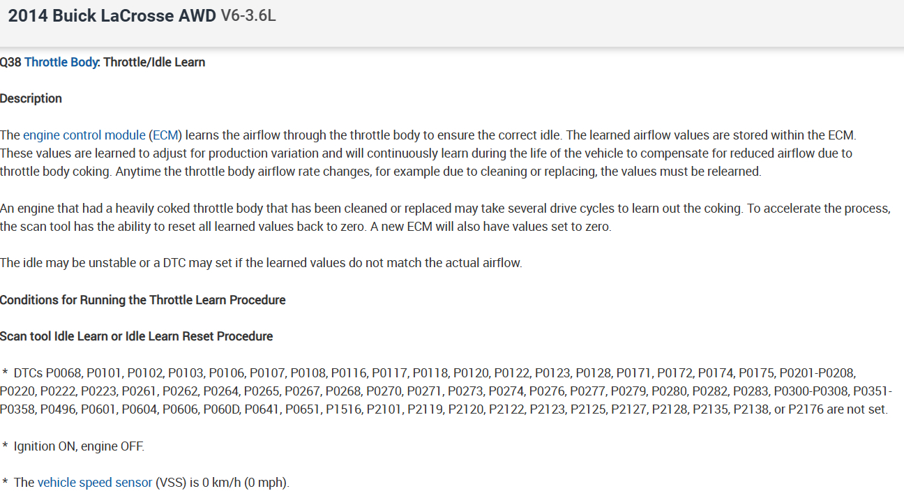

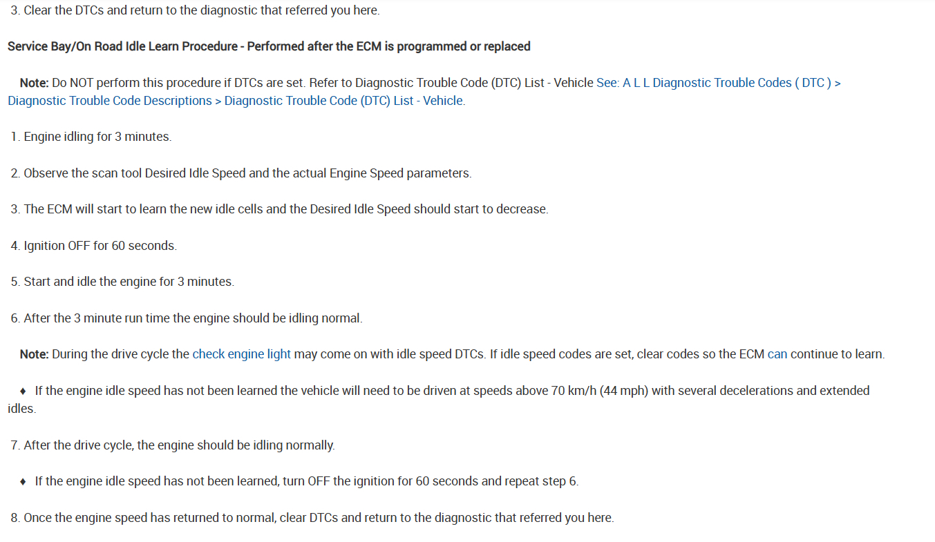

Once the P2119 code has shown up I would replace the throttle body, cleaning it helps but there is an electrical error. I would replace the throttle body and then clear the codes, and the fuel consumption sensor problem might go away, if not be start a new thread for the P0178 code.
P2119 - Throttle Actuator Control (TAC) Throttle Body Range/Performance
P0178 - Fuel Composition Sensor Circuit Low Input
Here is the correct way to replace the throttle body. Clear the codes once completed. Check out the images (below). Please let us know what happens.
