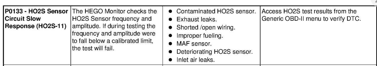

The 153 code is for a slow response from the O2 sensor. In most cases, it is the sensor itself that is the issue.

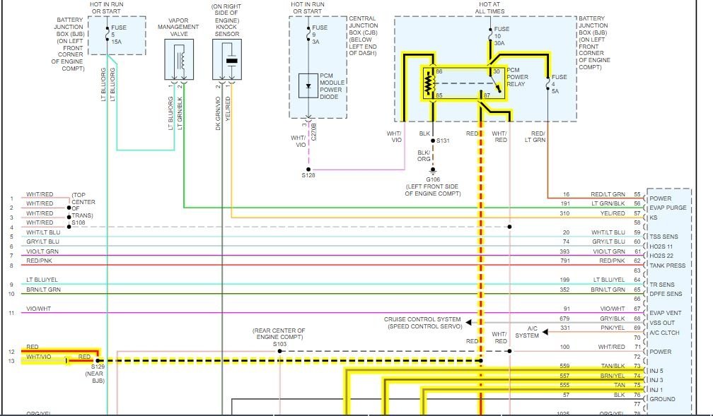

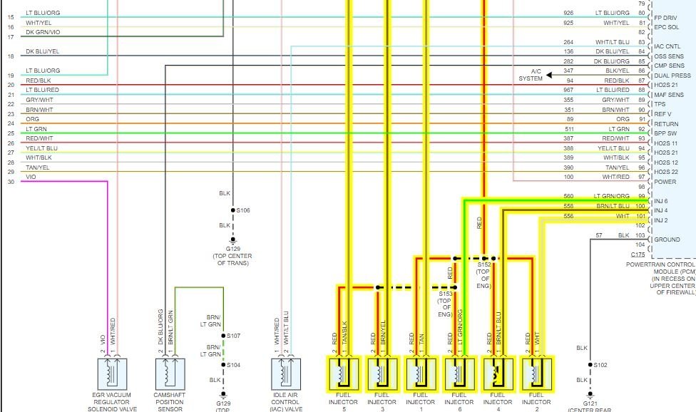

The 174 is a lean condition. This is related to the 230-231 codes. The injectors are not firing due to an electrical failure to the injectors. I would also check the fuel pressure to be sure there is sufficient pressure to the injectors. You can rent a tester at a parts store.
The 220-221 is a wiring issue to the injectors. This could be a wiring harness fault. You need to test power to all the injectors to see where the power is missing.
153
DTC
P0153
Symptom Descriptor
Ho2S Sensor Circuit Slow Response (Ho2S-21)
Probable Causes
Exhaust Leaks
Heated Oxygen Sensor (HO2S) Contaminated
Heated Oxygen Sensor (HO2S) Deteriorating
Improper Fueling
Inlet Air Leaks
Mass Air flow (MAF) Sensor
Wiring Shorted or Open

230-231
DTC
P0230
Symptom Descriptor
Fuel Pump Primary Circuit Malfunction
Probable Causes
Fuel Pump Circuit Open or Shorted
Fuel Pump Relay Damaged
Ignition Switched Power (VPWR) Circuit Open to Fuel Pump Relay
Powertrain Control Module (PCM) Damaged
