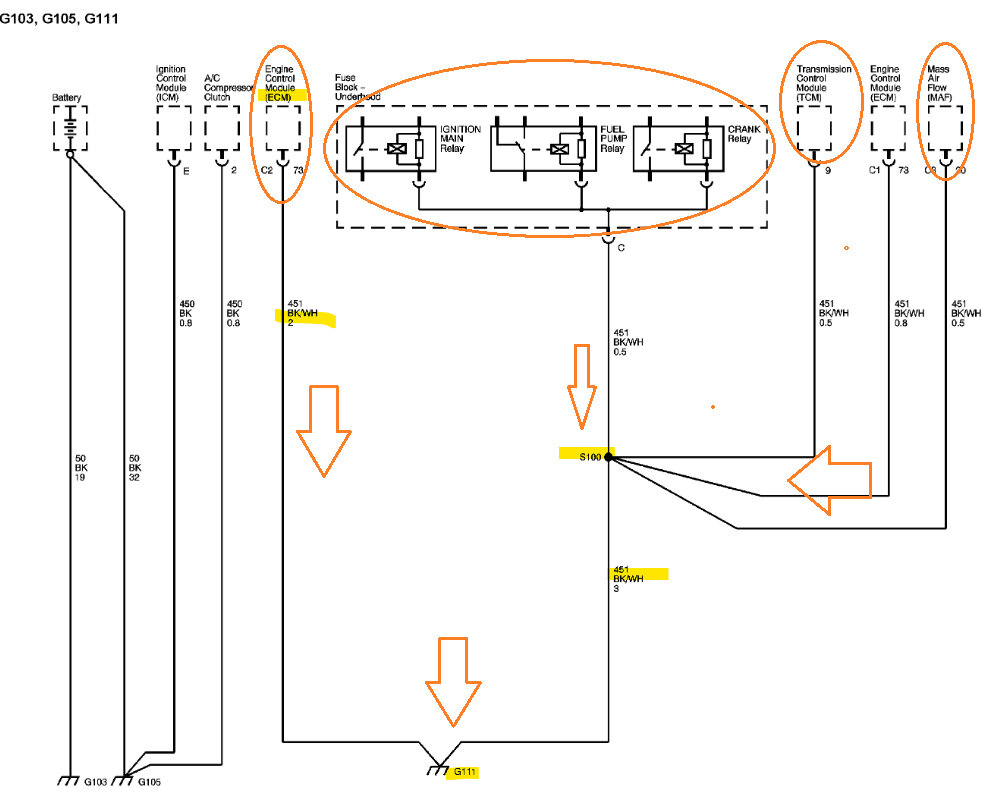

Car won't crank the black/white wire from the ECM leading to where? So, I can replace it. I think it must be the starter or ignition.
Sep 9, 2023 at 4:24 AM
AL514
  • 5,672 POSTS

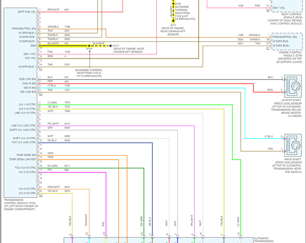

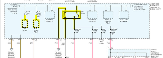

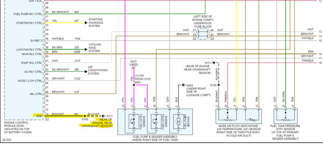

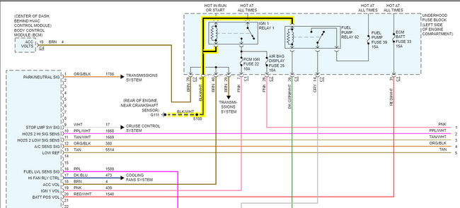

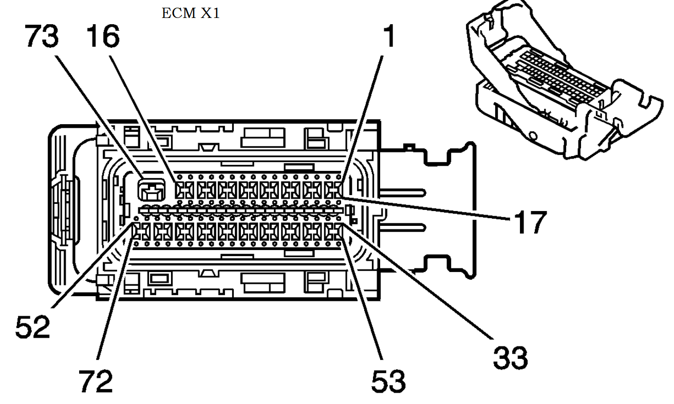

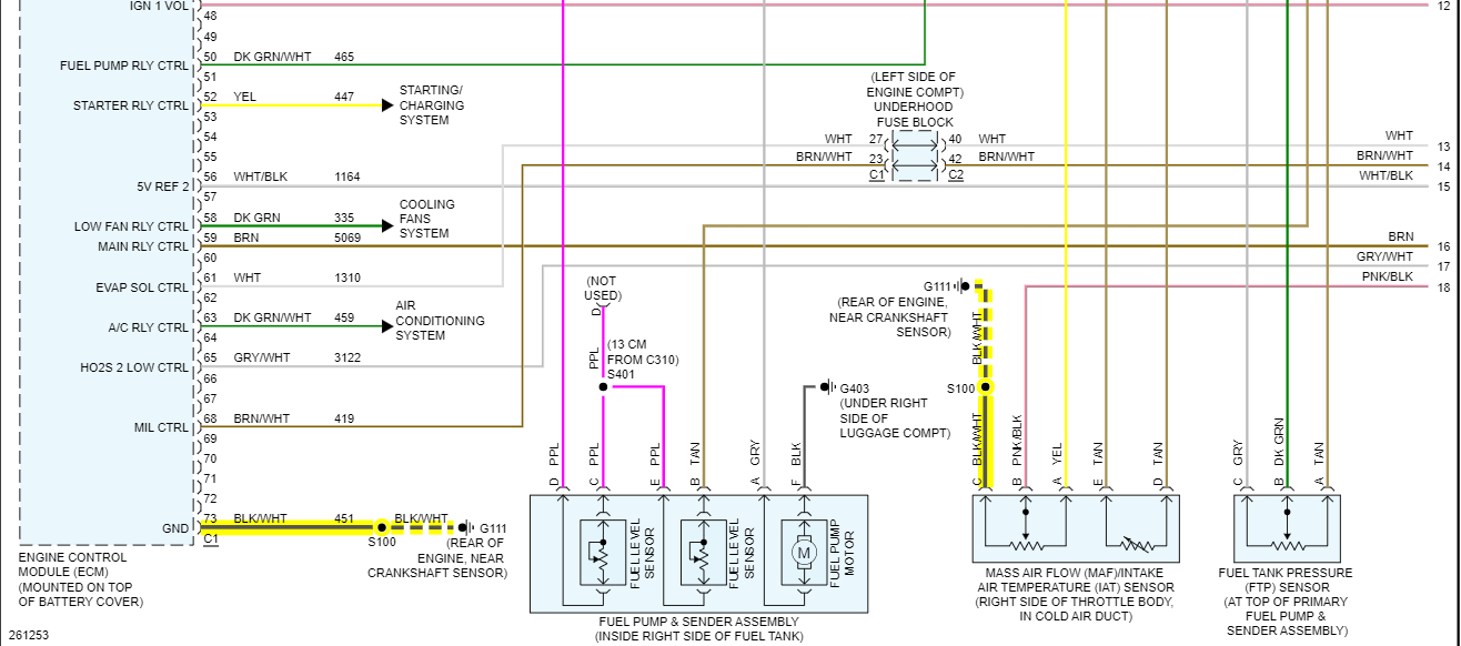

Hello, that wires looks like the only Ground for the ECM. Is it burned up?

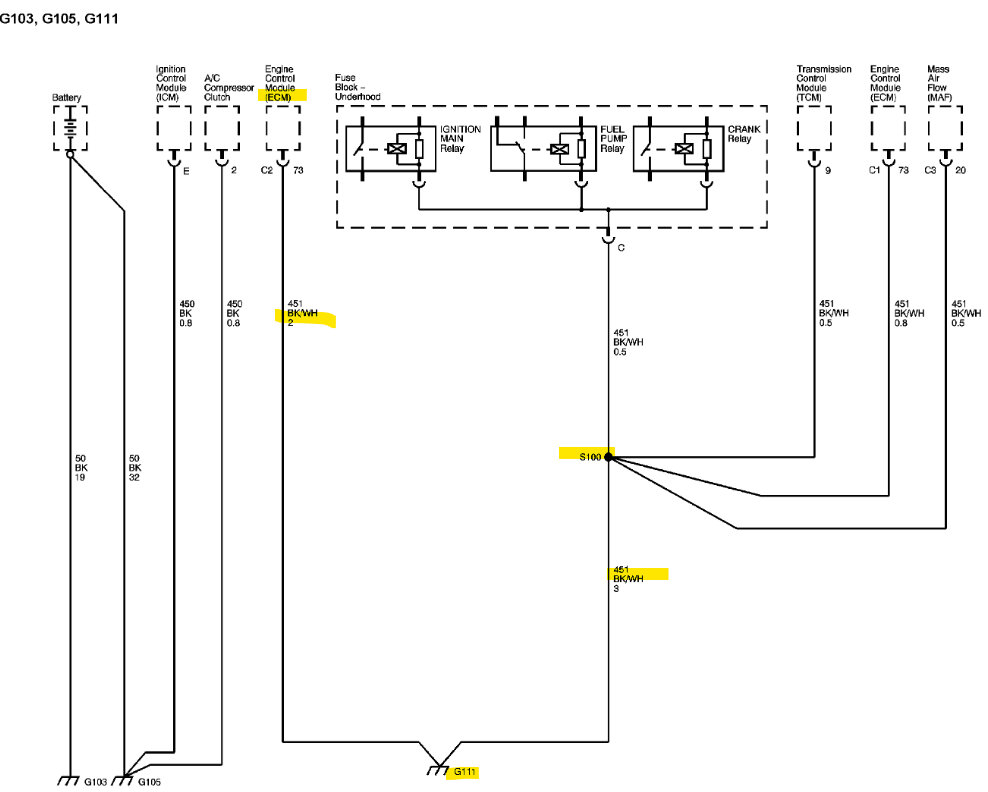

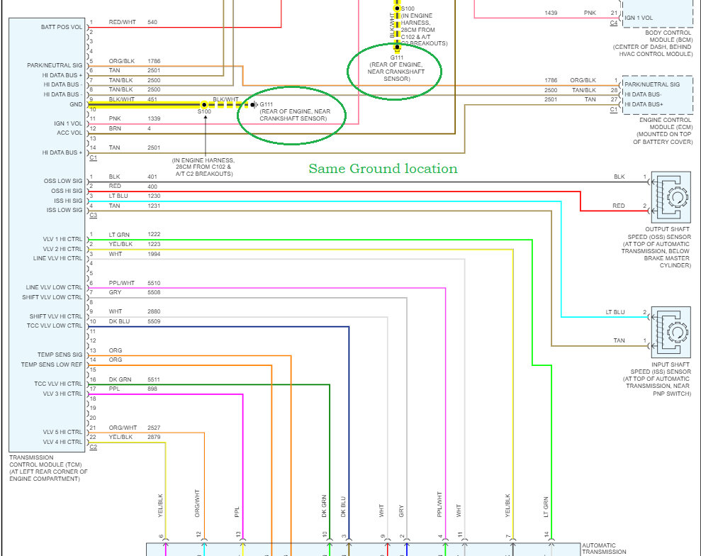

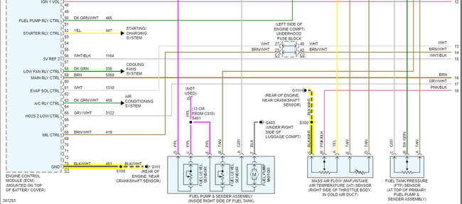

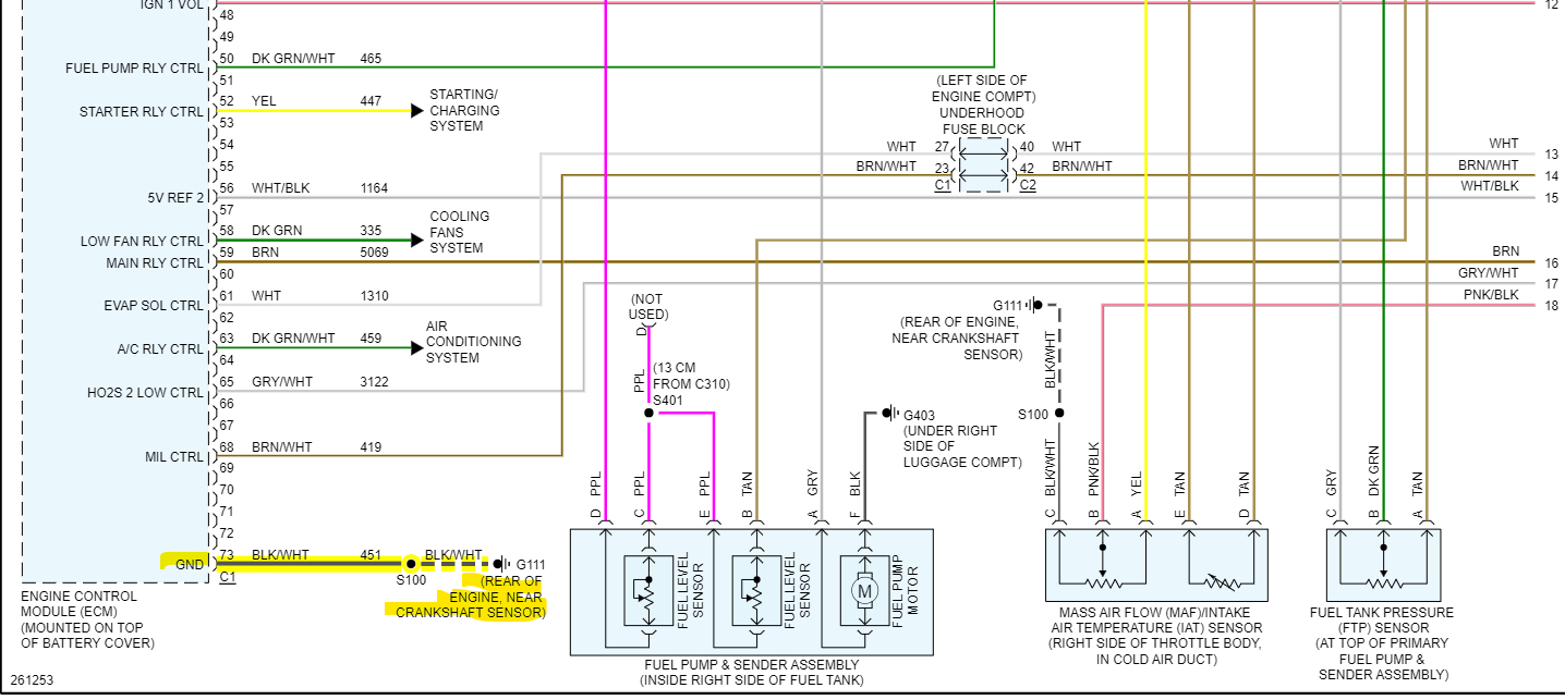

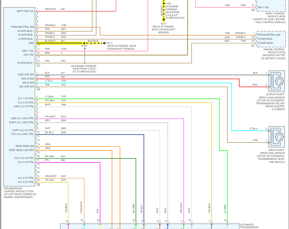

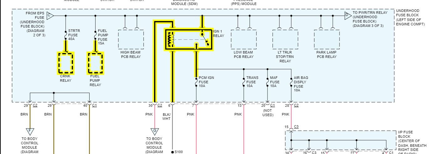

Thats a major Ground for quite a few components, the 3rd diagram is the oem manufacturer diagram it shows everything thats using that ground location.
These are all the components that ground goes to, they all need it to work. The Transmission Control module, Mass Air Flow sensor, Fuel pump relay, Crank Relay, IGN 1 relay, and the ECM.
If that wire burned up, then there is high resistance somewhere or the wire is shorted to power.

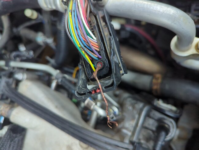

This is the beginning and the intersection of the burnt wire. Now I'm moving underneath to the starter to see if I can find this black/white wire intact or connected to a connector.

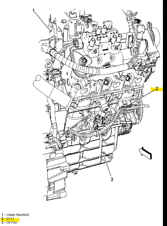

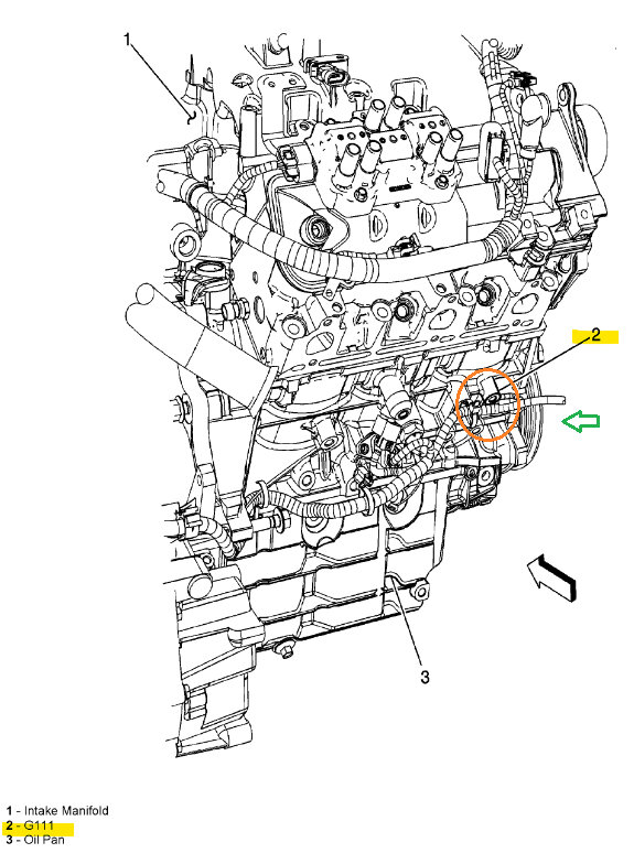

No, the black/white wire runs on the back side of the engine, in this diagram, see the arrow, which is pointing towards the front of the vehicle, so with this engine having the main drive belts on the right side if you're facing the engine, the ground G111 is on the back of the engine block. The green arrow I have pointing at the harmonic balancer (Crankshaft pulley). Thats where the G111 bolts up to,
But before you attach the ground back to the engine block, I would verify with a multimeter that there is no voltage shorted to that wire. Set a multimeter on DC volts, 20v scale and check to make sure it's not shorted to anything. The wire didn't just burn up for no reason. Something caused that.

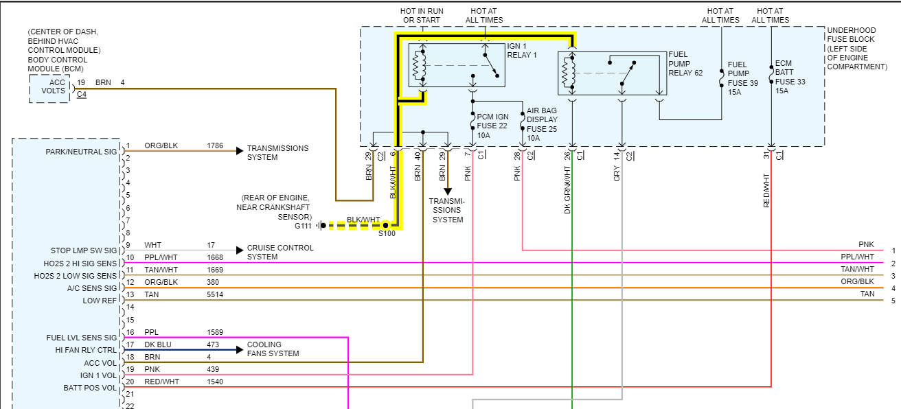

AL514
  • 5,672 POSTS
Yes, that's the same black/white wire that the ECM is using for a ground. Refresh this page and look at my last post.
Sep 9, 2023 at 10:27 AM
AL514
  • 5,672 POSTS
It's on the backside of the engine, near the crankshaft position sensor. It's not a power or communications wire, it's a Main Ground wire for a lot of important components.

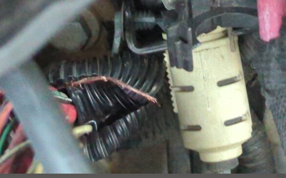

Overheating issue, was the wire laying on something that got hot? I was more concerned with something having shorted out and causing too much current flow on that wire, such as if a 12volt feed shorted to that ground wire and burned it up. Technically that must have caused a blown fuse, but some direct power feeds coming off the battery positive are not fused until they get to the fuse panel then the power runs out to components. Since the Mass air flow (MAF) sensor ground looks intact, you could check the resistance from that black/white wire to battery negative and see what you. There should be very low resistance. Although this is not the correct way to test a wire, it will tell you if the wire is an open circuit somewhere. Because there are so many components using this ground, it would be good to check the wire from each component to battery negative. Where exactly is this wire damaged? Right at the ECM? It looks like it's missing a lot of insulation in a couple of those pictures.

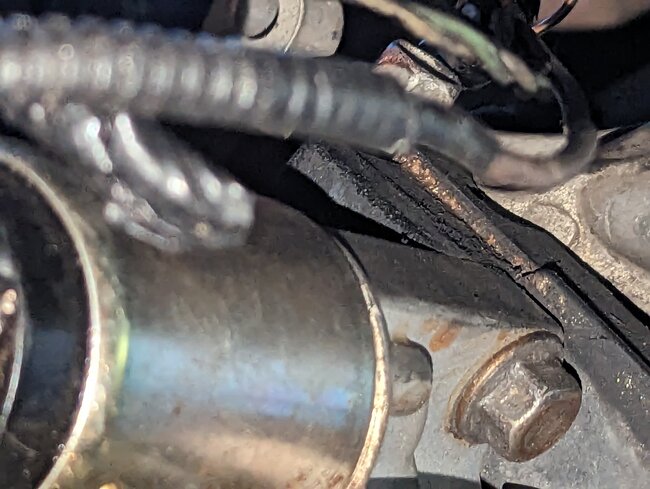

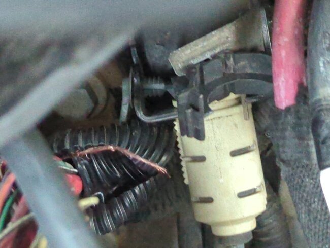

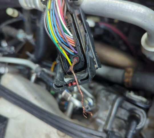

These 2 pictures are very concerning, what is this connector in the 1st picture? That is going to be difficult to repair being that the insulation is missing all the way up to the connector pin. And the 2nd picture, why is the wire bare inside the conduit? I can try to locate the connector in the 1st picture, and I assume the 2nd pic is close to the battery because I see a large red cable next to it. If the 1st pic is a connector in series which is just a section of harness that disconnects, you could bypass the connector at least for the Black/White Ground wire. Or you will have to de-pin that wire and try to repair it, which will take a lot of time. So on the other side of that connector, you should have the same wire with its insulation on it, and you could cut the other side, put a crimp weather seal butt connector on it and run a wire around the bulk connector bypassing it. Unless that's the ECM connector I'm looking at.
As for the 2nd pic, It's tough to tell what I'm looking at there. Is this down on top of the transmission? and is the black conduit melted too?
Sep 10, 2023 at 2:25 AM
MICHELESAZ
  • 8 POSTS
Yes, the connector is on the left side of the ECM. The second picture is just where that harness separates into a "Y" goes 3 separate ways the wire is bare at that junction. I wasn't sure which direction it would be going. I'm looking for a place to splice the wire back together. I am very sure that I caused that wire to come in contact with the positive battery post/cable while moving it off the top of the battery directly on top of the battery. Or I shorted it out touching something else the car continues to boil water out of the overflow bottle. This time I made the issue bigger by shorting out this wire. Now of course even when it cools down and gets more water it won't start so I can see how my overheating issue is progressing. I am definitely in the novice stage of my mechanic career. I am still teachable, when I'm not being stubborn. I'm getting back on this project in the morning. I'm sure you will hear from me again.

Yes, that Ground wire will splice in a few locations because of all the components that use it. If you are still getting coolant boiling out of the reservoir, its sounds like you have a bad head gasket, You can verify this a few different ways, in the morning when the vehicle is cold, open the radiator or reservoir and start the vehicle, if you see bubbles coming out of the coolant system, that is combustion gases escaping from the cylinder head from either a bad head gasket or a cracked cylinder head.
Auto parts stores also sell a chemical head gasket testing kit that's not too expensive, it has a funnel type container you put in the radiator or reservoir opening and you add a chemical agent, and it will turn a certain color if combustion gases are present.
If this ground wire is burned up, I would concentrate on diagnosing the head gasket first, because it might cost more to fix the cylinder head or replace the gasket than the vehicle is worth. And I can see why it wouldn't start, with a ground wire like that, I wouldn't be surprised if there were blown fuses as well. Current flow from battery positive on the ground side has the same effect as hooking up a jumper cable backwards. There might be multiple failed modules at this point.

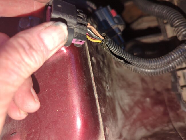

I spliced the ground wire back together. It took me a while of carefully separating the Insulation on the wire harness to finally find some solid wire with insulation still attached, I would say about 16 to 20 inches of the wire was pretty brittle. And here's what happened. The Equinox started right up. I am over the edge with happiness at this moment. I have some work to do the harness will have to be re-wrapped (I didn't remove any of the cable ties) Opinions are that the head gasket is fine but possibly I with next exhaust gaskets. I may still have overheating issues. I feel like the oil smells very much like gas. The air conditioner is immediately ice cold, and I must say the motor is purring. There is still much life left in my little Equinox. So, for right now I am just going to enjoy my successful splicing of that ground wire. I couldn't have done it without your advice and knowledge. Thank you again. I'm sure I'll be back with more questions or a follow up with a happy ending. All is well.
