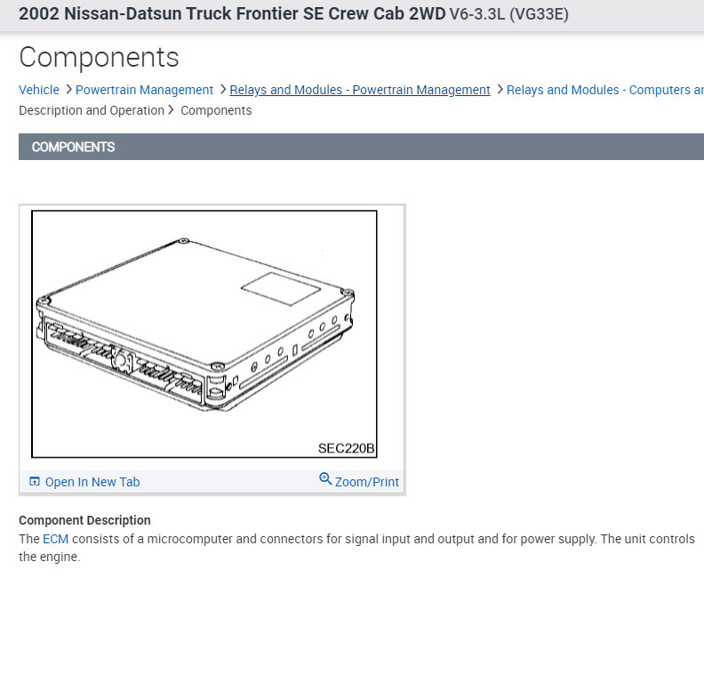

How do you reset the ECM?
2002 NISSAN FRONTIER
226,267 MILES • 3.3L • V6 • 2WD • AUTOMATIC
PANELA LEAAETOA

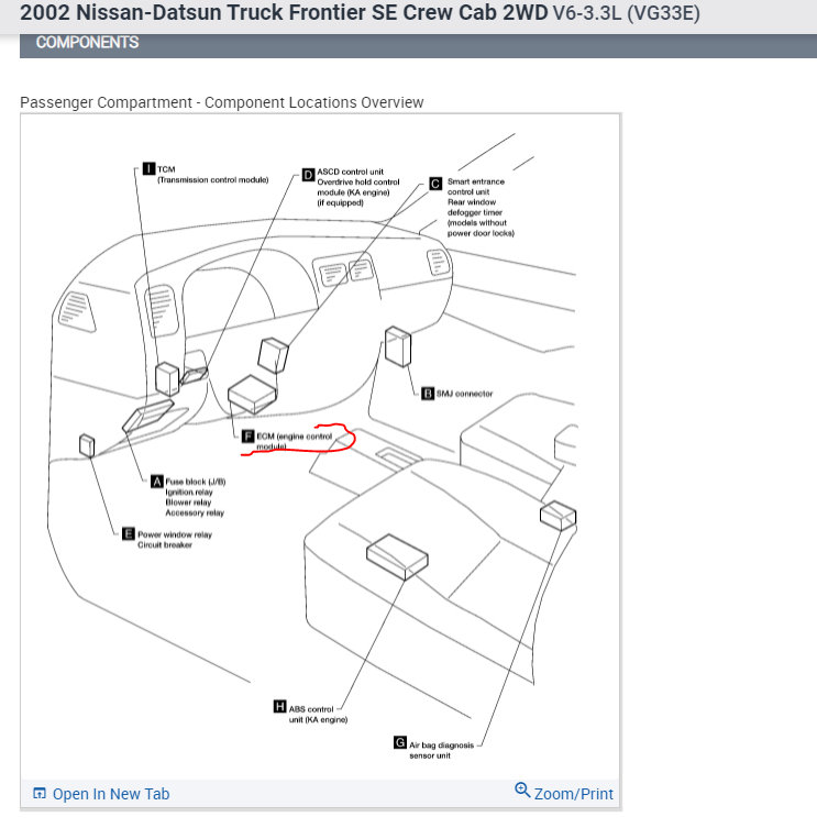

And where is the switch location of the ECM?

The ECM is located under the dash, just right of the gas pedal.
If the ECM just needs to be reset, you will have to go through a procedure. Some of these can be done manually, others will need a special scanner.

First, your English is excellent. However, what you are asking doesn't exist. There is no ECM switch.

As far as the ECM, it is basically a computer module. It runs based on programming from the manufacturer. It can be what is called "flashed or refreshed" but that will require a scanner that can perform the reprogramming.
If nothing was done with the ECM, it should be fine.

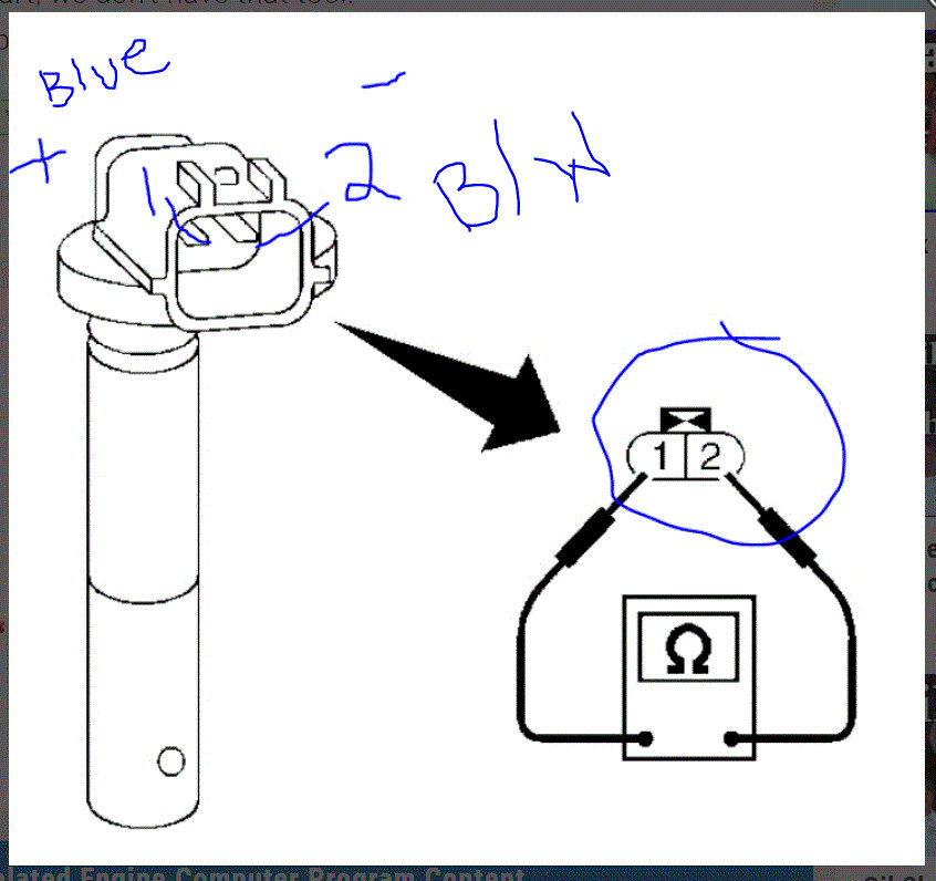

Last update, I was told that the spark was weak. Found the crankshaft sensor not connecting. We have a new sensor, but we also need the harness connector. Got the connector. Now we don't know how to connect the connector and sensor. the color wire of the connector is both black we don't know which one goes to with what? please help.

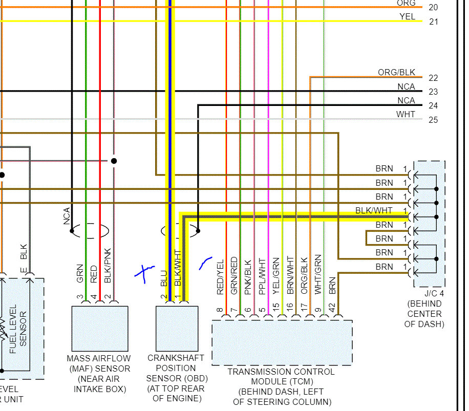

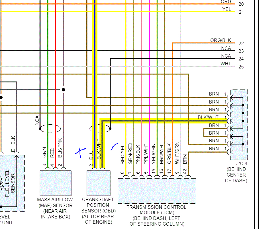

I attached two pics below. The first shows the sensor wiring. One wire is blue, and one is black with a white tracer.
If you look at pic 2, it shows which pin is number 1 and number 2. When you wire the new connector, place the blue wire to pin 1 and the black/white wire to pin 2.
The black/white wire is a low reference wire that provides ground. The blue wire is a signal wire.

We need help in connecting the engine room harness from a 2001 Nissan Frontier to a 2002 Nissan Frontier. I am still having problems understanding or reading the wiring diagram, I mean if it being explained from somebody else, I probably would have more understanding of it. Confusion with the colors and different types of white stripes being solid to spaced, and no white stripes. Noticed that day 2001 harness has more wires than 2002, so I don't want to be connecting the wrong wires.

Just to jump in on this. Are you looking for a way to understand how to read the wiring diagrams or are you trying to understand why they are different?
Basically, the way you read these diagrams is you find the connector that you are working with on the vehicle and then match that up to the diagram and it shows you where the wire goes. Then you locate that connector, and you will find the same wire in that connector.
However, if you are trying to use a wiring harness on a different vehicle that is not the same then you are going to spend more time re-wiring the replacement harness than it is worth.
You are going to have to remove any wires that are not used on your vehicle and add those that are, and the wiring colors will never match up because these are different harnesses.
So, if you want the wires to match on these different harnesses then they never will.
I think the best suggest we can make is not to use this harness and use one off of the same vehicle you have.
If that is not an option, then you are going to have to add and remove wires to this harness to make it the same as what you have but that is a very large and confusing project.
