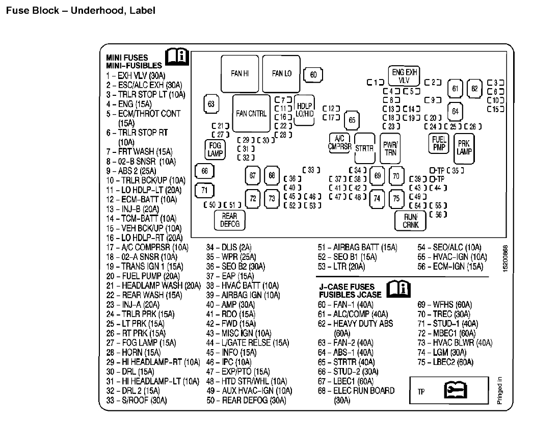

The engine will not crank after replacing the ECM?
2007 CHEVROLET TAHOE
145,000 MILES
LARRY1974
  • 6 POSTS
I bought an ECM for my vehicle one came it was defective, I had already turned in the original one as a core. So, I went and bought a used one which was for a Yukon Denali, however it was no good. I ordered a programmed one using the serial and model number off the used one I bought, it's communicating but when I turn the key it won't turn over.

You mentioned you ordered one using the part number from the one purchased that was bad. Is that correct? Or did you use the part number from the original ECM?

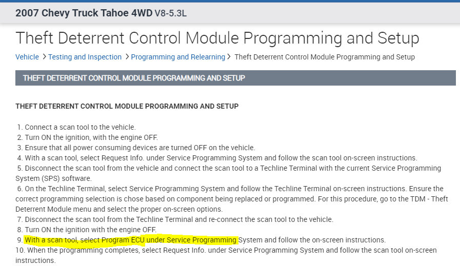

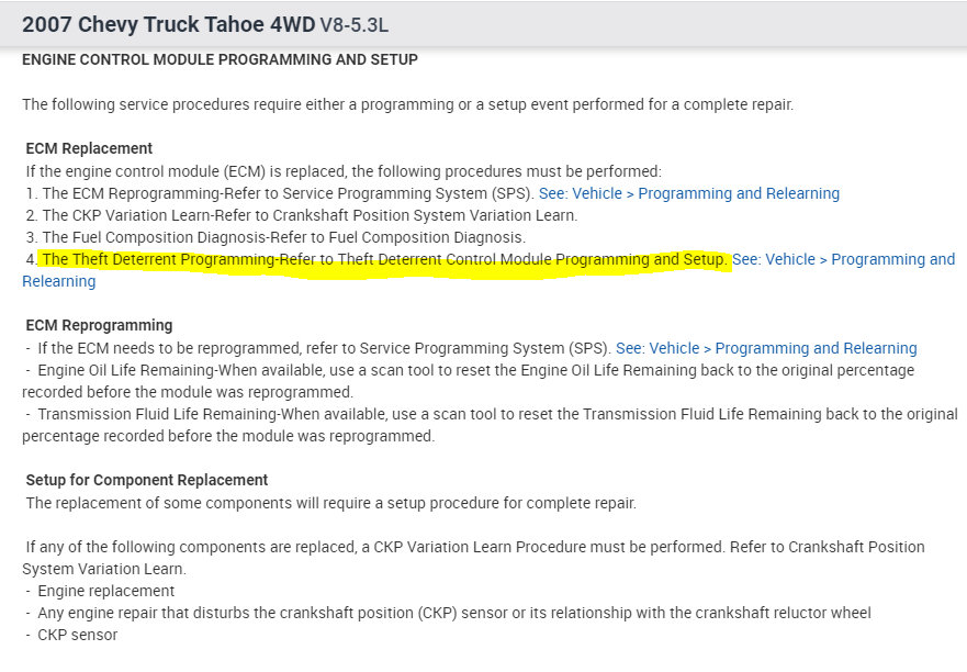

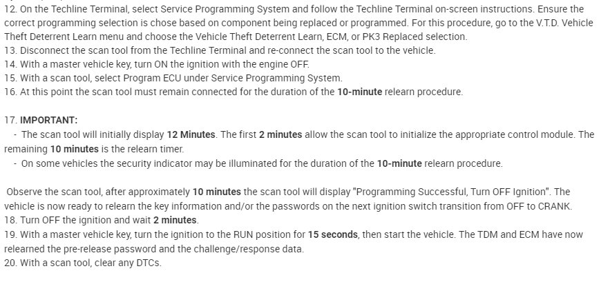

I need to know if the present one you have was programmed prior to installing it. The one thing I question is if the antitheft was programmed correctly. I don't know if they can do that off-site.
I attached the directions for reprogramming the theft deterrent module. It has to align with the new module you installed. The last pic is specific to the ECM.
Let me know if you have questions.

  • 55,433 POSTS
When you try to crank the engine over does the security light flash? If not, you could have a starter relay that is bad, also can you try to crank it over in neutral and do the gear selector lights work?

LARRY1974
  • 6 POSTS

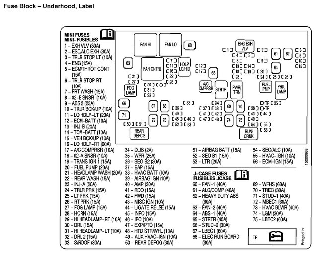

Okay, I took it to the dealership, it was a fuse blown caused by two wires which had to be repaired, however after leaving, it cut off, it started back but was hesitant to idle at first, then it cut off again. It started right back. The truck sat for 6 years, and I've replaced everything, transmission, TCM, ECM, lights, calibers, brakes, rotors and all with exception to a fuel pump. The only code is check engine light on because of evap system. Any idea?
Aug 16, 2022 at 7:41 AM
