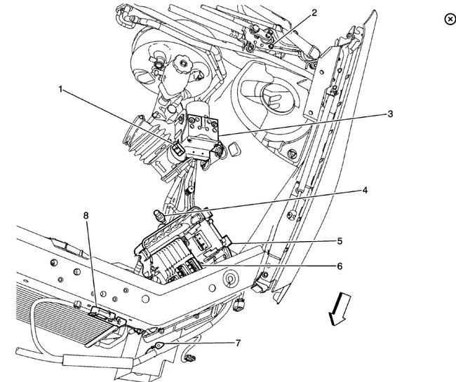

Location of ECM.

Hi Andre,
Here is the location of the ECM-PCM which is under the hood. Check out the pic below.
1 - Mass Air Flow (MAF)/Intake Air Temperature (IAT) Sensor
2 - Windshield Wiper Motor
3 - Electronic Brake Control Module (EBCM)
4 - A/C Refrigerant Pressure Sensor
5 - Transmission Control Module (TCM)
6 - Engine Control Module (ECM)
7 - G101
8 - Inflatable Restraint Front End Sensor - Left
Please let me know if you need anything else to get the problem fixed.
