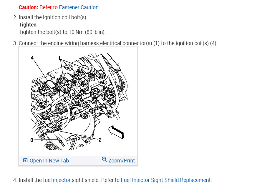

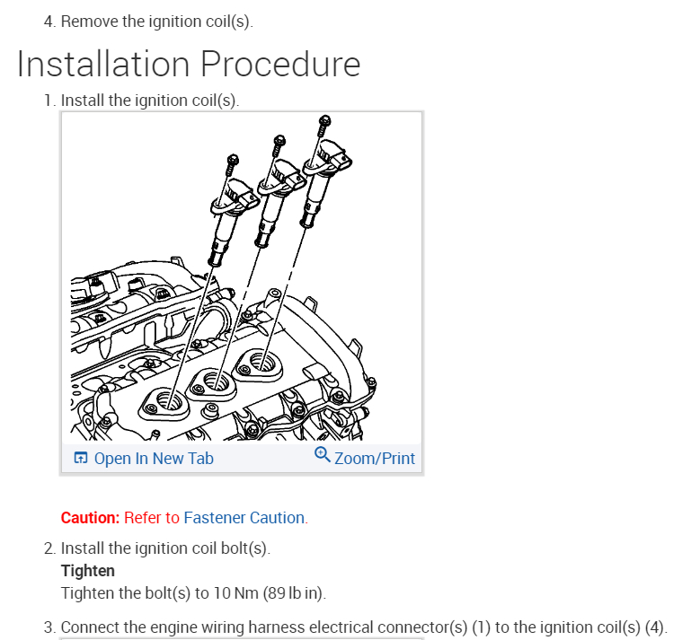

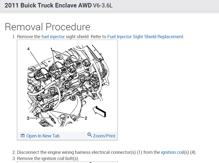

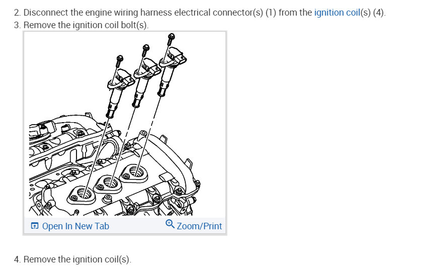

Nice work, here is how to change the coil out. Check out the images (below). Please let us know if you need anything else to get the problem fixed.
