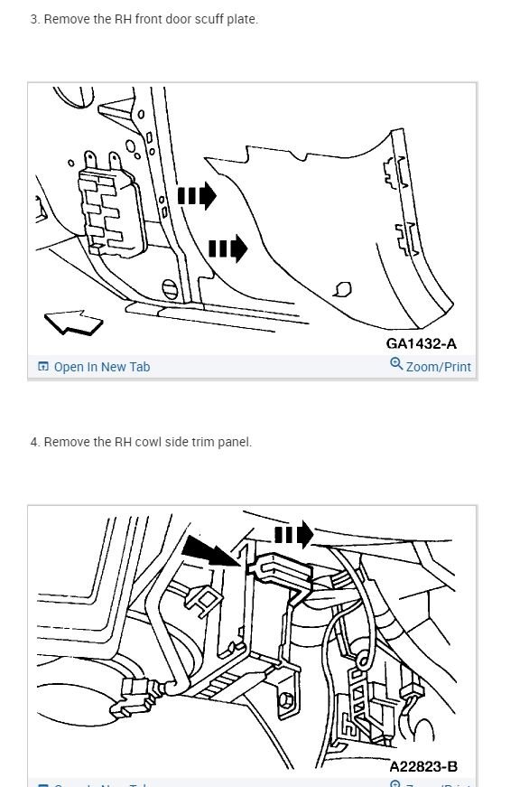

Where is the ECM located?
158,000 MILES • V8 • 2WD • AUTOMATIC
TRACEE MORROW
My Ford expedition is running very rough, especially until it warms up, which takes about twenty something miles it seems. A gentleman tried to check my vehicle, but it wouldn't check, he said my ECM might be blown and for me to find out where it is on my SUV. I have checked YouTube Google and everything else and you're the first one that came close only you were talking about a Chevrolet can you please tell me where the ECM fuse relay module whatever it may be is located? Sorry, I don't know the leaders. You have been the most helped so far and you have an even answered my question please respond. thanks, Tracy
Jan 17, 2022 at 8:13 PM
Good morning,

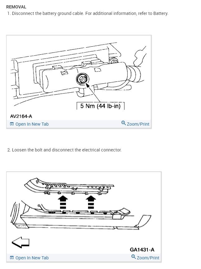

I attached the procedure and location of the ECM for you. The wiring connection is under the hood and the actual unit is under the dash driver's side.
