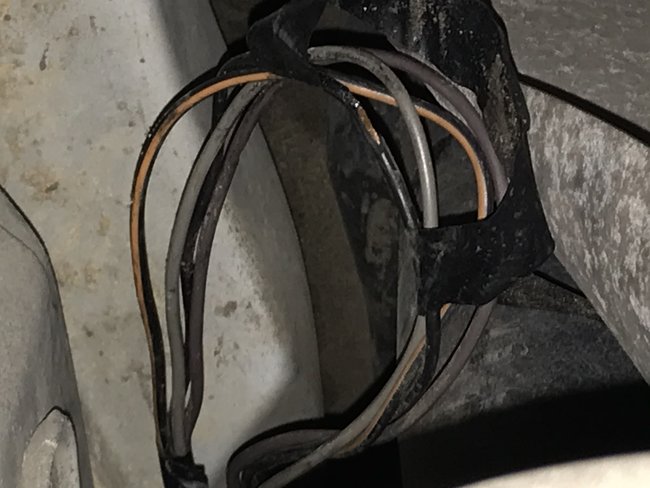

Sorry for the novel, lol. I bought the vehicle listed above LS has almost 175,000 miles at the beginning of this year. Few weeks ago, had a p0200 and p0303 code and flashing SES light so replaced #3 spark plug and wire and replaced full spider injector with a remanufactured one from AutoZone along with the necessary manifold gaskets and the distributor cap. Codes cleared and she drove great. Few days ago, check engine light flashing again went to AutoZone around the block they ran codes got P0200, P0306, P0128, P0102. Driving home stalled out so started checking basic stuff found a blown 15a ECM 1 fuse. Replaced with another one cranked engine and blew another. Did that couple other times keeps blowing ECM 1 fuse. Unplugged spider fuel injector connector at the intake manifold and cranked the engine and it doesn’t blow the fuse. From my understanding this year of the blazer only the injectors, their connection components, and the senders or what not from the ECM are on this fuse and circuit with nothing else like the fuel pump or fuel relay tied into it. I read to test for 12v on the pins at the fuel injector connector and injectors or to look for open grounds or faulted injectors but wasn’t sure how to test injectors if negative terminal is disconnected before removing everything to access the injectors under the intake manifold. Wouldn’t that not do anything with no power to the vehicle? Also noticed no gas comes out of the little bleed valve on the gas lines. Not a mechanic by far but can’t afford parts and labor right now and can’t afford to keep replacing things that are most likely wrong. I can only buy basic testing tools, but I have tools to fix stuff or can get loaners and I’m pretty capable of repairing things so I’m trying to see if someone can please point me in the right direction on what to replace because I can’t pay bills when I can’t get to work. Is it possible it’s the remanufactured spider I just installed or can I rule that out cause supposedly it’s up to spec for reusing? Apologies for a question as long as the Nile but I’m just trying to put as much details in there that I can think of to help make answering easier.

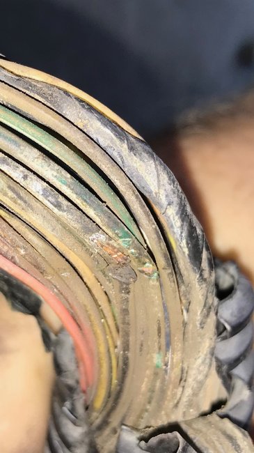

Chased the wires from the ECM 1 circuit found some damaged and completely exposed down at the exhaust.

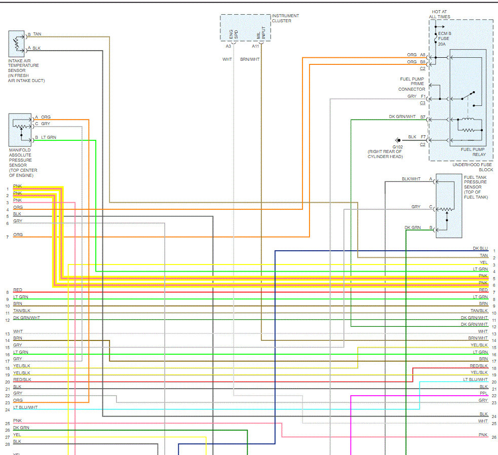

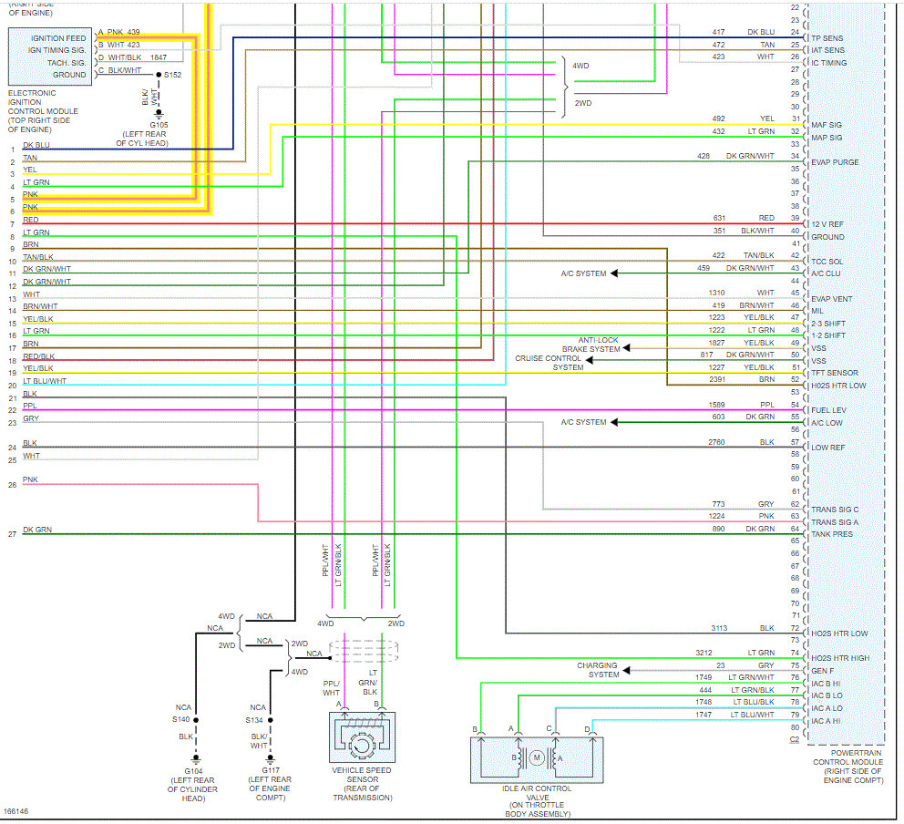

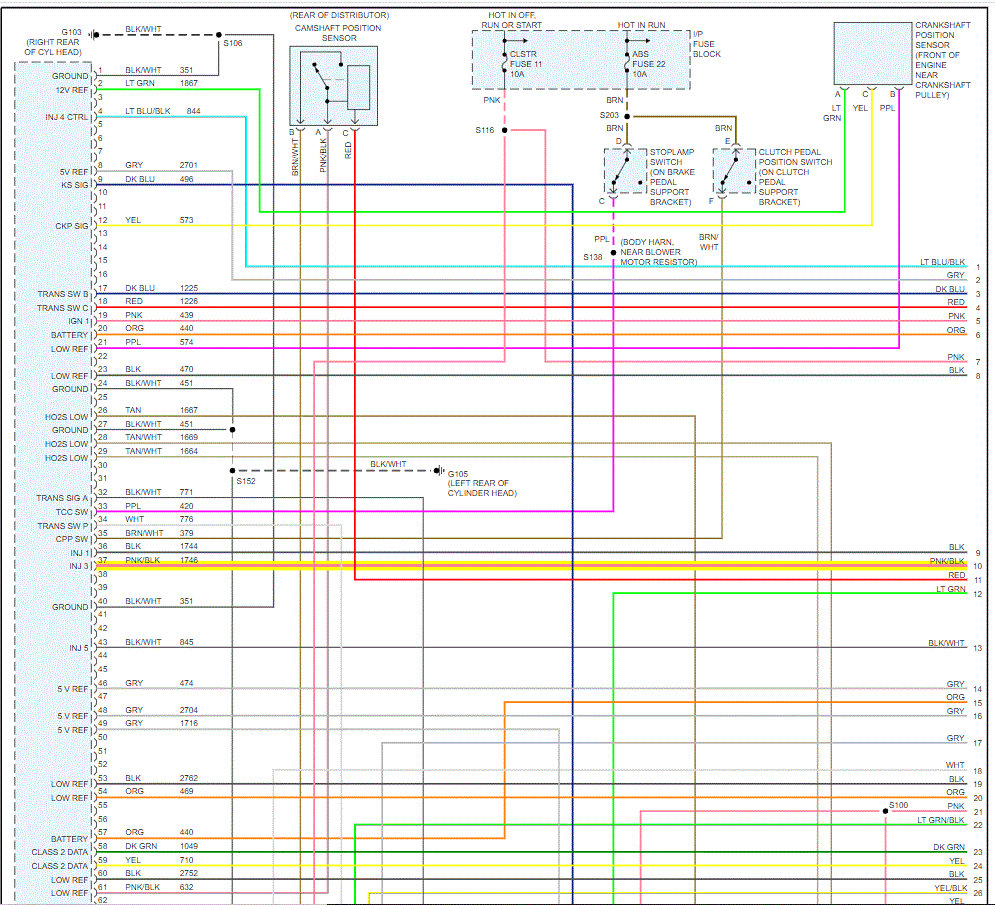

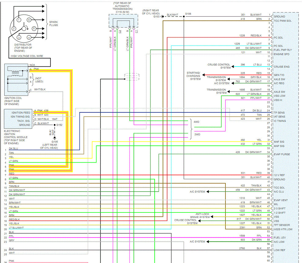

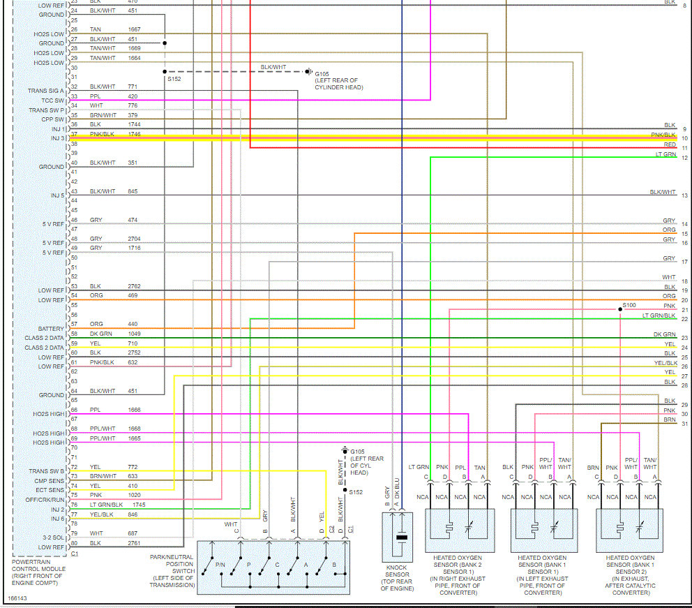

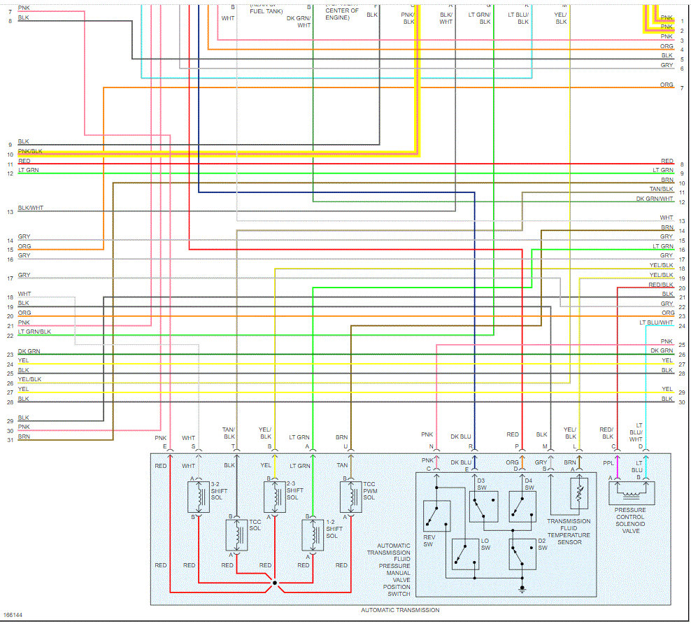

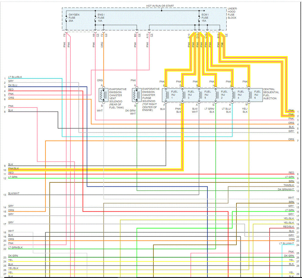

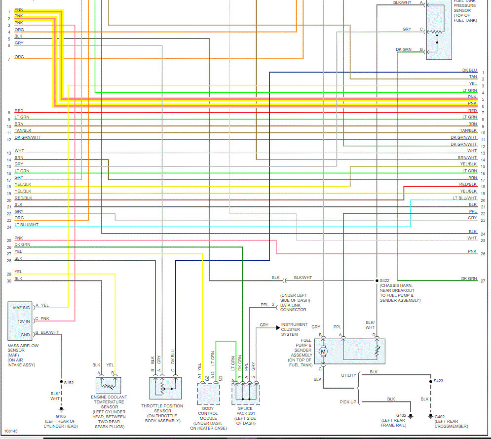

If you have exposed wires, it sounds like you found the issue. If you look at the pics below, I included the entire wiring schematic for the powertrain management. I highlighted the ECM 1 fuse and the wiring to the injectors and from there to the ignition control module and the distributor. The injectors have wires going from them to the PCM. I didn't highlight them.
The wires you found, what color are they? Are they pink by chance? If not, let me know what they are.
Based on the P0200, I would first suspect there is a short at one of the injectors. Disconnect cylinder 3 and cylinder 6 (one at a time) and see if the fuse still blows.
Here is a link you may find helpful when testing wiring:
Let me know if the fuse still blows and the wire colors that are damaged.
See pics below. Note: I had to cut each of the schematic pages in half to make them readable for you. I did overlap each page so you can follow from one to the next. Use this to trace the wires you found which are damaged.

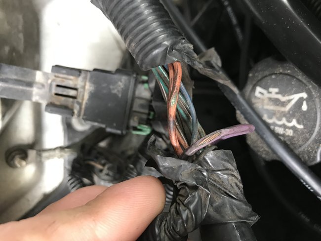

Hi Joe! Thank you for the Info and schematics. The wires I found were green and a black one with a white stripe. Fixed those but still won’t crank. I also found a damaged black one around the fuel pump connector area and a purple one on the set of wires that goes to a relay near the A/C components (the harness running at the top of the firewall). Haven’t repaired them cause had to work yesterday. My maintenance man who’s a part time mechanic briefly looked over it and said what’s weird is the female ports on the harness injector connector shows 12v on the grounds of all 6 sets as well as at the ECM 1 fuse and a few other fuses just can’t remember which ones and when that’s disconnected and the I crank the engine it doesn’t blow a fuse so I’m wondering if it’s not the damage wires but something with the fuel injectors themselves. But would a new refurbished one do that as well or is there something shorting out the spider injectors possibly? I am financially already pinching pennies can’t afford mechanics labor too. I’m missing work trying to figure it out and when you remodel homes a vehicle is absolutely a necessity. so, I’m at my wits end on what to do. People say get what I can for it and get into a newer vehicle with a payment but from what I hear these Blazers have sound engines that will last to 300,000 and its fully owned so don’t want to sell it and regret it down the road if it’s something minor.

First are the damaged ones I repaired.
Second are damaged wires going to the fuel pump connector.
Third are damaged ones near the firewall.
Oct 6, 2021 at 5:35 AM

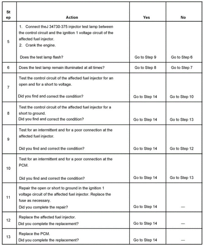

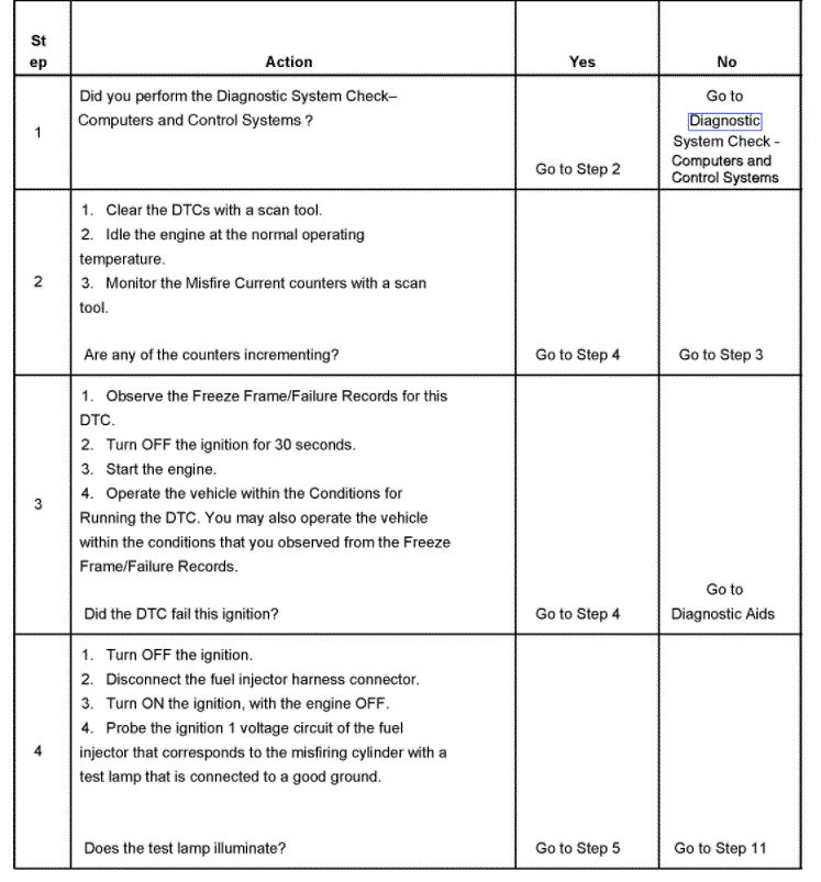

As far as the codes, you likely already know it's cylinder 5. Here is how it works: The control module enables the appropriate fuel injector pulse for each cylinder. Ignition voltage is supplied to the fuel injectors. The control module controls each fuel injector by grounding the control circuit via a solid-state device called a driver. The control module monitors the status of each driver. If the control module detects an incorrect voltage for the commanded state of the driver, a fuel injector control DTC sets. That is the P0200.
Let's try one more test.
Disconnect injector 5 and see if the fuse blows. If it doesn't there is a chance the ignition 1 voltage is shorted at the injector. If it does blow, then the short is before the injector and after the ignition 1 fuse.
If it doesn't blow, probe the ignition 1 power supply to the cylinder 5 injector. With the key on and the engine off, you should have power.
If you do, connect the tester to the control wire (PCM) and the ignition 1 voltage wire. Crank the engine. Does the test light flash?

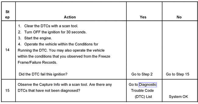

The P200 is related to a variation in voltage to the driver (injector). Something is causing an electrical issue. It could be a wire, corrosion, a faulty injector, a bad PCM, and so on. We are missing something simple.
Take a look through the diagnostics below. I've walked you through some of them already. However, follow them step by step. Also, let me know if the cylinder misfire code came back as well (cylinder 5).
