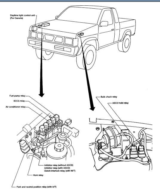

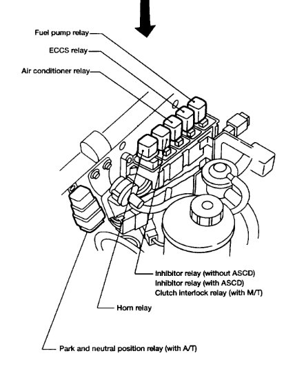

Need to know where is the ECCS relay on this vehicle.

I've attached 2 pictures below showing the ECCS relay you requested.Hope this helps and thanks for using 2CarPros.

Thank you very much sir, sure appreciated it. God bless
