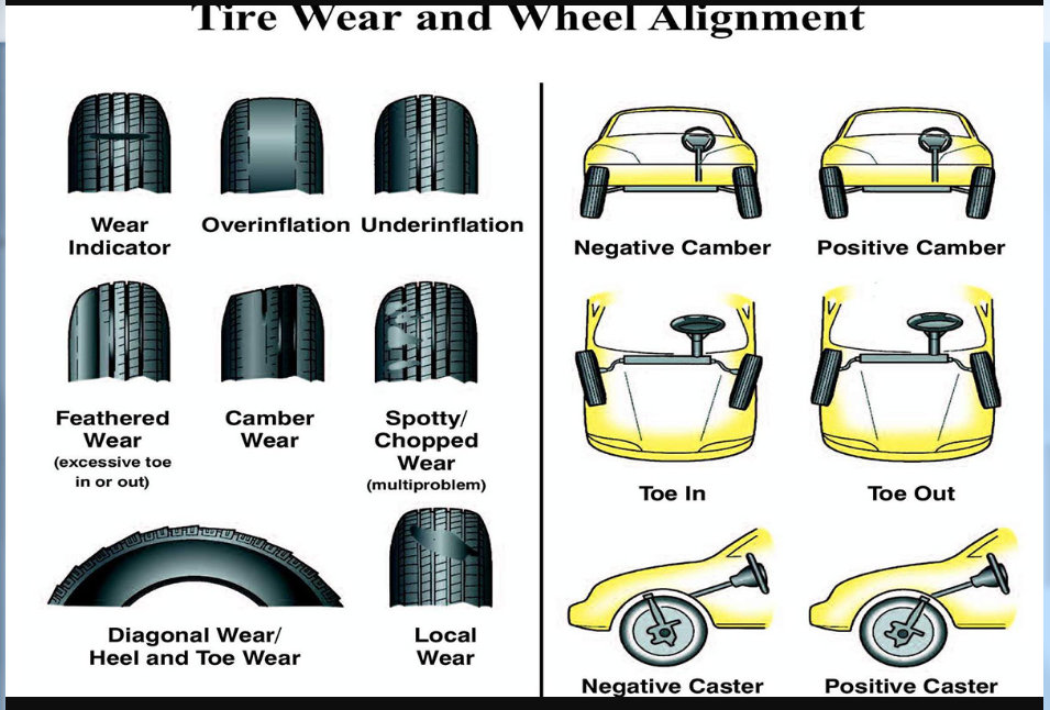

More then likely with this being such a new vehicle with pretty high mileage you most likely hit a couple pot holes and it has knocked the alignment out.
I would suggest rotating the tires and having an alignment performed.
If you see the attachment below you will see that inner tire wear is most likely caused by a toe out situation which is normally caused by a shock to the system which would be a pot hole or something like this.
Let us know what questions you have or what they find with they check the alignment. Thanks
