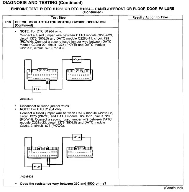

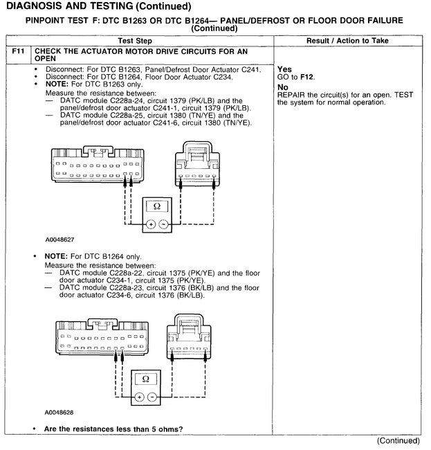

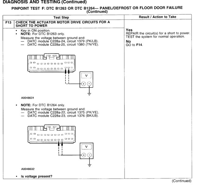

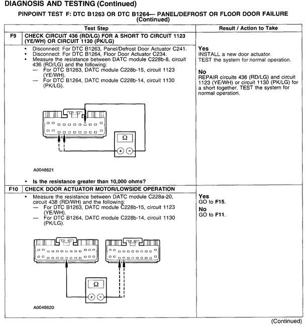

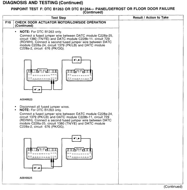

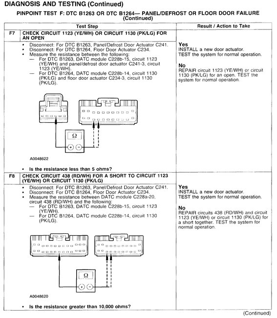

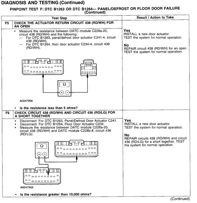

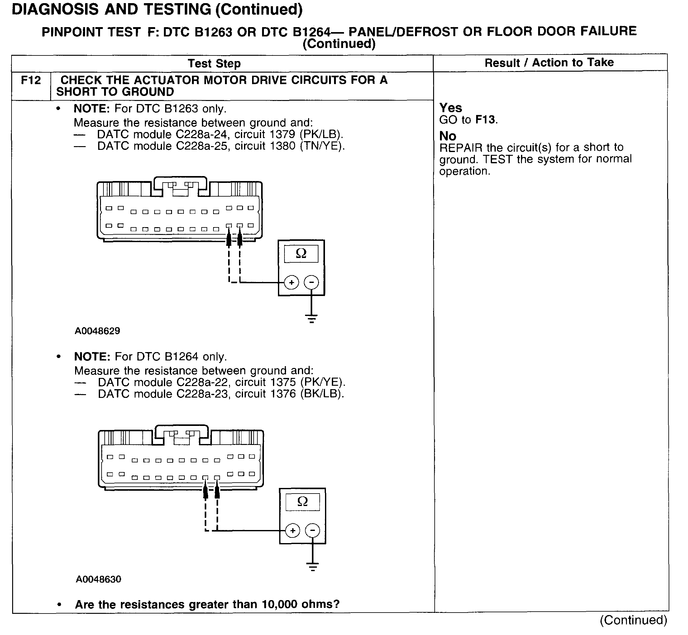

Air conditioner and heater not blowing from correct vents.
self test codes 1259 and 1263.
Nov 14, 2020 at 3:16 AM
  • 110,251 POSTS

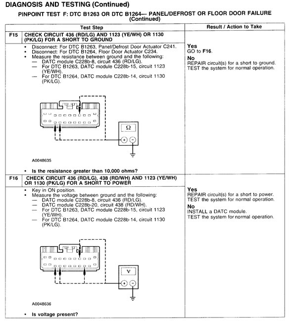

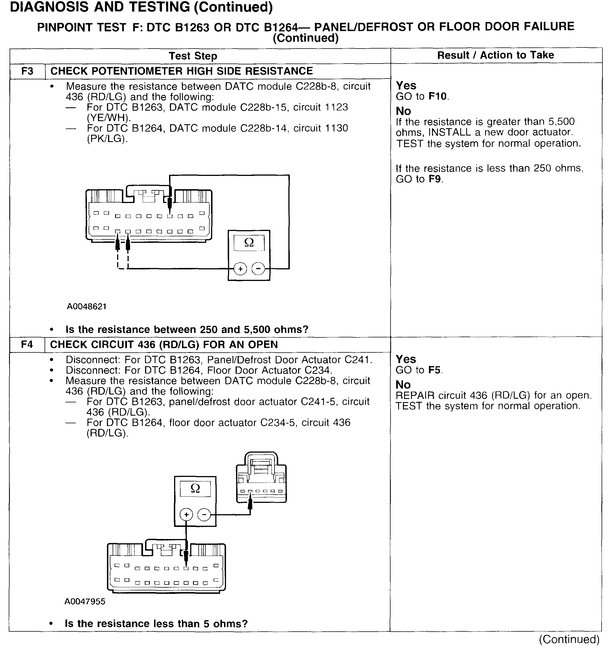

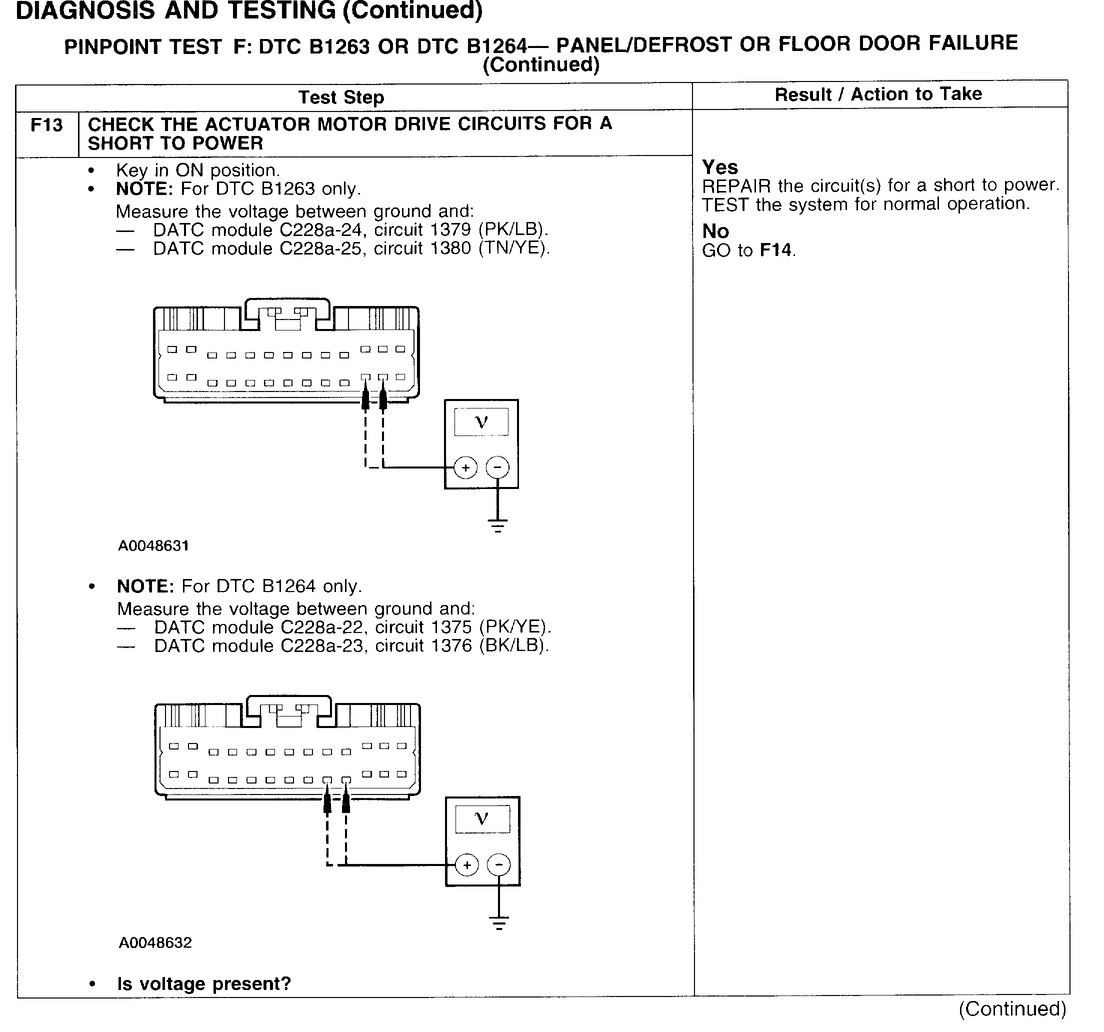

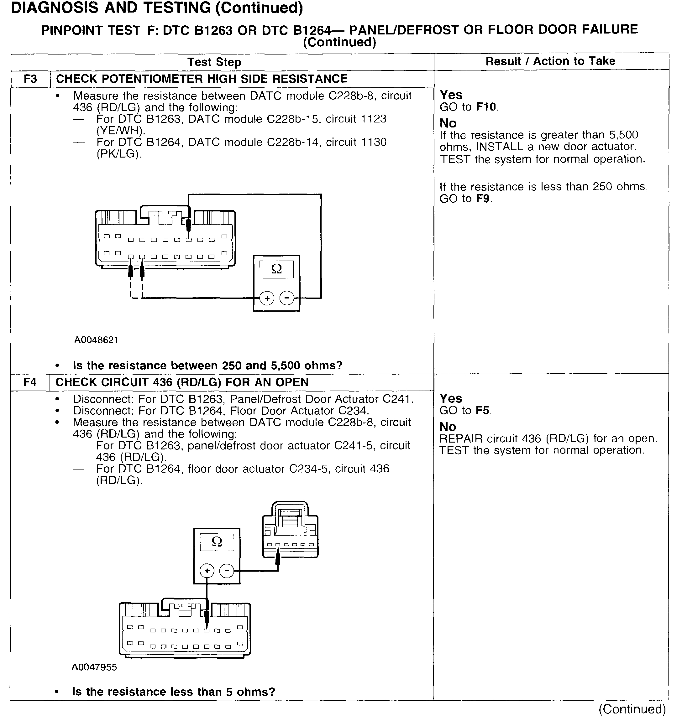

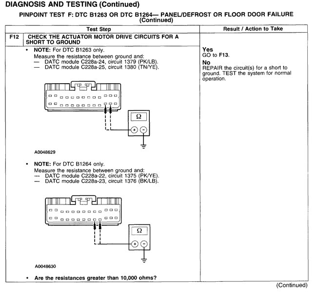

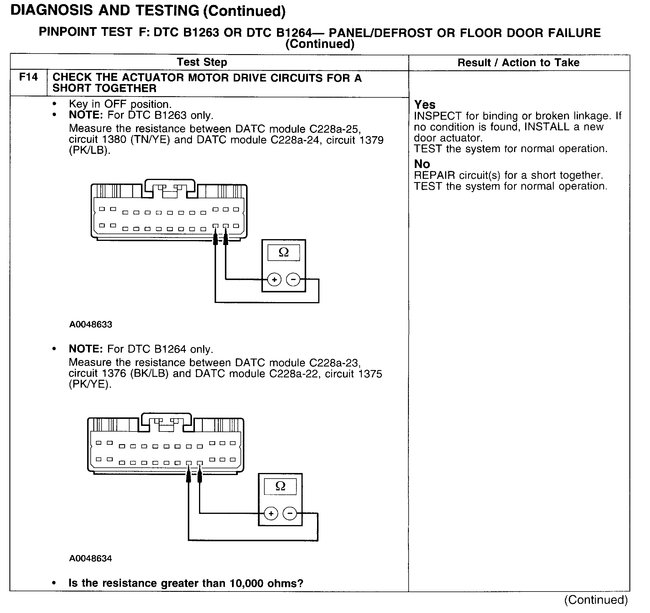

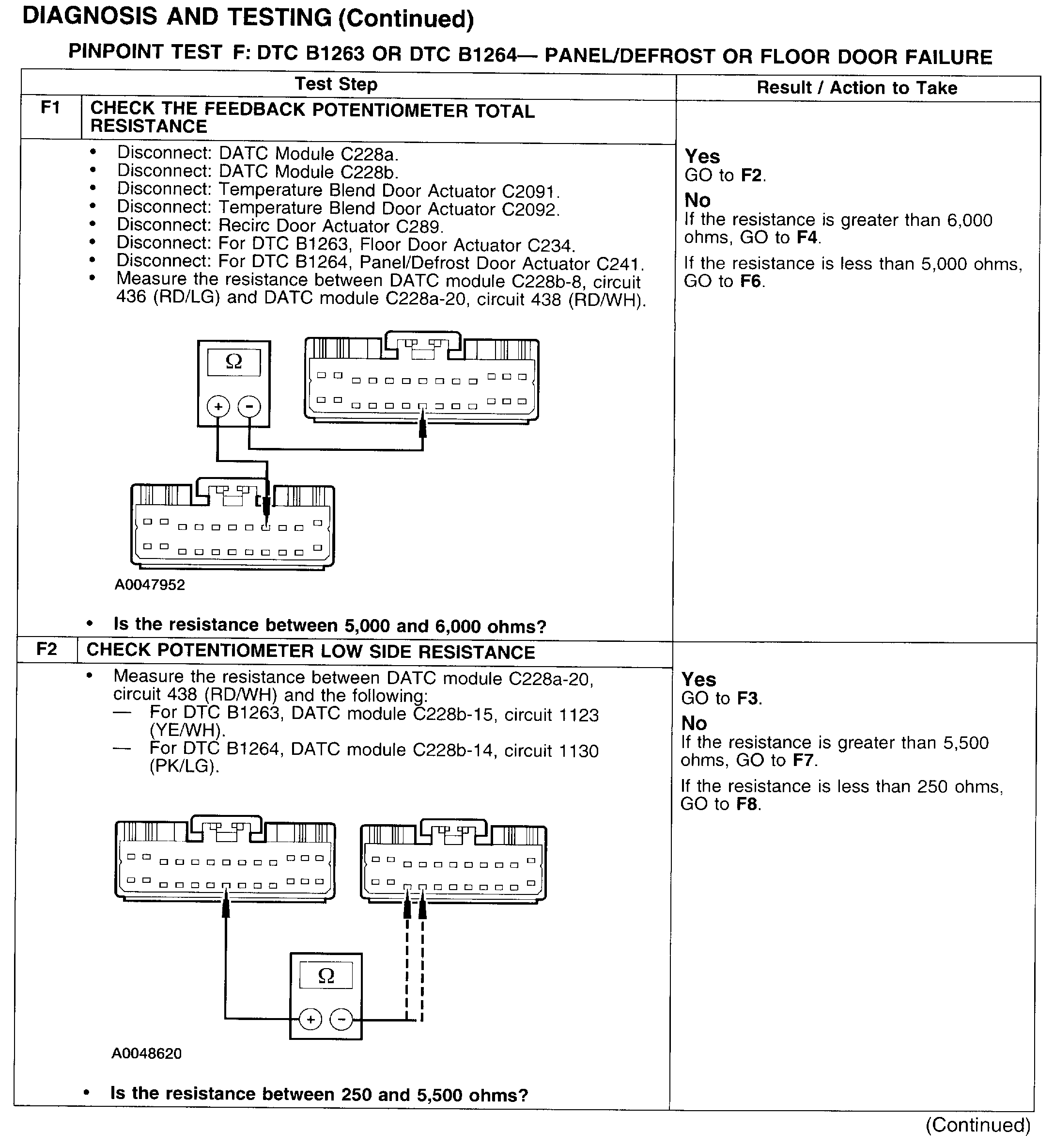

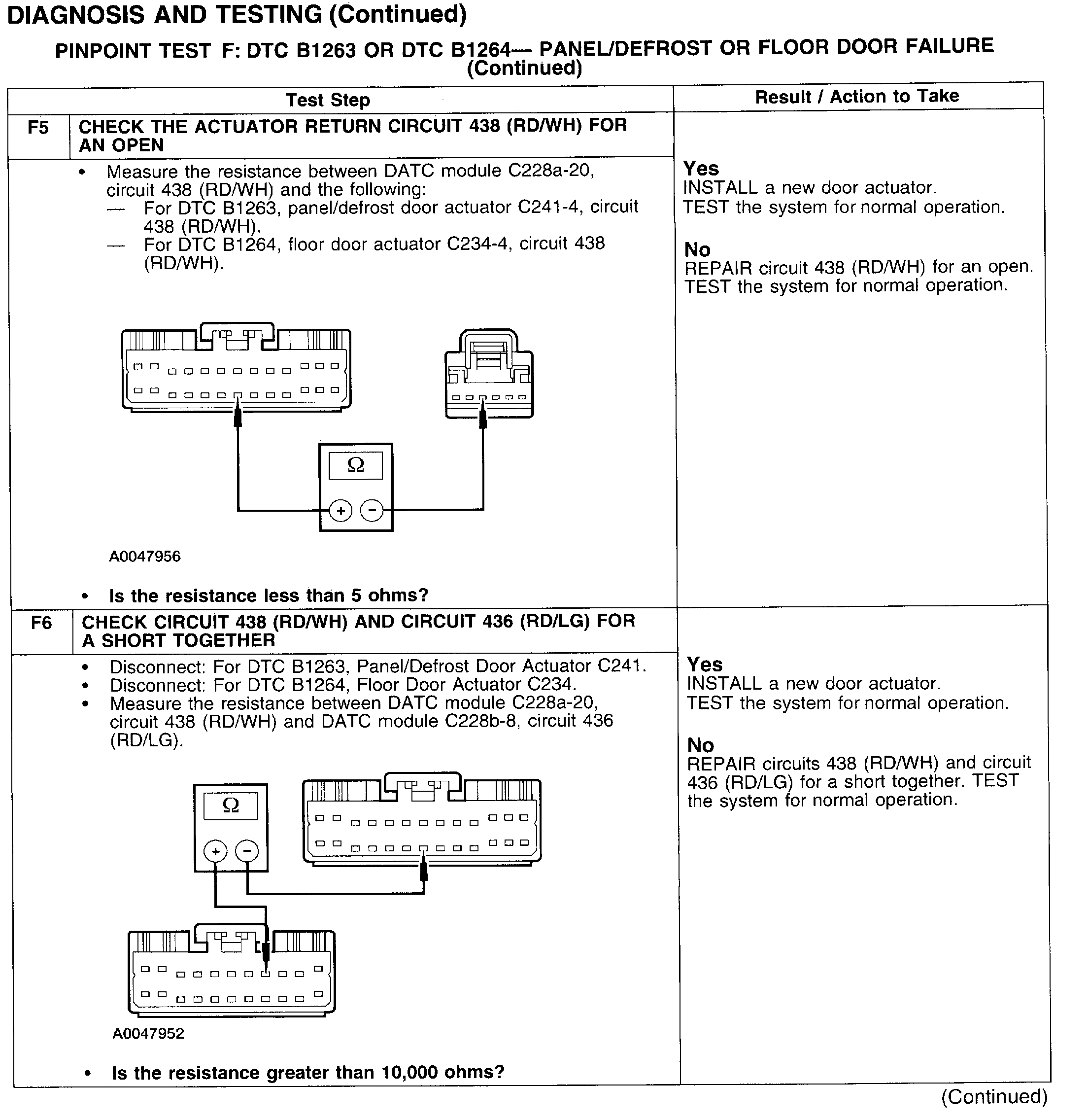

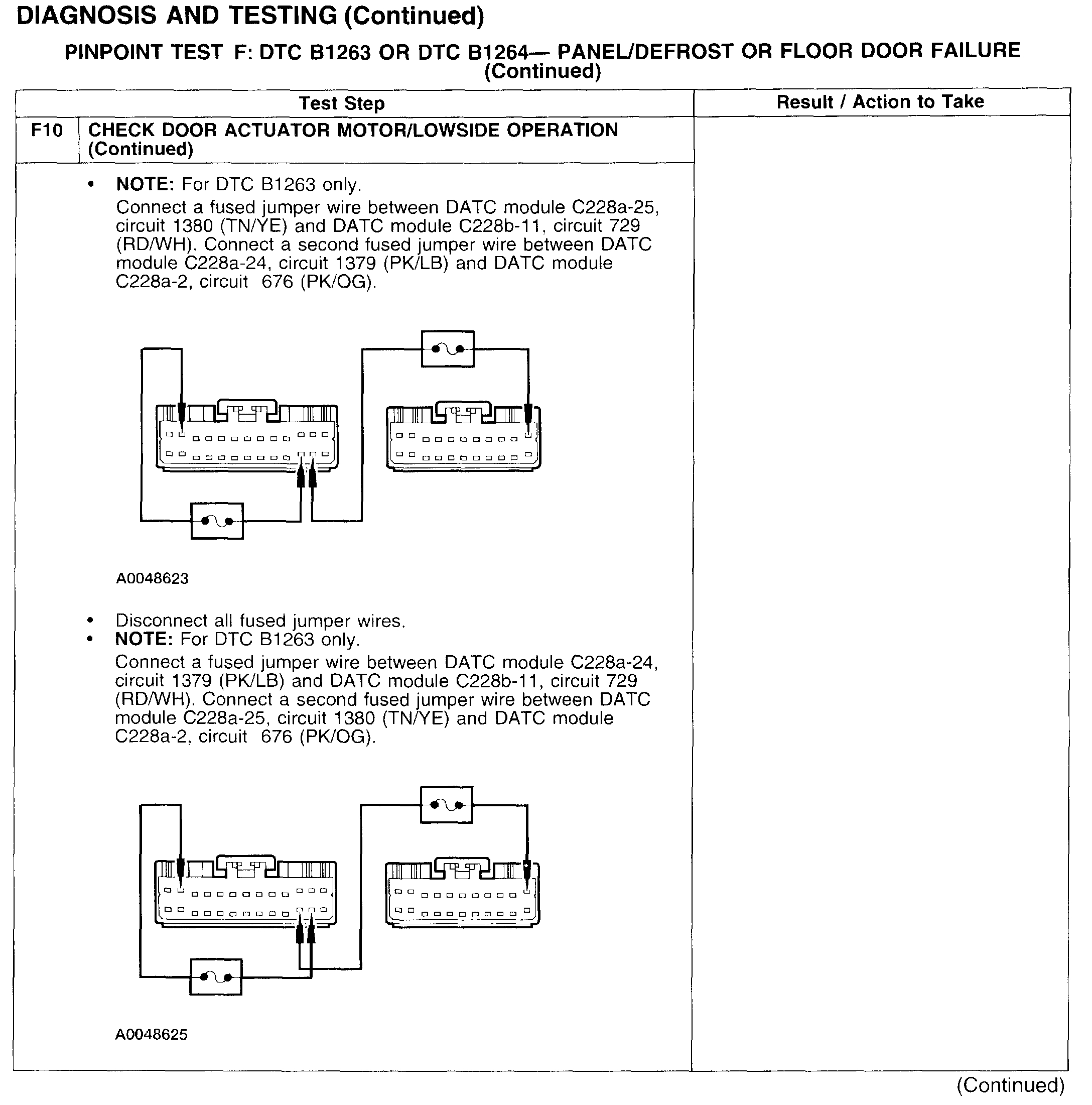

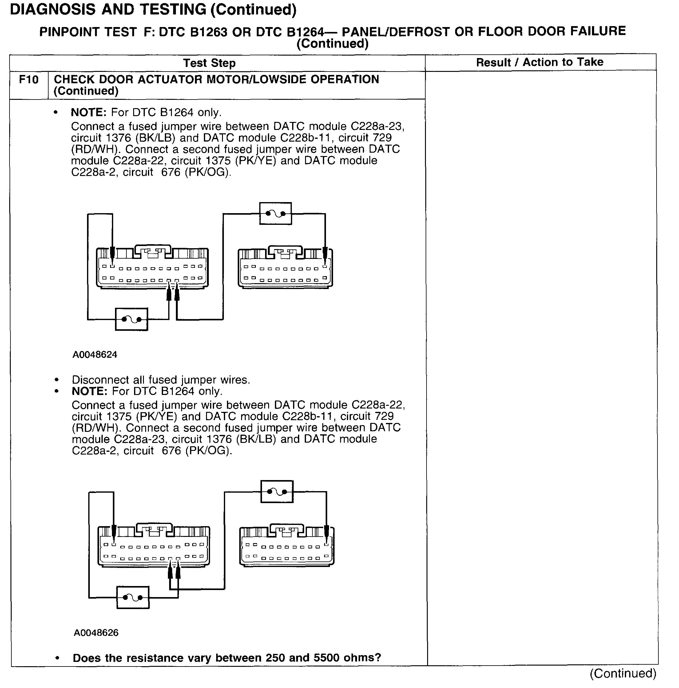

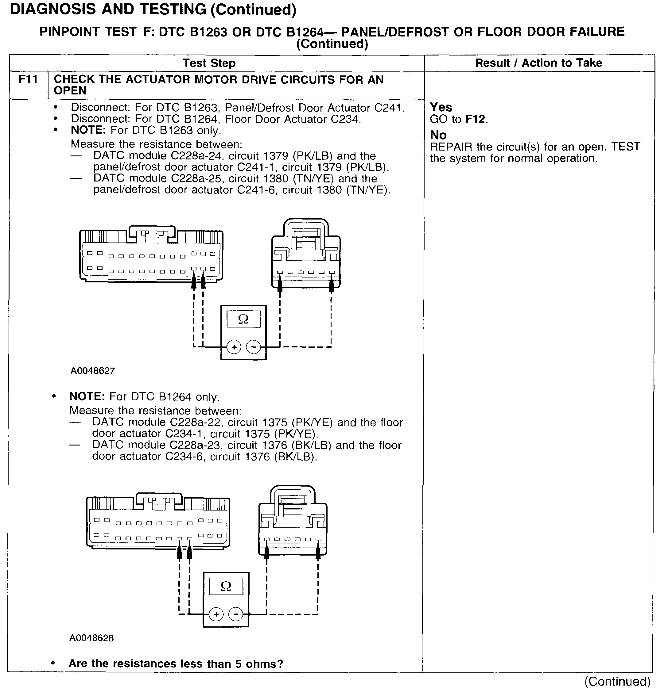

Based on the codes you have, specifically 1263 (which is a B code) B1263, indicates an open circuit to the panel / defrost door. Is that where the problem is happening?
The B1259 is specific to the solar radiation circuit, which wouldn't cause an air flow issue.
If you look at the attached pics, it shows the diagnostics. I'm not sure if you are comfortable following them, but I can help if you need me.

Thanks Joe.
Will I need to remove the dash?
Nov 15, 2020 at 1:24 AM
  • 110,251 POSTS
You are very welcome. In all honesty, that will be based on what is determined by the diagnostics. You may need to remove a few things, but I don't see a reason (at this point) to remove the dash.
Let me know if I can help.

The one connector is behind the controller that you actuate from the vehicle The floor door actuator is a little more difficult. First you need to follow these directions.
2003 Lincoln Town Car V8-4.6L SOHC VIN W
Removal and Installation
Vehicle Heating and Air Conditioning Housing Assembly HVAC Service and Repair Procedures Removal and Installation
REMOVAL AND INSTALLATION
REMOVAL

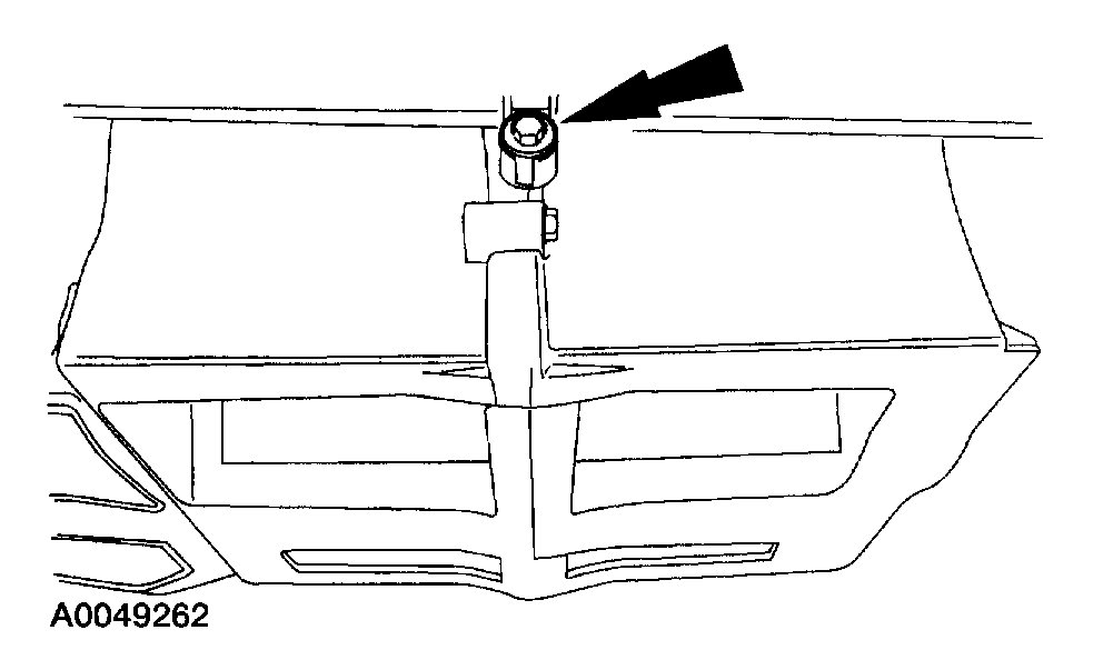

1. Disassemble the instrument panel air distribution ducts.
pic 1

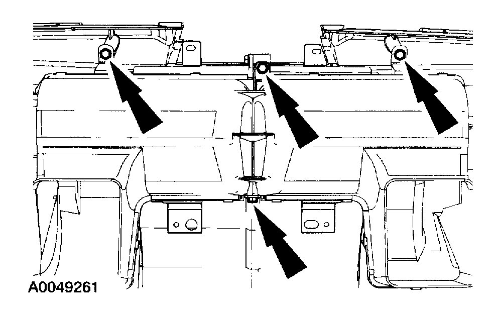

2. Remove the screws and remove the center instrument panel duct.
pic 2
3. Remove the screw and remove the defroster duct.
INSTALLATION
1. To install, reverse the removal procedure.
______________________

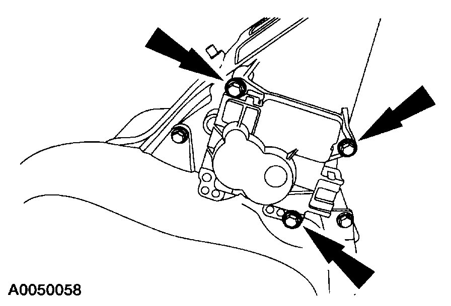

Floor Door
Vehicle Heating and Air Conditioning Air Door Actuator / Motor Service and Repair Procedures Blend Door Actuator Floor Door
FLOOR DOOR
REMOVAL
1. Remove the plenum chamber.
pic 3
2. Remove the screws and the floor door mode door actuator.
INSTALLATION
___________________
Let me know if that helps.
