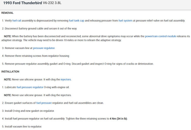

What is the easiest way to get to a fuel regulator?

I was just wanting to know what the easiest way to get to a fuel regulator.

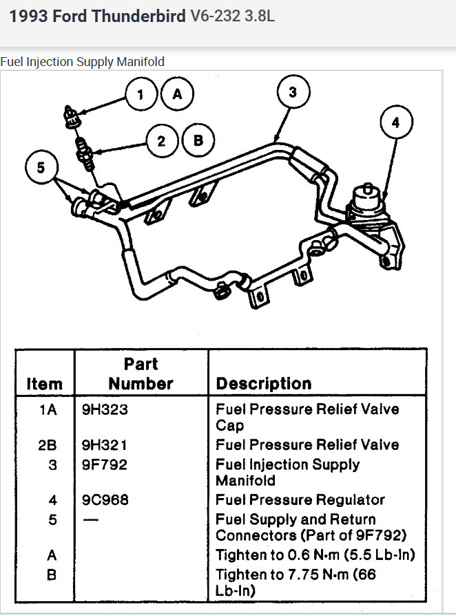

The fuel pressure regulator is on the fuel rail under the hood on the engine. Here are the instructions on how to remove it and its location as well. Check out the images (below). Let us know if you need anything else.
