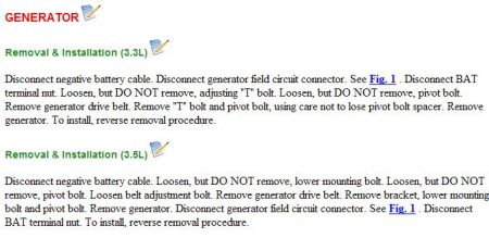

How to change the alternator any pictures would be helpful thanks
Jun 26, 2009 at 8:12 PM
BLUELIGHTNIN6
  • 16,542 POSTS
https://images.2carpros.com/forum/automotive_pictures/261618_Noname_592.jpg

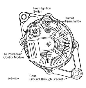

FIGURE 1
https://images.2carpros.com/forum/automotive_pictures/261618_Graphic_57.jpg
