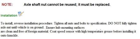

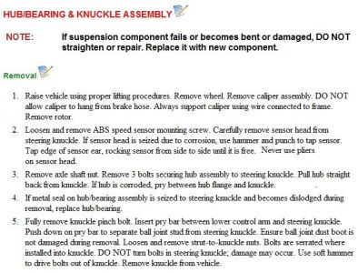

How difficult is it to replace front bearings
Mar 20, 2010 at 9:05 AM
BLUELIGHTNIN6
Experienced Mechanic
16,542 POSTS
the front wheel bearing is integral with the hub assembly, the entire assembly must be replaced as a unit. follow steps below
