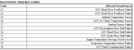

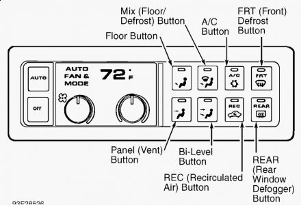

SELF-DIAGNOSTIC SYSTEM Entering Self-Diagnostics 1. Set A/C-heater control panel to display degrees Fahrenheit. Start engine (vehicle not moving) and set temperature control to 75 °F. To enter self-diagnostic mode, press and hold floor, mix, and defrost buttons simultaneously. See Fig. 1 . When ATC panel display begins to blink, release all 3 buttons. 2. The display will continue to blink until it completes its tests and calibrations. Any diagnostic trouble codes stored in BCM that are related to ATC will be displayed when blinking stops. If there are no trouble codes, system will return to normal operation. 3. Trouble codes will appear on display in numerical form. Only one number will be displayed at a time. Press panel (vent) button to scroll through any additional trouble codes. See DIAGNOSTIC TROUBLE CODES table for list of codes. Exiting Self-Diagnostics & Clearing Codes To exit self-diagnostics, turn ignition off. To clear codes, disconnect negative battery cable for at least 10 minutes.
