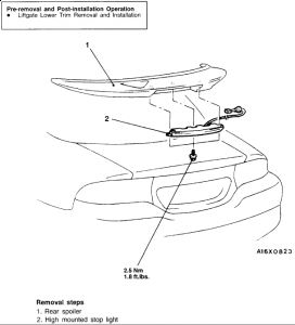

Is the brake light in the middle a light itself or is it a small bulb in there that needs to be replaced

Hi richmondsister, welcome to 2carpros and TY for the donation
There's a bulb in the brake assembly:
Center Mounted Brake Lamp Bulb
High Mounted Stop Lamp P/N -MS820022 $2.75 Notes Contact dealer for most current part and price information.
Notes
High Mounted Stop Light - Removal And Installation
https://www.2carpros.com/forum/automotive_pictures/12900_brake_13.jpg
Pre-Removal
Liftgate lower trim.
REMOVE
Rear spoiler
High mounted stop light
INSTALL
Rear spoiler
Post-Installation
