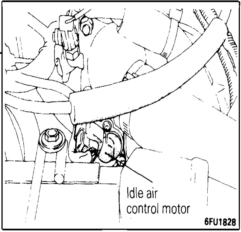

It sounds like a piece of dirt has made the IAC valve get stuck, here is how to replace it in the images below and i have included this guide to help you as well.
https://www.2carpros.com/articles/engine-idles-too-high
