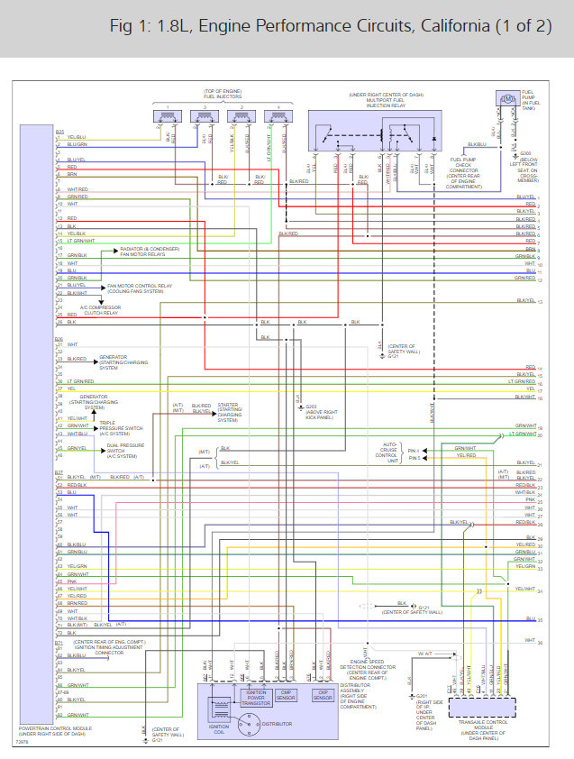

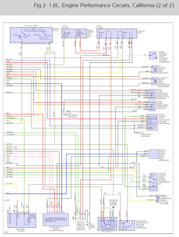

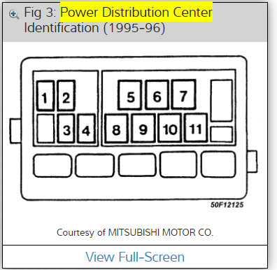

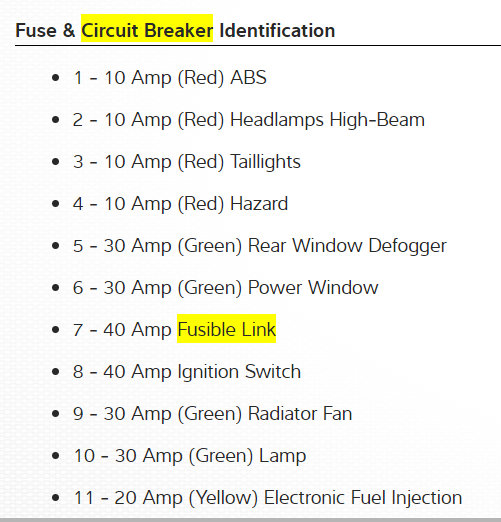

It sounds like you have an injector relay that is out here is a test to help you confirm the failure.
It #11 in the engine fuse panel here are engine wiring diagrams and the fuse and relay locations so you can get the problem fixed.
