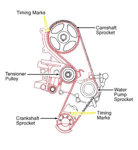

I am looking for some info on the timing belt marks. I can't seem to find the marks to line up the pulleys. Pictures would be helpful.

What do you have for engine size ?

2.4 litre

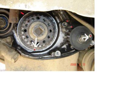

I put the new belt on and she runs good but when the engine strains she has no power. Can I move the distributor around to put her on timing? Or do the belt have to come off and realign the gears again?
Apr 13, 2008 at 2:31 AM
DARRYLTHENEWF
  • 16 POSTS
https://images.2carpros.com/forum/automotive_pictures/178088_DSC03700_1.jpg
With the top pulley on the timing mark. This is where the 2 bottom marks are. I can't see any marks on the engine to align these 2 gears.

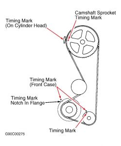

https://images.2carpros.com/forum/automotive_pictures/99387_summit_1.jpg
timing marks

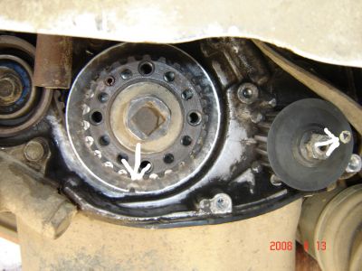

https://images.2carpros.com/forum/automotive_pictures/99387_1_1.jpg
