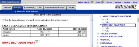

WHAT IS THE VALVE CLEARANCE FOR EAGLE SUMMIT WHEN READJUSTING?

https://images.2carpros.com/forum/automotive_pictures/12900_valve_3.jpg
