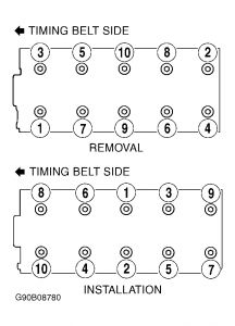

WHAT IS THE TIGHTENING SEQUENCE FOR THE EAGLE SUMMIT CYLINDER HEAD AND TORQUE?
Jun 8, 2010 at 10:55 AM
BLUELIGHTNIN6
  • 16,542 POSTS
cylinder head bolts torque in 2 - 3 stages, finishing with 53 Ft. Lbs . follow sequence below
https://images.2carpros.com/forum/automotive_pictures/261618_Graphic_562.jpg
