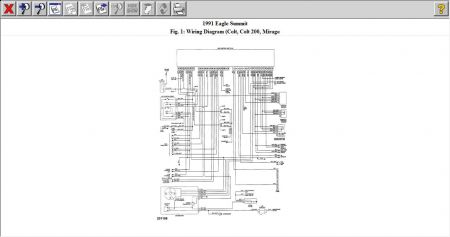

1991 Eagle Summit no spark
1991 EAGLE SUMMIT
155,000 MILES • 4 CYL • FWD • MANUAL
KDJOHME
  • 7 POSTS
changed distributor ignition module and cap and rotor (complete distributor) spark plugs .
also fuel filter .
ran great then stopped running awhile driving .
cranks easy no spark .
mark old dist. with ink , placed new one same alignment .
is there a cumputer chip ? timing belt / chain ?
what direction should i go next ?[img:49db5c17df]http://www.2carpros.com/forum/automotive_pictures/383782_1991_eagle_summit_15L_engine_001_1.jpg[/img:49db5c17df]

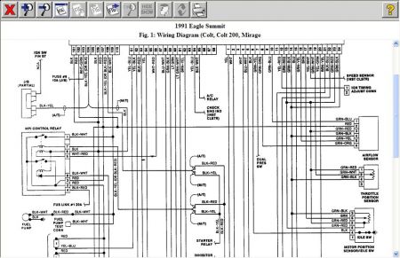

At the coil positive terminal do you have battery voltage on the black and white wire and the black wire if not check the ignition switch and the MPI control relay.
Jul 17, 2009 at 10:39 AM
KDJOHME
  • 7 POSTS
with key on , i check voltage at the wire tremital with 6 wires bottom of distrubutor . the black has 0 the blk/wht has 12 volts . none when key is off .
don't know what a MPI crontrol relay is ? ignition swicth ?
how much do you want to walk me thur this ?
the yellow wire had some caseing damage some bare wires show. nothing burnt .
Jul 24, 2009 at 5:50 AM
  • 75,992 POSTS

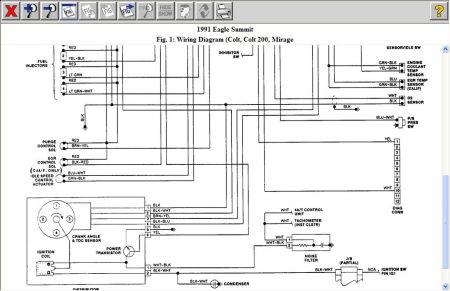

Turn key on check for power on the 2 wire connector at the coil-black and white wire power there and still no spark test the crank and TDC sensor-No power its coming from the ignition switch.

https://images.2carpros.com/forum/automotive_pictures/12900_ewd_4.jpg

Do you have code 22? scan the computer for codes and if any comeback with it, The crank angle sensor is in the distributor
